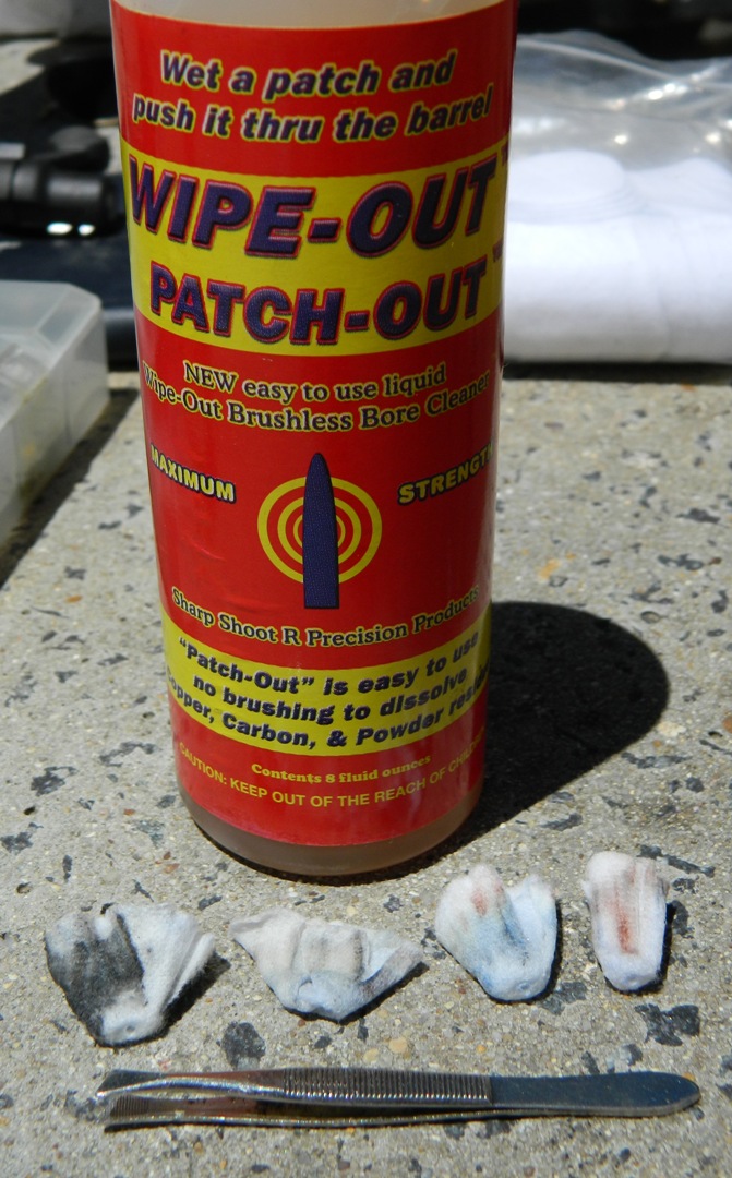

Gaznazdiak, I've stopped using all other bore solvents, since I started using Wipe-Out, Patch-Out solvent (just the standard liquid version), several years ago.
I'm very happy with the way it works, on Powder, Carbon and Copper fouling.
You can see the Powder fouling (black colour), Copper fouling (Blue colour) and Carbon fouling (Brown colour), on these patches.
I used to import it, direct from http://www.sinclairintl.com but not sure if you can still do this?
Hope that helps
