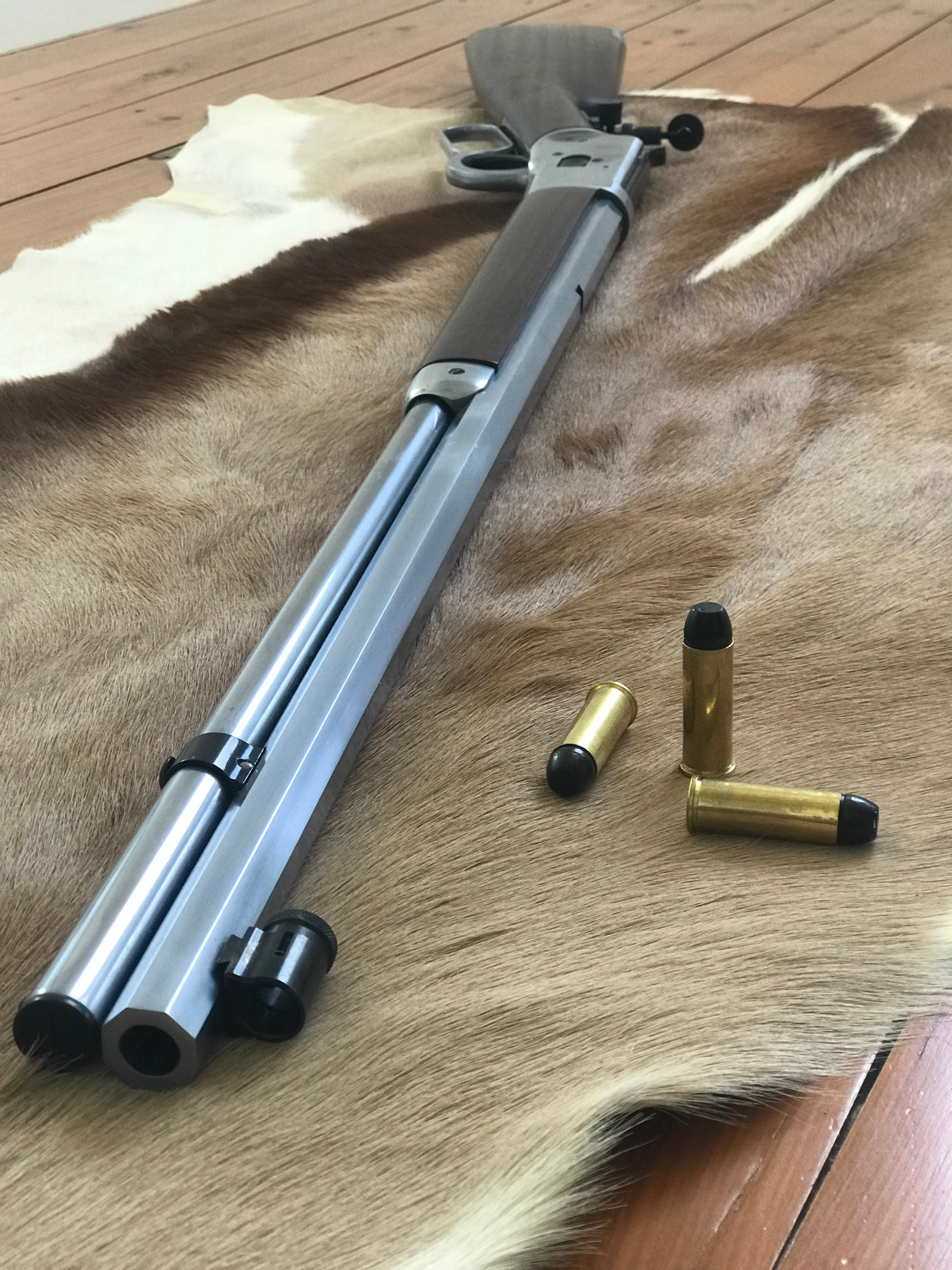

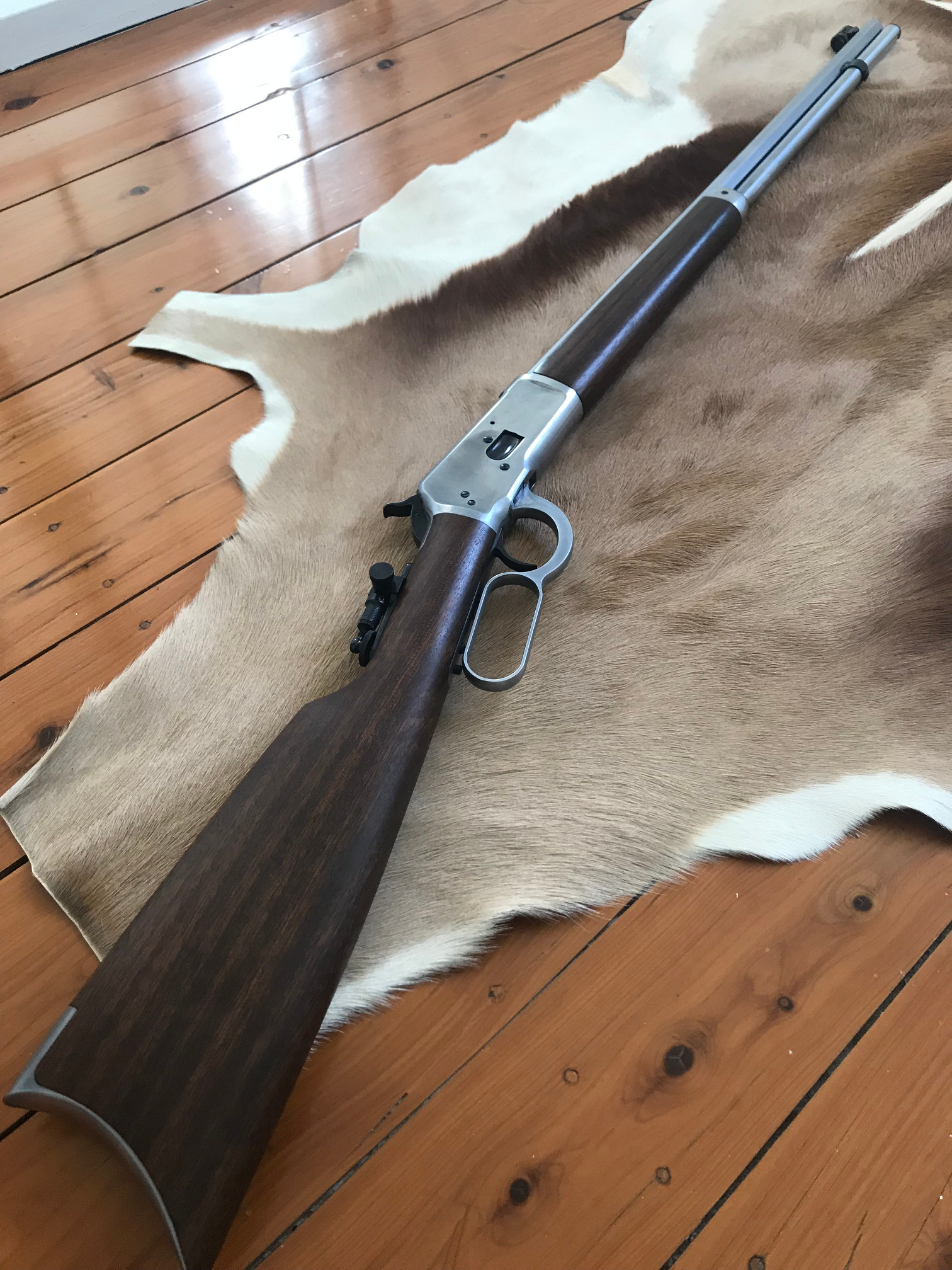

... with a Marbles tang and an Lyman (interchangeable) front sight. TBH it took some time to get this build together; it's hopefully destined for PC-CLAS at Bowral Although I have some load development to do before then; hopefully she shoots straight :?
One thing I noticed is the Winchester 1892 action is considerably more complex than my (modern) Marlins; I see now why history paved it's way toward simpler actions.

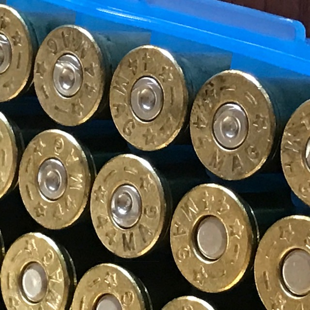

Another thing, the primers are consistently bulging on one side:
Is this normal?
But I've done some reading and I think this is normal for the 92 action; the extractor is the lower part of the bolt face; I read that it depresses back and the softer pistol primer extrudes back a little each shot. If anyone could confirm or contradict this It'd be appreciated.
