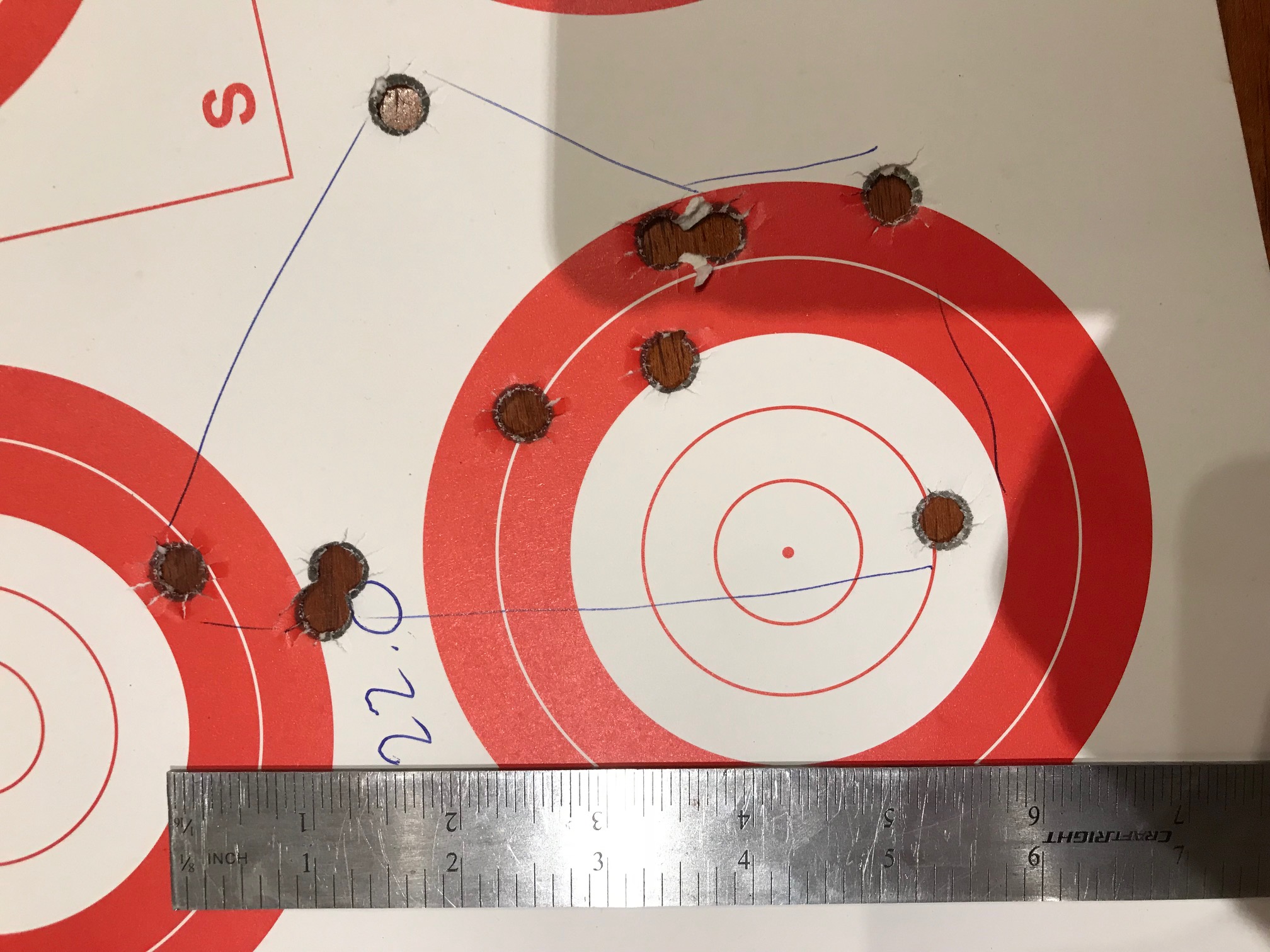

Hey peeps,
New to the whole pistol cartridge world I'm starting to work up loads for the latest (stainless 24") Chiappa 1892 action. Projectiles are a hard-cast 240gn, RNFP slightly oversized to .430". Groups shot at a distance of 50m over AR2205 (with tang + front globe). 10 shot groups without much of a breather between groups, so admittedly barrel got pretty hot.
20gn 2205 @ 50m
20.5gn 2205 @ 50m
21.5gn 2205 @ 50m
22gn 2205 @ 50m
I'm kinda aiming for in-the-realm of 1" - 1.5" @50m (which these are clearly not!). Does anyone agree these groups are sub-par? Are my expectations a bit unrealistic?
Cheers,
In2.
21gn 2205 @ 50m

mate if ya shootin' groups like that fast with the standard buck horn sights ya doin' ok . i did the same sort of test at 50 rapid fire with my mod '94 30-30 with williams peeps with a large apperature and grouped around the same. looks like pig killin' shots every time. you could play with peep sights or ,scope it and get tighter groups. kinda depends on your definition of a lever gun. for me, it's a light weight, quick to point, close range scrub gun. :thumbsup: :drinks:

I want to use it for PC-CLAS - that's why I'm chasing accuracy. For example my scores are measurably better when I use my moa lithy vs my mate's 2moa martini - so I'm presuming the same ideals ultimately translate across to CLAS. It's funny you know; i chased accuracy with my marlin 30/30 in a time past, and I kinda came to the conclusion that the 30/30 was pretty "inaccurate". But now shooting this rifle I'm feeling as thought the 30/30 ain't so bad after all...

in2anity wrote:Hey peeps,
Cheers,
In2.
I think you're asking two questions, potential accuracy of the cartridge, and of the rifle. A .44 Magnum bolt-action rifle could shoot significantly better than a lever. For load development I prefer to fit a scope to minimise shooter input.
My .44 is a Marlin '94 with Microgroove bore, which is problematical shooting cast bullets.
With jacketed bullets and a scope I've managed 40mm groups off a rest at 50m.
With hardcast .432" 232gn bullets I'm seeing about double that, scoped off a rest.
With Williams FP-336-TK peep sight, the 180gn jacketed HP XTP's are good, but still around 100mm at 50m rested.
With cast bullets around 120mm is possible, rested peep sight.
If you can shoot any non-competition rifle into 1.5" at 50m with iron sights you're doing pretty well. To do so with a short fat bullet out of a lever-action rifle I'd be very impressed indeed.
I think your groups are pretty decent myself.
The Uberti '66 .38 Special I've got down to 50mm groups at 50m, rested with Williams FP-336-TK peep, but with Berry's copper plated 125gn bullet. Hardcast is still very poor, around 150mm groups at 50m rested with a few different bullets. Frustratingly hopeless practicing on half-scale silhouettes still.

in2anity wrote:I want to use it for PC-CLAS - that's why I'm chasing accuracy. For example my scores are measurably better when I use my moa lithy vs my mate's 2moa martini - so I'm presuming the same ideals ultimately translate across to CLAS. It's funny you know; i chased accuracy with my marlin 30/30 in a time past, and I kinda came to the conclusion that the 30/30 was pretty "inaccurate". But now shooting this rifle I'm feeling as thought the 30/30 ain't so bad after all...
I'm in the same boat :-)
If I were only pig shooting I'd be happy with it, but those silhouettes are tiny targets compared to pigs.
If we can use jacketed bullets in CLAS then I'll run those for the significantly better accuracy. If we can't then I'll have to run Berry's plated bullets. And if we can't use them either, I'll just throw rocks :-)
The .38 Special is out-shooting the .44 Mag, but it has no knock-down energy for silhouette. It hits the half-scale targets pretty bloody hard, but I can't see it reliably dropping the full-scale ram at 200m. If I can do some testing and find that it is suitable, I won't bother with the .44 Mag.

Post by in2anity » 09 Apr 2018, 8:09 am
bigrich wrote:well in2anity. if your looking at competing in lever class you need a top notch set of peeps. got talking to a fella at the range that was really into CLAS shooting, had a '94 with a williams FP rear, and i think a lyman front sight with a very fine pin. reckons he could get 2" at 100 with it. was a 30-30. biggest problem of lever guns is snub nosed projectiles for the tube mags. BR has put up a lot of good advice to take on board. besides all that, practice ,practice,practice. :thumbsup:
sadly I have put rather fancy sights on her already bigrich - I got a Marbles Tang and a Lyman 17AHB, and it has about 26 inches of sight radius, so inaccuracies are not stemming from that side of the equation :(

This is some really useful info BR - thanks. I take it my groups are in the realm of somewhat "normal". I might actually try some jacketed loads to see what the rifle is capable of - any suggestions? 180gn HP XTPs good are they?

You seem to know a thing or two about the 44 groundhog - what do think of those groups? A lot of room for improvement?

in2anity wrote:This is some really useful info BR - thanks. I take it my groups are in the realm of somewhat "normal". I might actually try some jacketed loads to see what the rifle is capable of - any suggestions? 180gn HP XTPs good are they?
I have had zero interest in lever rifles all my life, until October last year, so I really can't tell you what is "normal" exactly :-)
But from what I've read, seen and tried myself I think your groups are pretty good.

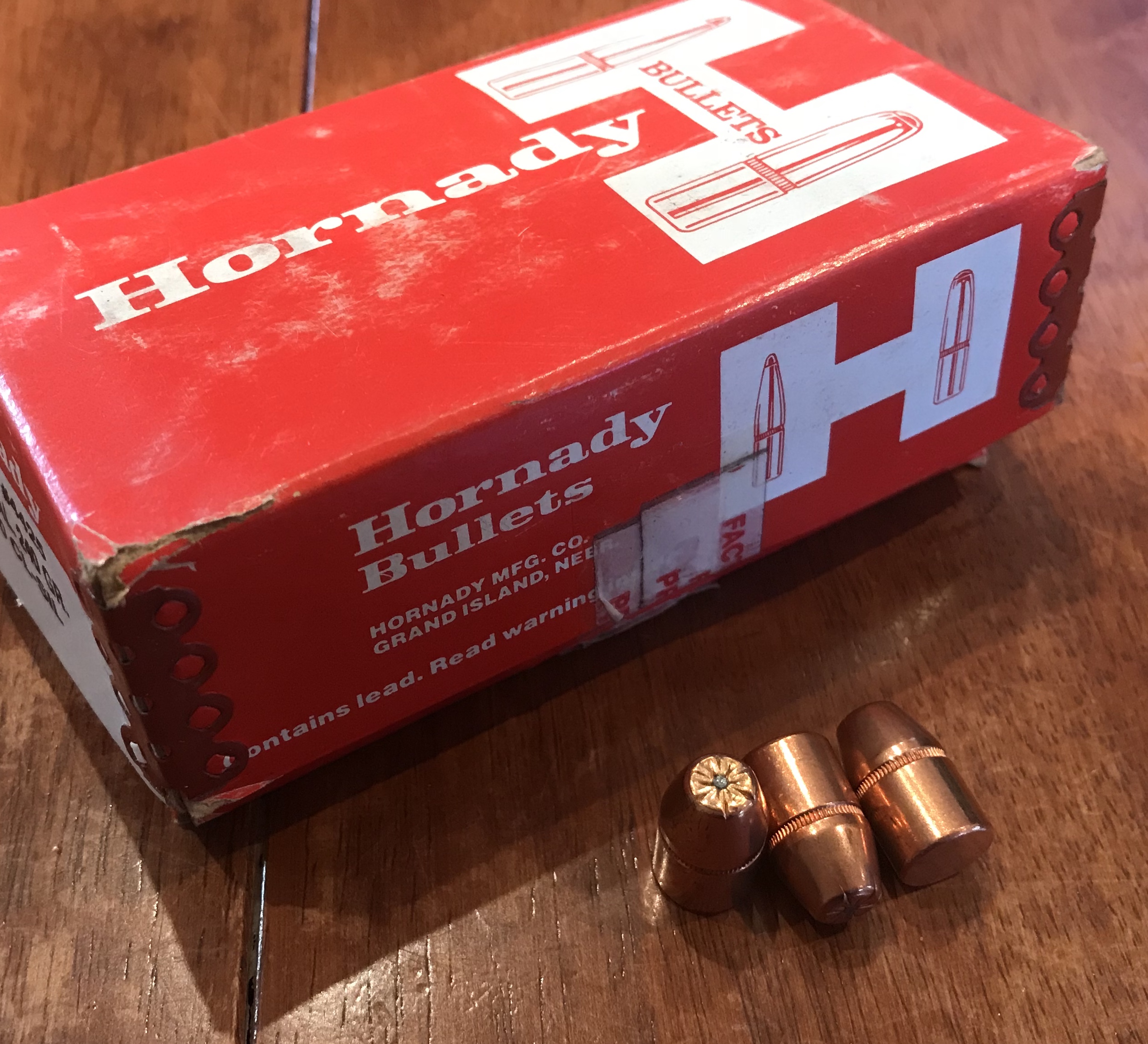

bladeracer wrote:Keep in mind after shooting cast that it'll need a few jacketed bullets down the tube to clean it out before it'll start grouping, so don't give up if the first group is 12" or more :-)
Lol will do - picked up a old box of 240gn fmjs from Western - $30/100, a bargain! It’ll be interesting to see how they shoot vs the lead.
Hornady 240gn fmj
Re: 44mag accuracy expectations?
Post by groundhog » 10 Apr 2018, 11:21 pm
Just watch with the FMJ's as many pistol silhouette ranges will not allow them, have to be a HP or SP projectile.
