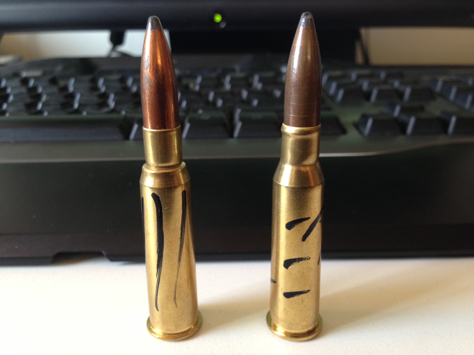

Post by 5Tom » 20 Jan 2014, 5:34 pm
Here's a pic.
The one on the left has the shoulder evenly pushed in a bit and seems to chamber in the 91/30. I didn't lock down the bolt in case something jammed and I spill powder everywhere.
The one on the right is a little different at looks like it either wasn't central when it seated or it got caught on one side. It's a little crooked and felt a bit more resistance attempting to chamber this one. I needed to get my cleaning rod to tap the round out although I pushed this one in by hand and not the bolt.
Normally if this were my .243 I would just discard the cases as I have plenty of cases to spare. The 54r on the other hand, I try to keep every case I can.

Post by Warrigul » 20 Jan 2014, 5:59 pm
5Tom wrote:Using the Lee 3 Die set for the 7.62x54r.
When I seated my Hornady 150gr .312 spitzer projectiles, I don't believe I had this problem and now I'm seating 180gr Sierra .311 Pro hunters.
I didn't remove the seating die from the press, instead I loosened the adjustment knob, put a dummy case with projectile in the die and screwed down until the desired COAL.
I'll have to check to see if the die is touching the case shoulder. Sounds like a probable cause.
cheers
Yep, you are right, going by the pictures you are crimping the case to the projectile way too early so the whole case is being pushed down not just the projectile, otherwise you would have a great big ring mark around the ogive on the projectile.
Unless you specifically want a crimp then screw the seating die almost all the way out and use the centre screw to adjust projectile depth NOT the whole die.

Post by Monty » 20 Jan 2014, 8:07 pm
You definitely have your seating die set much too low.
Refer to Hercl's 6 steps above.
Step 5 is where you're coming undone. You need to make sure you back the die out after screwing it in onto the top of a case.

Post by Bills Shed » 20 Jan 2014, 9:47 pm
Yep the pic tells the story. Seating die too low.

Post by 5Tom » 20 Jan 2014, 10:43 pm
Cheers guys, I made the right adjustments to the seating die so it should be resolved. I'll have to do the same thing with my .243 die as well just to be sure.
About the 2nd case, should a FLS die fix that if I cant fireform it? If neither, it's in the bin.

Yeah, I think you should be ok to salvage the second case.

Update,
Those cases were fireformed back to their original shape without any problems. They did require some force to lock the bolt down, but after firing, the bolt opened up just fine and the cases don't look damaged or split. I'll keep an eye on them during future reloading.
