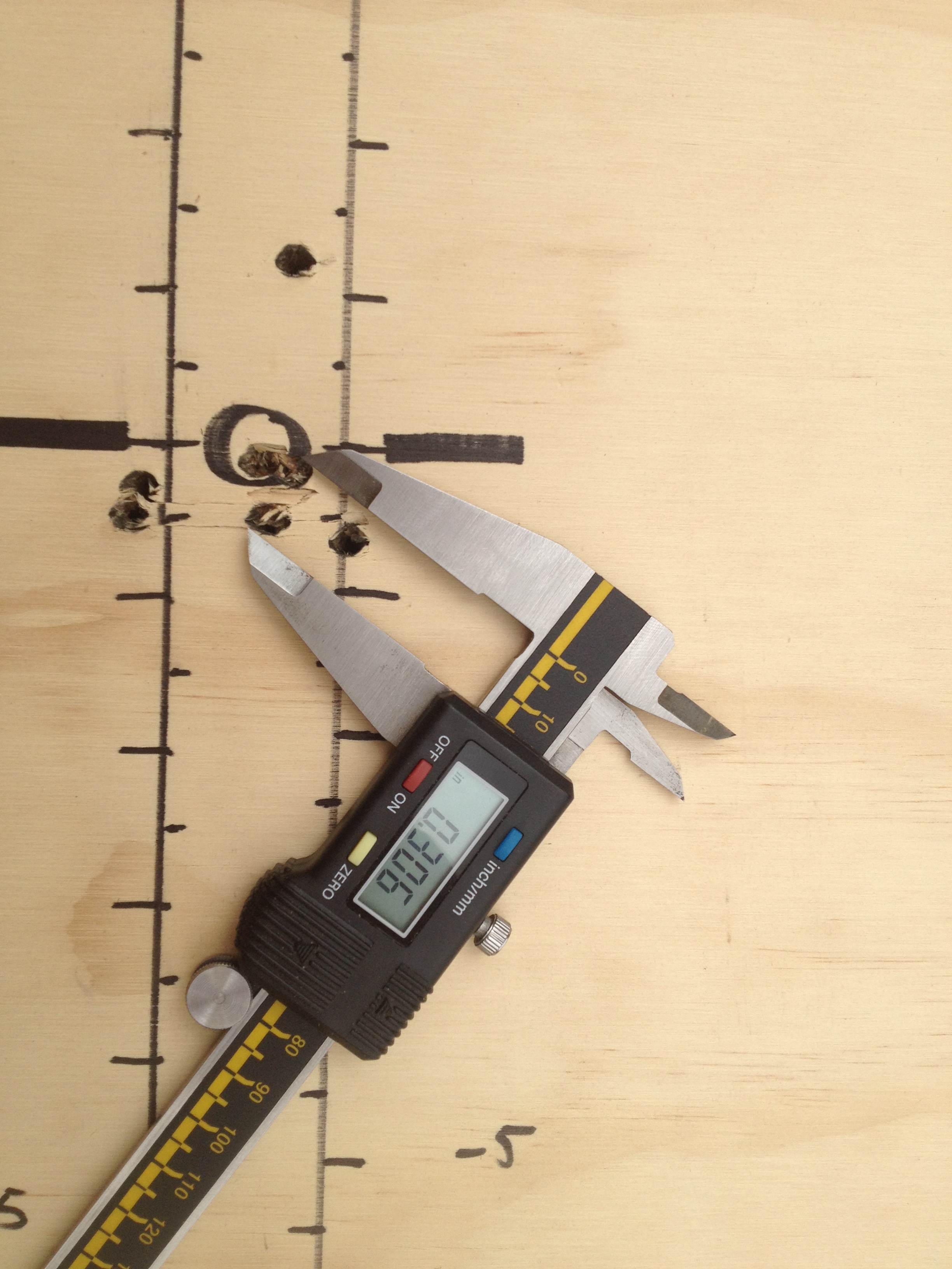

By the way. This load was tested at 100yd and put 3 consecutive shots into roughly 0.3", with one click scope adjustment after the first shot (the lower one) to put the group closer to bull/POA.
Zeroing the load. Shot 1, high, Shot 2&3, left and low, shot 4 one click too far right, shot 5 low and dead on, shot 6&7 dead on, or close enough.
Here's a 5 shot group from 223rem at 100m.
Now, not saying i can shoot like this all the time or that i am any good a picking wind. Also not saying there was not shooter error showing up in the 500yd group, just that you can load some decent ammo with basic gear and that if you can shoot a tight group at 100yd/m, then it not really much harder to do the same at 500; IF the wind plays nicely with you.
