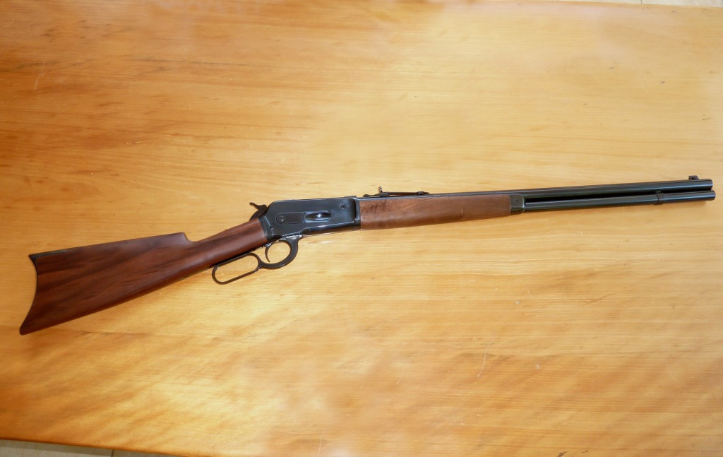

Post by Mango bill » 02 Nov 2016, 2:38 pm
This photo was taken prior to fitting the receiver sight.
It's a big gun to hump around all day so I'm going to have to fit a sling when I can bring myself to drilling a hole in that beautiful stock.
