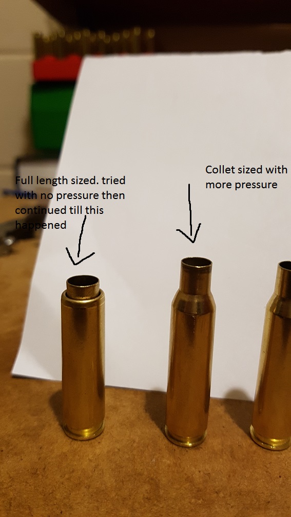

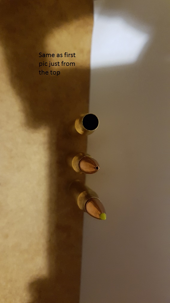

And here is the pics of the rounds and also the damage caused from excessive pushing.
reloading 1.jpg (120.04 KiB) Viewed 7013 times
Realoding 2.jpg (110.25 KiB) Viewed 7013 times
Stuffed cases.jpg (143.12 KiB) Viewed 7013 times
Also like to add that the stuffed collet size brass i didnt have the decapping pin in.

Rounds not feeding with Bolt 1" back, now feeding.. I'm thinking the round did not chamber correctly, perhaps caught on the feed lip but roughly crooked and the bolt locked / wouldn't push it all the way. Don't force them either. Maybe now they will all feed and nothing is wrong.
Last photo, case on the left. I have one of those a mate did in my RCBS Press with Redding Die. He set the die incorrectly, way too low and I believe the neck caught and got pushed into the case. This one by the way does feed in a chamber. Will it blow out...?? I don't know and really I don't think I'd load it up and see what happens. Even though it's a brand new Lapua Case, it's a talking point case at this stage. His mistake, didn't read the instructions. My loss but I kept the case to remind him that mistakes do happen....

EDIT: Looking at the case on the left, the mouth of the neck is a lot larger than the others - too much pressure?

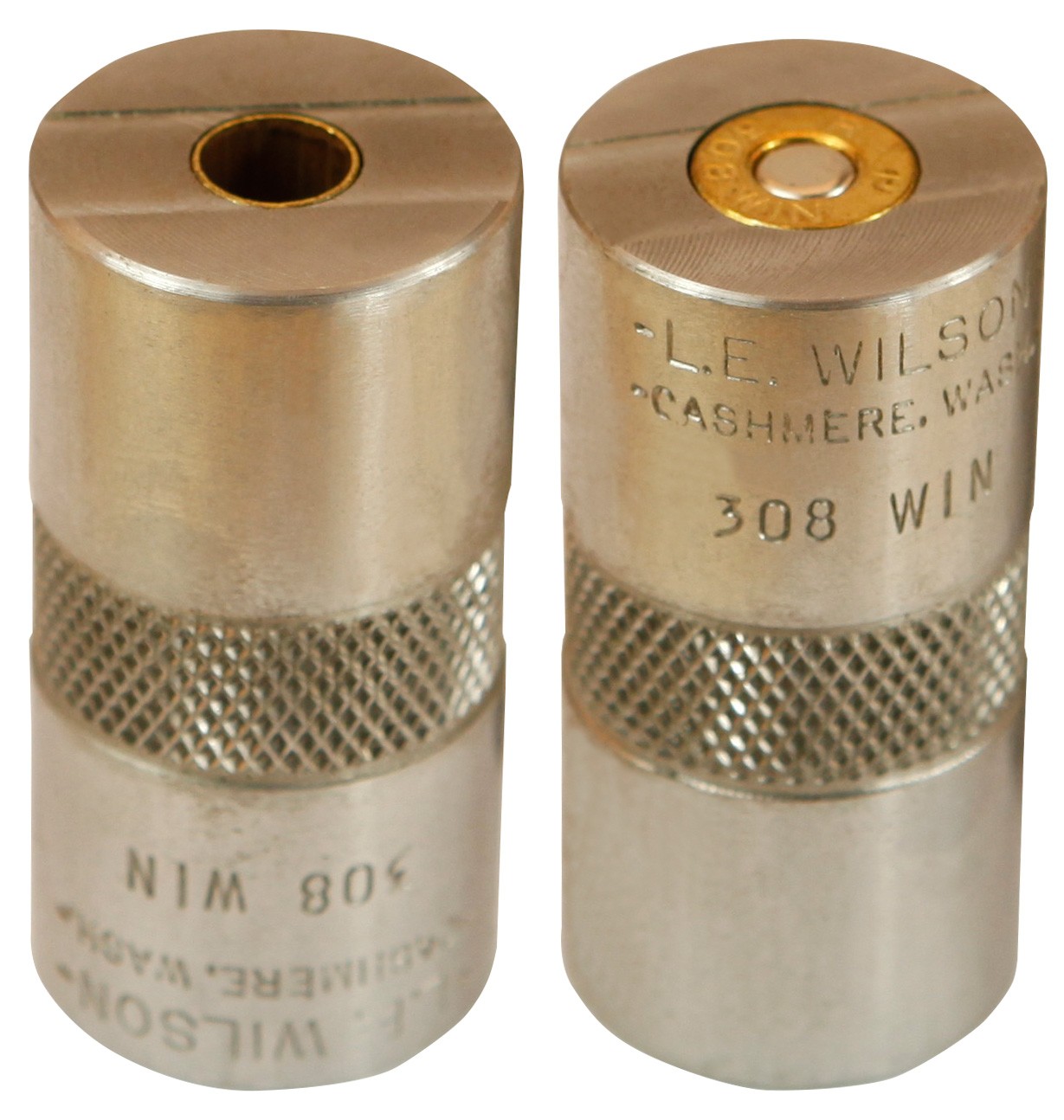

Hi Mongrel (and everybody else :) ), you seem to have your sizing problem resolved for now.
For future reference, I suggest buying one of these in the caliber you're loading for. It's a case gauge, with the correct dimensions for the case. In other words if you've set everything up right, and run the case through, it should drop easily into the gauge and sit inside as it is in the photo.
The other end is important as well, if the neck sits outside the end of the steel, then you should seriously look at trimming your cases. This can be another reason why the bolt won't close, as I found to my annoyance when my AR15 wouldn't go into battery because I as a beginner assumed that my cases were probably ok.
The case gauge is a very fast, easy way to check that your case has been formed properly and will chamber reliably.
I run all my cases through this way and very seldom have anything that won't chamber.
I had one the other day in 9mm, but that was because I obviously had missed it to begin with.
Cheets mate. Looks like an easy and quick way to check.
So far they seem to be ok. Ive fired bout 10 of my reloaded rounds through and no issues so far.
