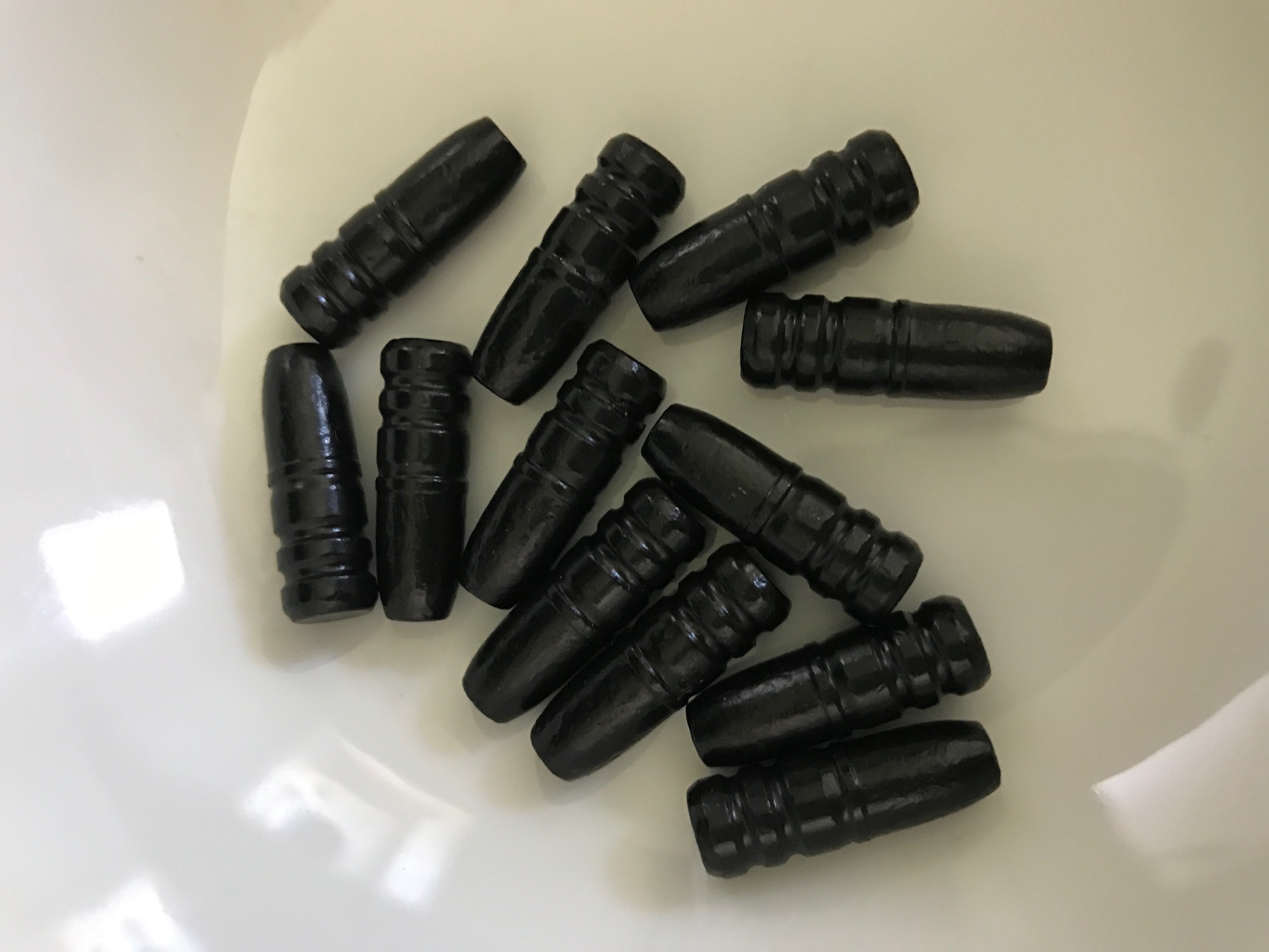

Hey guys, I thought i fill you in on my lubing results:
So a bit of an update on my progress with accurizing my 336W in conjunction with commercial coated hard-cast projectiles. My current batch of projectiles are Westcastings "Black Premiums", which have a BHN of around 16bh. I have about 600 of these left so I need to make them work (hence the motivation).

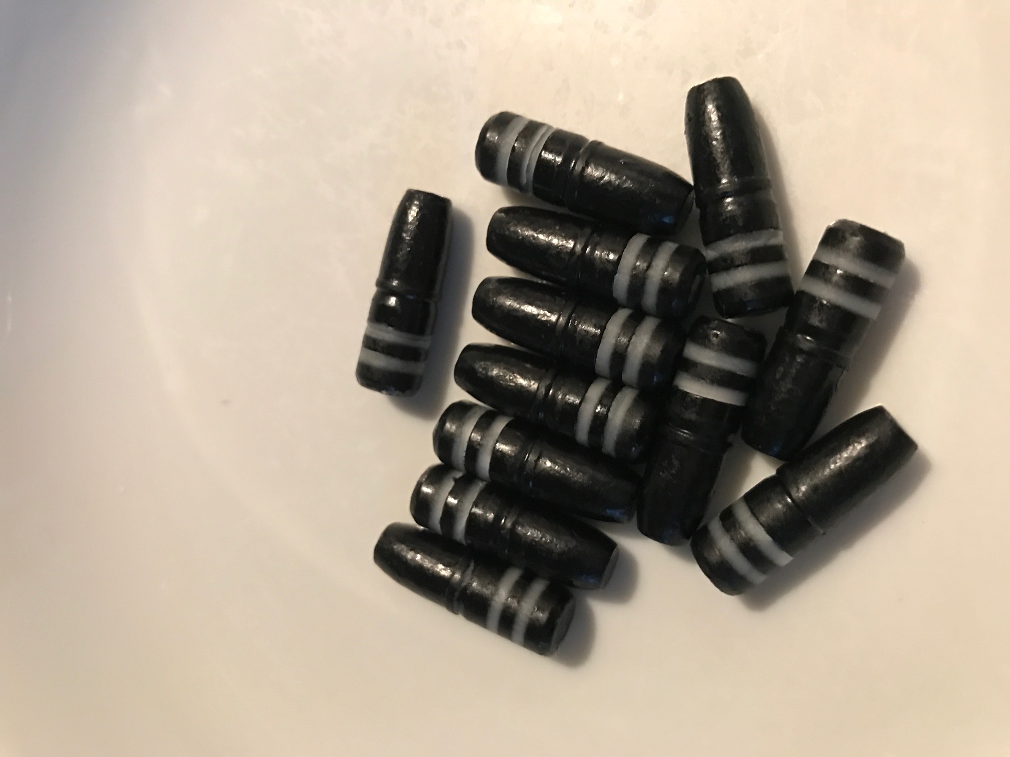

As suggested by Noisydad, I experimented with lubing these (already coated) projectiles; I pan lubed using his formula of:
1 part paraffin wax (candle wax)
1 part pure lard
1/2 part beeswax
Before:
After:
Finished:

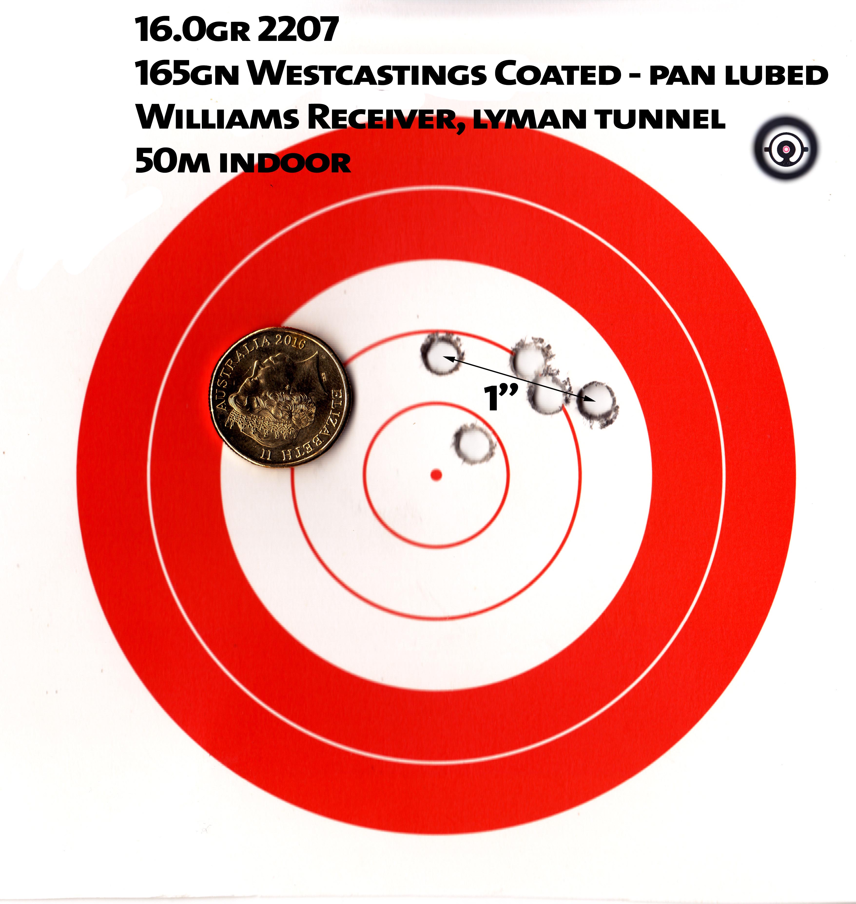

2207
I haven't tried 2207 for some years now, so I thought it would be a good opportunity to go back and revisit it. And WOW what a huge improvement! Looking back at my data, 2207 has performed well for me in the past (with Topscore projectiles to be precise), I'm not sure why I recently neglected it TBH. It seems very sensetive to the load though. 16.0gr 2207 seems the sweet spot, 17.0gr blows out.
Off-the-bat I knew it wanted to group, a three shot group was sitting at 1.5moa:
But I like to report 5 shot groups, and anoyingly that last shot took it from 1.5moa to 2.0moa:
I could well of pulled that lost shot though TBH (after all, I was using iron sights), so there's the distinct possibility the groups could indeed be sub 2.0moa...

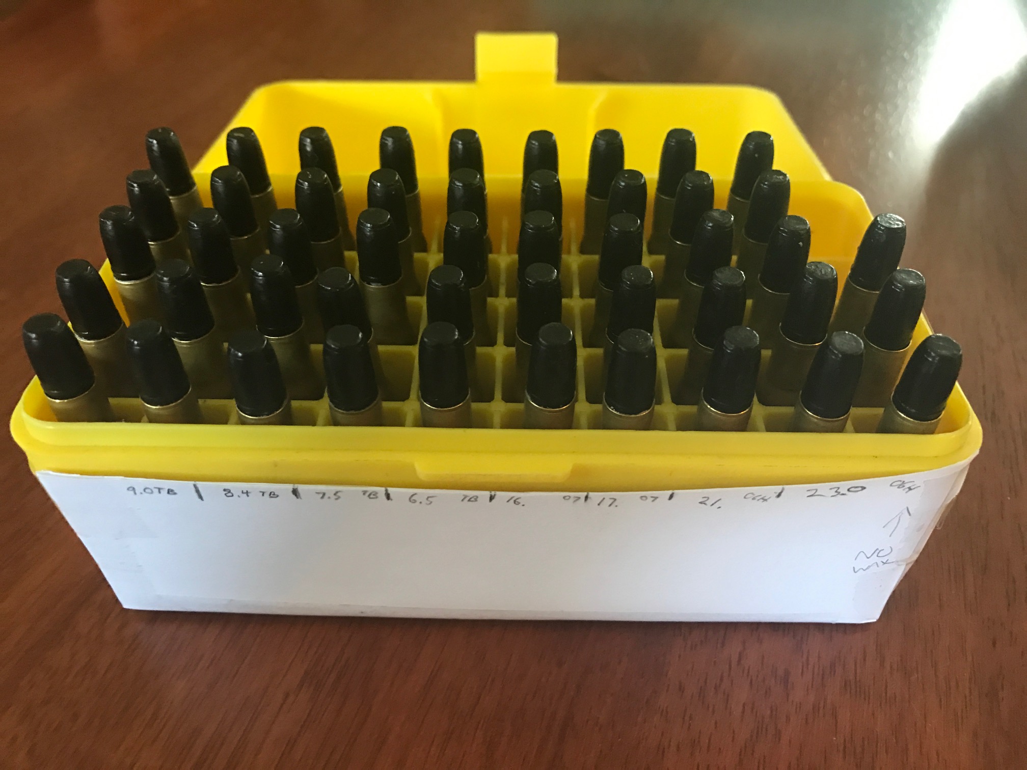

Lubing VS Non-Lubing Update
Results are in for lubricated vs non-lubricated coated, hard-cast, retail-bought "Wescastings Black Premium" lead projectiles. The difference between the two wasn't as profound as I expected, however I feel they are still measurable. I'm ignoring the real outliers (which may or may not be shooter error) in both samples in a attempt to determine the average accuracy of both. There were 2moa 5 shot groups in both, but layering them all together like this I feel shows the truly average accuracy of the two samples.
I now feel an average accuracy of 2moa is indeed achievable in my rem-lin 336W using AR2207 and retail-bought, pan-lubricated, hard-cast coated lead projectiles, something I've been trying to achieve for literally years now :D You be the judge!
