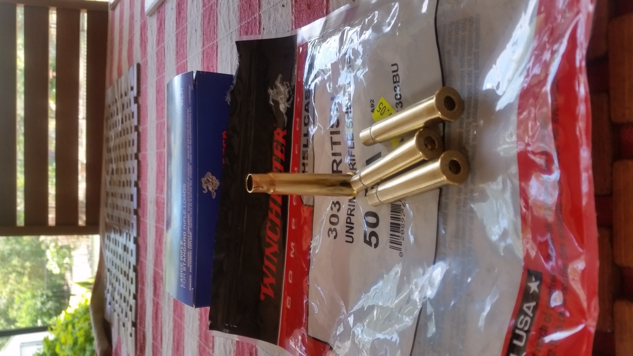

Posted about this last week only diffrence is mine was 303 worst brass i have ever seen. Dont weigh the stuff you'll freak out alot more. Winchester never agin my first time buying will be my last stick to hornady or PPU. It has seriously made me question their other products also.
One cracked others wouldnt hold primers
