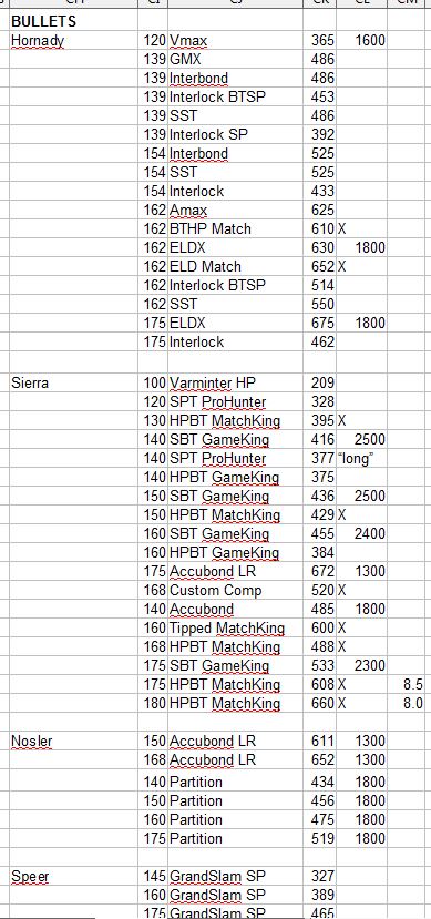

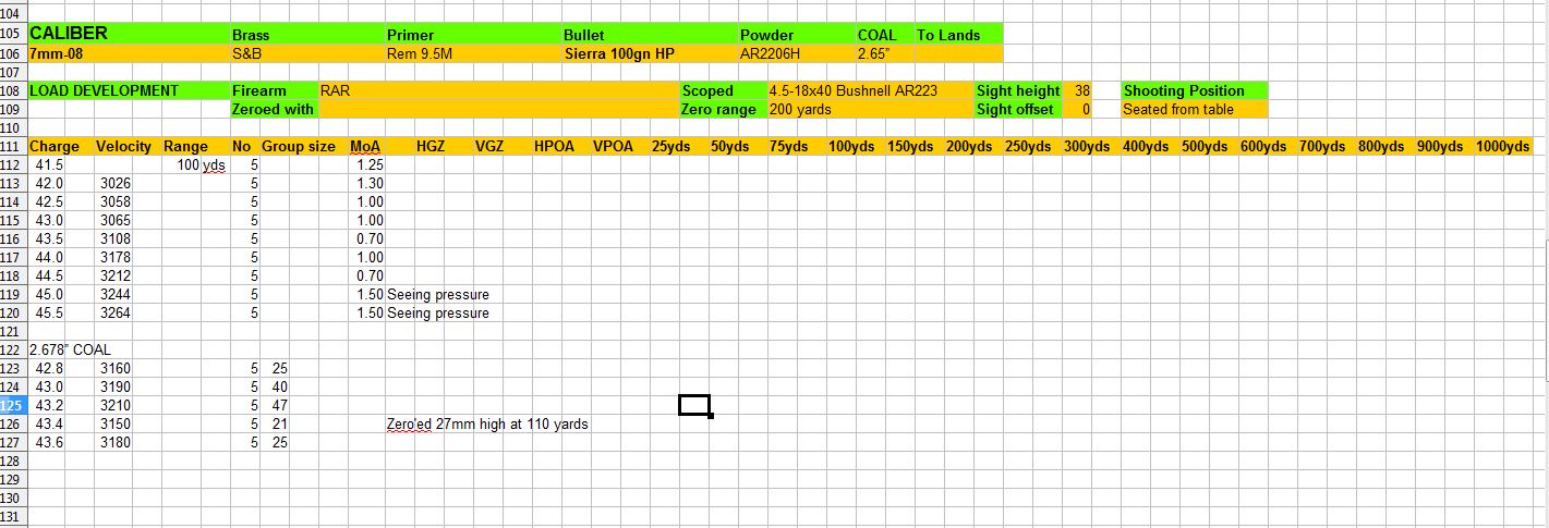

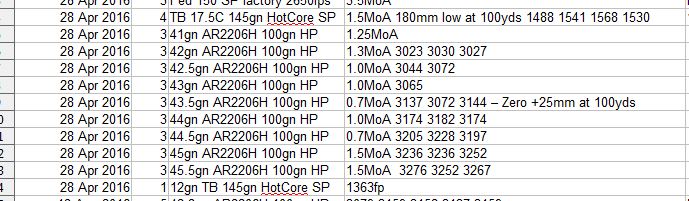

I generally use spreadsheets to track load data and track shots fired in each firearm.
I also research every bullet that is available in that caliber and record BC, minimum velocity and minimum twist rate.
And I measure maximum COAL with each bullet type I'm using.
Load Record.JPG (154.62 KiB) Viewed 8062 times
Shot log.JPG (62.64 KiB) Viewed 8062 times

Once I get a load I'm happy with for the cal, I just write it on the Ammo Case the loads are stored in.
