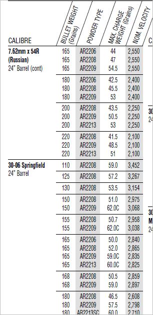

Here is a snap shot from the 2000 ADI manual. AR2206 gets a mention. If you want the full manual PM your email address.
2000 manual 3006.JPG (55.95 KiB) Viewed 9190 times

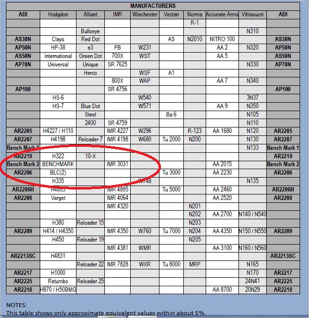

Below is the ADI powder chart for 2003. Note that AR2206 is NOT the equivalent to IMR 3031. AR2206 is a little slower.
ADI Powder chart equil 2004.JPG (176.3 KiB) Viewed 9188 times

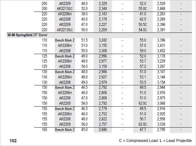

AR2206 sits between Benchmark 2 and AR2206H according to the chart. Here is some data from the 2004 ADI manual. Should load fine with some careful testing.
ADI 2004 data.JPG (68.9 KiB) Viewed 9186 times
