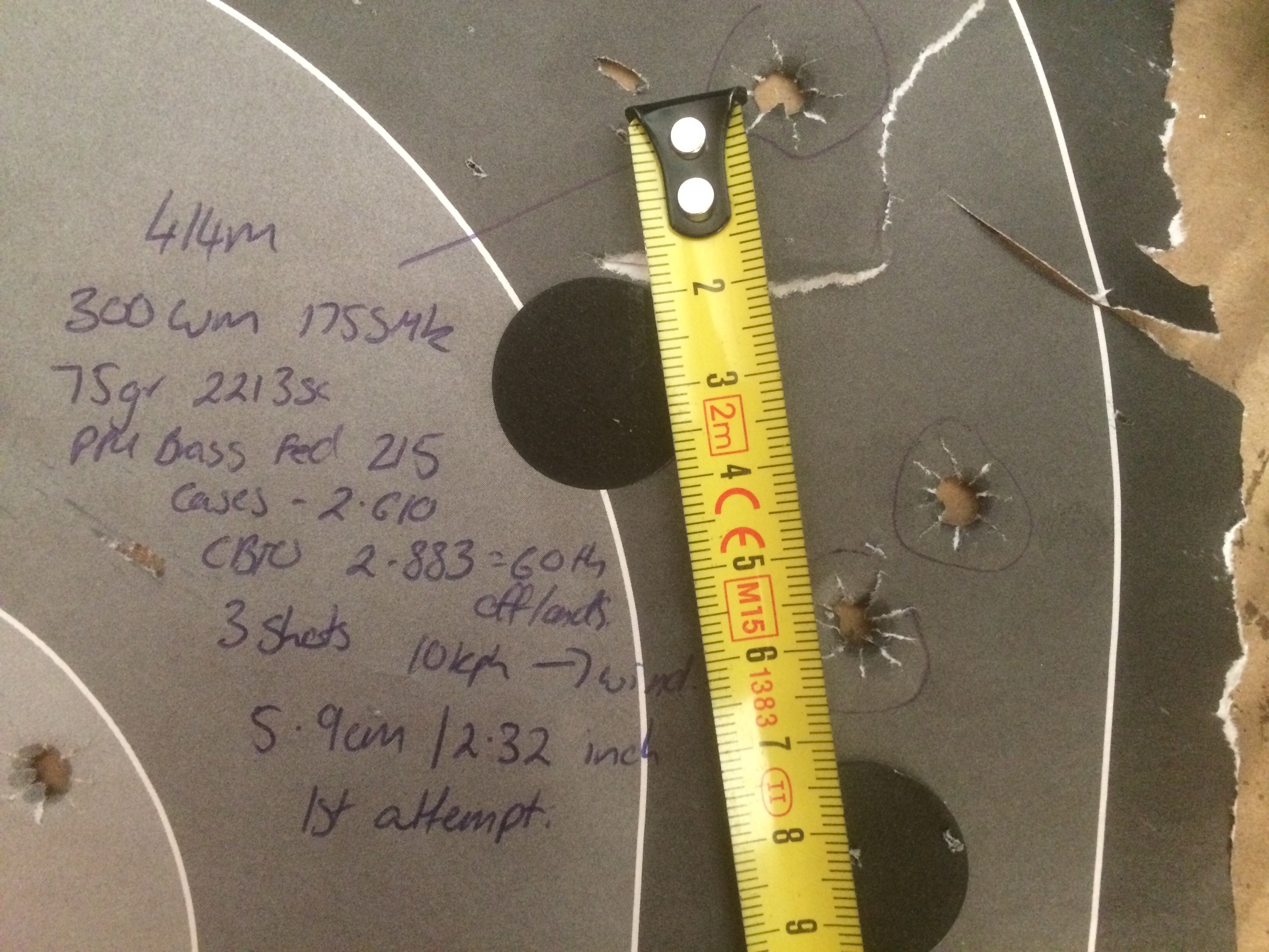

Hey guys,
Thought id check in with a range report, some of you 300wm shooters might be interested.
I have a Tikka T3 Varmint 300WM in an MDT Chassis. The below load of 5 shots grouped at .230" or just over half a centimetre at a 100m. Thought id try my luck at 414m for the 1st time, i ended up with a group of just under 3". I only managed to shoot off 3 rounds as opposed to my normal 5 for groupings.
Whats your thoughts? Is this a good group for a 300wm @ 400ms? Id welcome any feedback.
My load was:
175 SMK HPBT
PPU Brass
Fed 215 Primers
75gr 2213sc
Cases trimmed to 2.610
CBTO - 2.883 = 60thou off lands

Nice work mate, looks solid to me

Very good,well done. :D

Anything under 1inch per 100m is good shooting in my opinion. Especially in an outdoor environment.

I have looked up your load.Nice work.I use the 168 matchkings in my 7mm Rem Mag and they fly true.I will have a go at 400metres and post the results

Definitely a good result :thumbsup:

Just curious for comparison but did you try the same loads in the factory stock before switching to the MDT Chassis at all?
