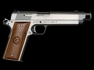

Post by brett1868 » 11 Aug 2017, 5:45 pm
This is next...something "Different" :)
