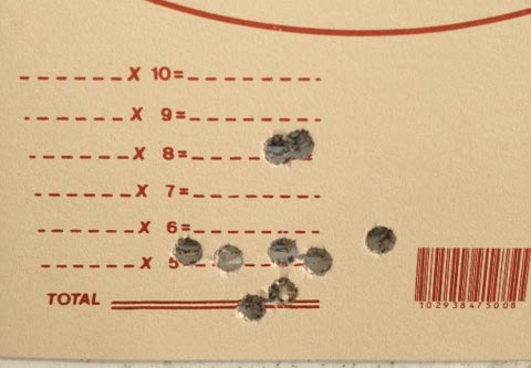

I have a Tikka T3 Lite SS synthetic in .243 and have been shooting it for almost 4 years, while reloading for almost 2 years.
Since my Tikka has a 1:10 rate of twist, I decided to use the Hornady 87gr V-Max (or HPBT) with ADI AR2209 powder. Since Tikka rifles in the synthetic stocks are supposed to be "Free Floated", there has always been a small pressure point about 3 inches from the receiver that the barrel rests on.
Two range sessions ago, I tested out a promising load of 42.9gr and with a cold, fouled barrel, it gave me POA=POI. Now, I thought that was great, however I decided the remove the pressure points that afternoon believing it will improve my accuracy with a hot barrel. I used to shoot my rifle like a target rifle and send a few rounds downrange in the space of 1minute (which I have now realised that it's a sporter barrel and not a heavy barrel!!!)
Yesterday I took the rifle back out to Belmont to shoot the rifle in a much more controlled way by shooting one round every 10 minutes to keep the barrel cold. Again, this is with a 100% free-floating barrel with the pressure points removed. Sadly, my POI had changed dramatically and my accuracy had worsened.
I decided to pull the action out of the stock and place some gasket cork where the pressure point used to be and tightened up the screws, thinking it should return to how it was. My results looked promising (on a vertical scale) however my horizontal spread wasn't looking so good at all :shock:
I've read that horizontal stringing is more shooter error? I also read on other forums, it can be rifle bedding (or floating issue). Should I keep the cork out and rework my handloads to suit the new barrel harmonics? Need help :(

5Tom wrote:I've read that horizontal stringing is more shooter error?
On that subject, overall the group you're posted a screenshot of it about as high as it is wide...
If there was one more impact between the bottom group and top two, it would just about be round.
Not just having an off day perhaps? It does happen.

Post by 5Tom » 14 Oct 2013, 6:58 am
Sorry, I forgot to mention the two shots above the horizontal string were shot under different conditions. I took one shot without the gasket pressure, then added the gasket and did 3 rounds in the center of the line. The following 3 shots were to the left and right of the 3 round group forming the line.
I then removed the gasket again and sent one round next to the first shot above the line.
Each shot was 10 minutes apart.

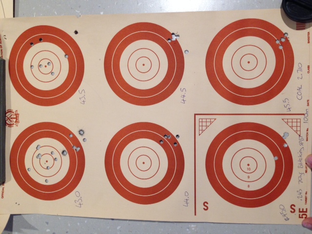

Post by 5Tom » 15 Mar 2014, 12:22 am
G'day
Forgot about this thread ha! I decided to shave off more material from the barrel channel to have a more "defined" air gap for a proper float. I figured if the barrel heats up and effects accuracy, it has to be touching the stock still.
I've since bought a Wheeler torque wrench and tightened the action screws between 40-45inch pounds as per spec. The other change I made was the projectile from a 87gr (v-max or HPBT) down to 70gr Sierra Blitzkings and tested more rounds. I also adjusted the COAL to 2.710inch, which is I believe a SAMI spec for .243 cartridge. Below is the load development results after the above changes. Next range session to make sure I'm on the right track :)
I'm guessing the sweet spot is between 44.3 and 45.3 grains of AR2209.
2209 70gr sierra blitzking COAL 2.710.JPG (128.73 KiB) Viewed 6468 times
