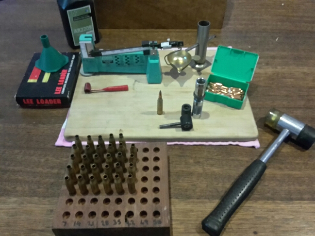

Here's my complete set up that I use with the lee loader.
I get outstanding results by batching my brass by weight, measuring all my powder with scale and some attention to detail when prepping the brass.
Seating depth and load testing have also played a major part of getting sub .5" groups.

Pretty much what I started with as well, except I bought the RCBS case length trimmer, RCBS plastic dial caliper, the inside/outside neck chamfering tool and the Redding beam scale to go with it. Made many, many hundreds of very good .222 Remington rounds. I still have it all.

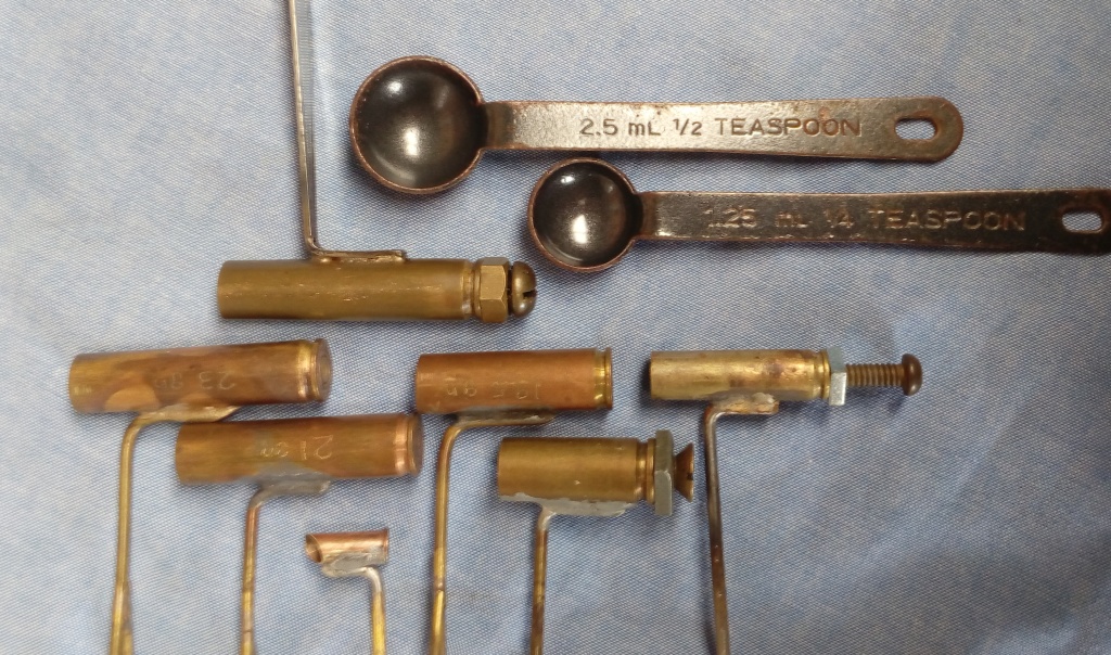

I weigh every charge. I use a home made dipper/scoop. A copy of the lee. I have a few now, just make them as I need them out of empty cases. One is adjustable with a screw in the primer pocket. :)
Then I use my home made trickler to weigh on an old set of redding powder scales. Its slow but works for me. A trickler is very easy to make. I made mine out of a plastic pill bottle.
The trick with the scoops is to be consistant scooping and to level them with a small piece of paper by "swiping" it across the top of the scoop.

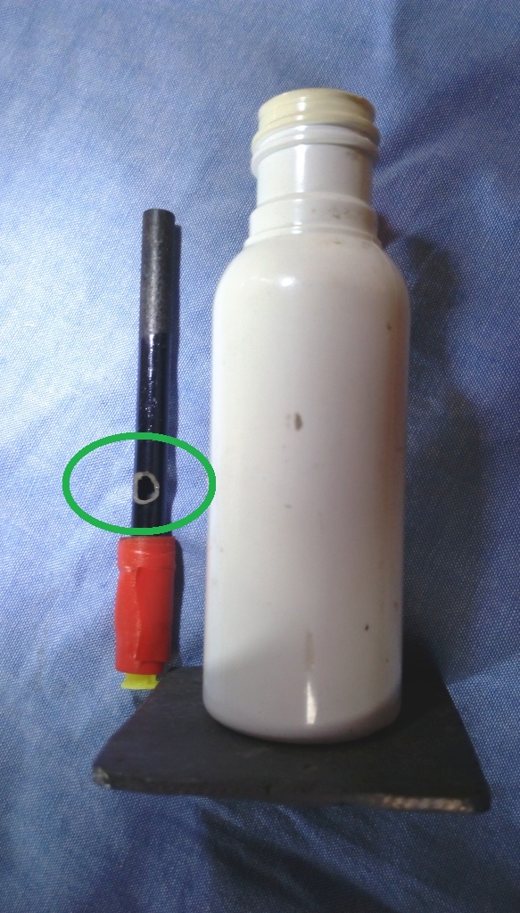

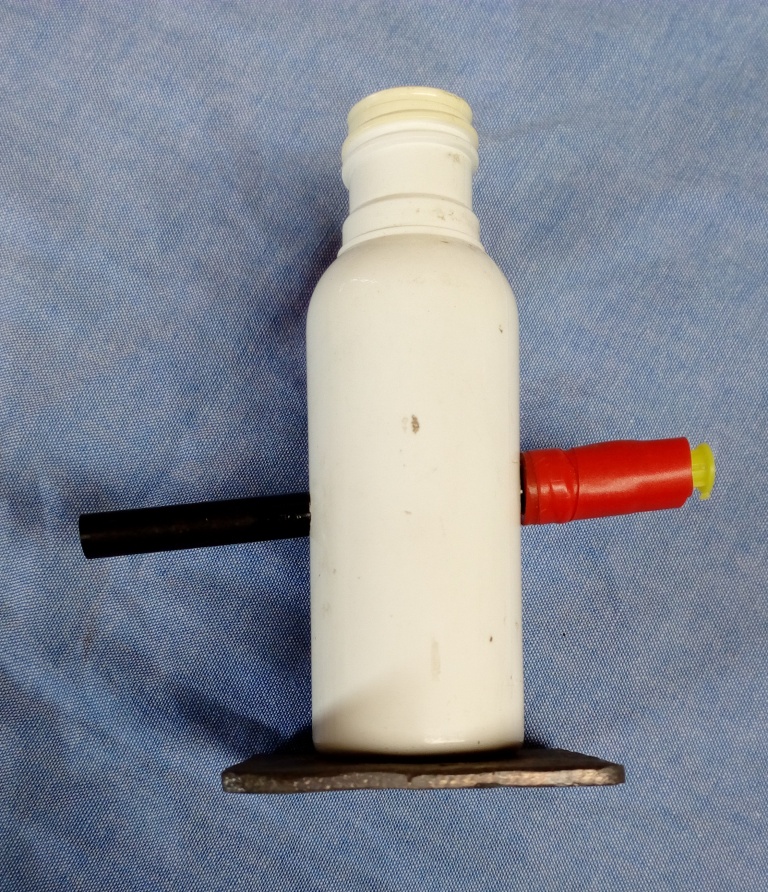

Also uploaded some pics of my dippers. Some are adjustable for volume by having a screw in the primer pocket. One is 3/16" whitworth and a couple 1/4" whitworth" I think. System seems to work.
Also home made trickler. Just a pill bottle with 2 holes drilled at the appropriate height. One slightly higher than the other. A piece of lead sheeting fixed to the base to give it some stability. The tube is a piece of hollow fiber glass from an old fishing rod but any tube about 1/4" in dia would do.(perhaps an old biro?) Insulation tape to act as a stop and a small hole drilled/ground into the tube to pick up the powder grains.
The best recommendation is to copy. So I copied Gwions tiny 22 dipper idea. :D
