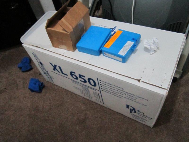

personally i think they should ban brass, primers, powder, reloading, guns, ammo and even wall posters of chicks with guns... Its just not safe.
that's all i got time for tonight, now back to the task of putting together the dillon re loader...she's such a beautiful machine, she belongs in the bedroom...

Post by lole » 18 Mar 2014, 6:17 am
You're still putting that together?
C'mon son! We want some pics of it in action ;)

Post by BBJ » 18 Mar 2014, 7:47 am
He just bought it for decoration because they look pretty :D

Post by petemacsydney » 18 Mar 2014, 7:03 pm
LOL, Sorry guys, i feel like i am letting the team down. it's been sitting in its box for a week because i ordered the extra base mount to bring it above bench height, so i havent even started!

Post by Aster » 19 Mar 2014, 8:17 am
Well that's a disappointing photo :lol:
