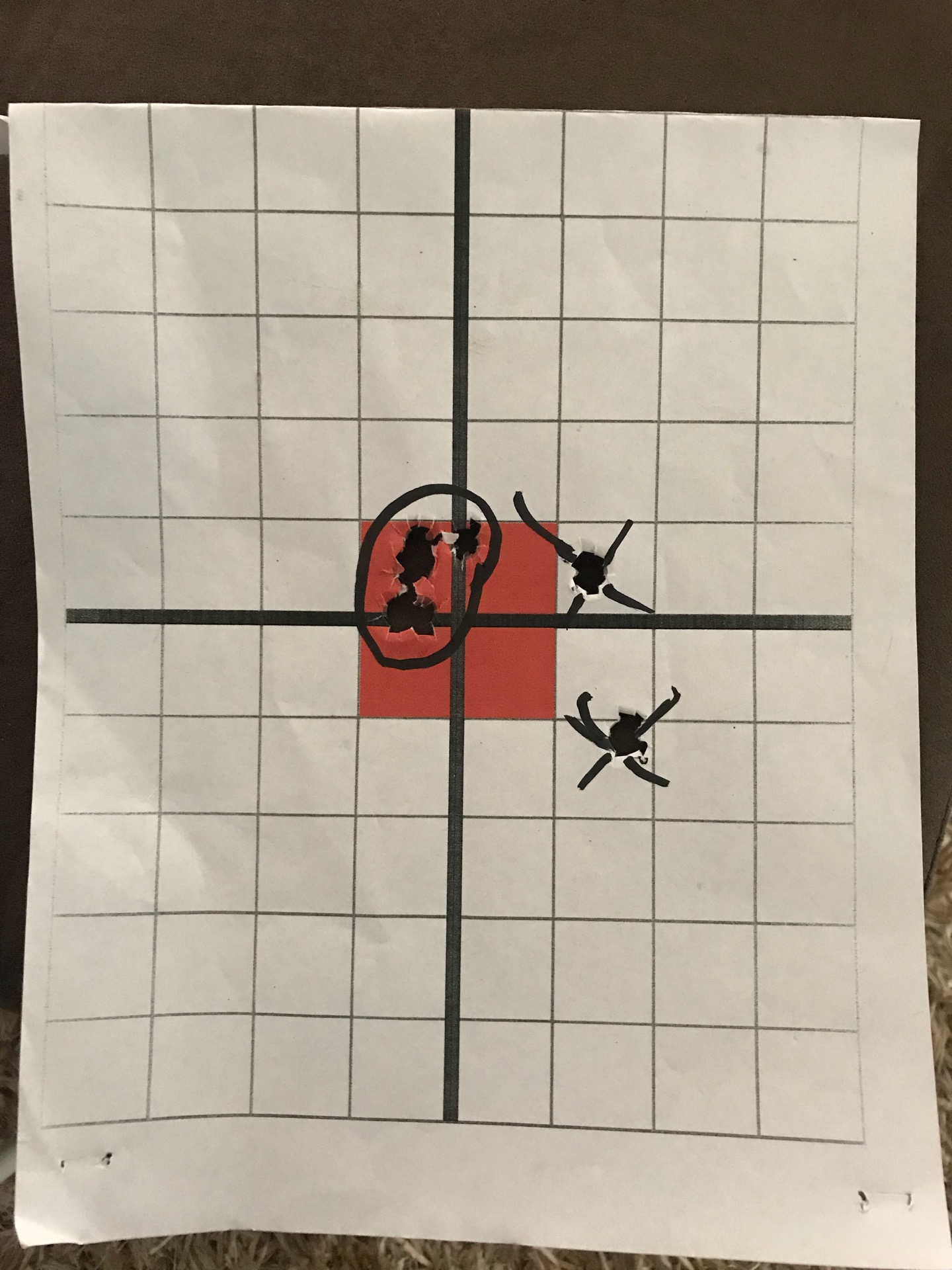

Well for those who are interested I took .308 to the range and shot two different types of brass out of it at a range of 100m using the same load and projectile. They seemed to both shoot the same as per the attached target. Disregard the two marked shots as they were not part of the test. The circled group contains six shots, three with ADI, and three with Lapua. In this case the two different types made very little difference.

Post by Gwion » 19 Feb 2018, 12:13 pm
Well, there you go. Certainly do you for the hunt!
My reasoning would be that if you are on a good node at the lower/mid range of charge then I would expect that kind of result. If you were getting up to higher charges, you may see more variation due to pressure differences. Then again; it's all speculation and depends what you call good results. I'd say they look pretty good.
What size is that red square?

Post by JimTom » 19 Feb 2018, 12:20 pm
G’day Gwion
Mate the target is marked in inch squares. The extreme spread of the group is just on an inch. I am happy with an inch at 100m bearing in mind that it is just a hunting rifle and I’m definitely no target shooter :-)
