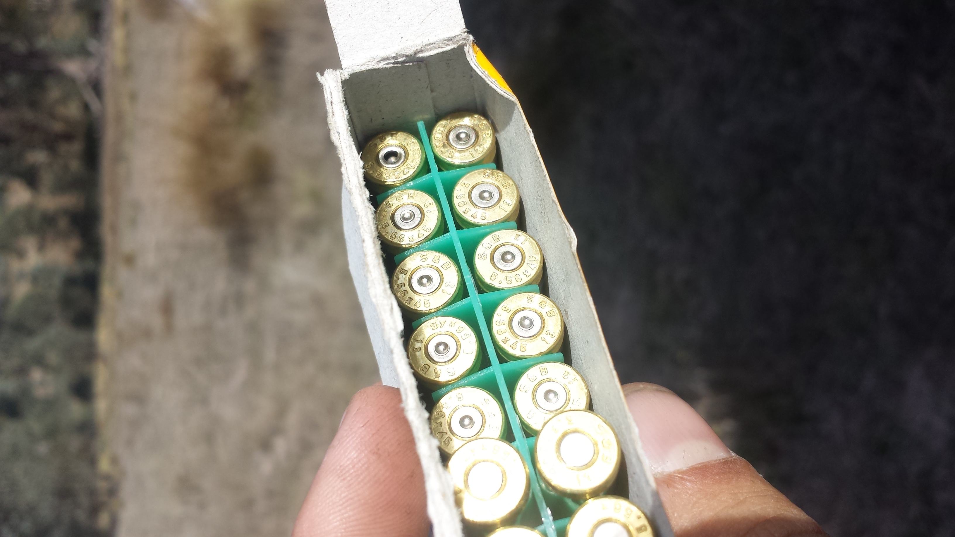

Hi All, recently bought a heap of different ammo to see what the new .223 likes (not set up to reload just yet).

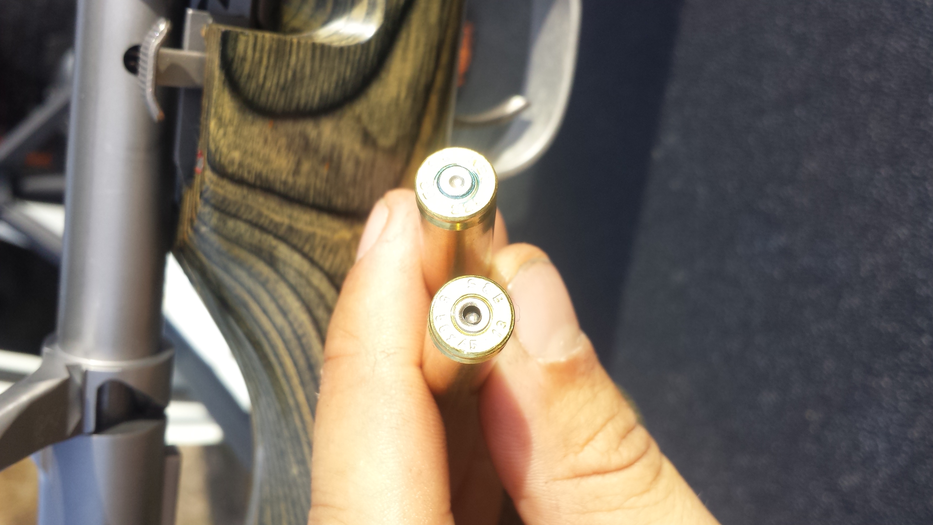

One of the ones I bought were Sellier and Bellot soft points. These things seem way too hot and/or soft primers. As you can see in the pic below i had one punch straight through the primer. Next to it is a Federal blue for reference.
All the S&B primers cratered, flattened and started moving back out of the case. I tried 10 and gave up. Should I take the rest back rather than risk putting through the rifle? Groups were crap too.
Also of concern was the box was labeled 223 Rem but case stamps say 5.56x45. Maybe this is why? Thanks.

Don't know anything about S&B Factory Ammo but the pierced primer is a worry and something you do not want to happen again as it will damage your bolt face. It would be interesting to see what a Chronograph showed for speed. Maybe they are hot loads or perhaps just very soft primers.
Federal generally are soft primers, be it factory ammo or using their primers in your reloading. Some are thicker but again it's hard to know what they use in their factory ammo.
Cratering like you show is not a big issue and cratering in general is not a reliable indication of over pressure or hot loads. Cratering can be caused by a number of reasons like firing pin diameter to bolt clearance, excessive headspace, soft primer cup etc. Flattened primers right out to the edge of the primer pocket is a much better sign but really determining hot loads is to measure the cartridge case after firing with a micrometer looking at case expansion.
There is not a great deal of difference in military ammo as in 5.56x45 compared to .223R in a .223R Chambered Rifle but the opposite can be quite different.
Your Federal Case looks fine so either fire the rest of that packet of S&B and see what happens, take them back and see what the shop has to say. If you have more than one packet I'd take them all back and try something else.
By the looks of your firearms list I take it that this would be in your Howa which I know nothing about what the chamber size may be or how they set factory headspace without measuring your fired rounds.
Safe side, don't fire any more.

+1 I purchsed 100 rounds very, very cheap for my new 223. They were showing signs of being a little hot and groups were terrible. ( not as bad as yoursthough)Fired about 50 and (due to distance from lgs) dismantled the rest. Used the cases in reloads and got nice groups immediately. Noticed also that the cases varied a fair bit in weight. Apeared about half were say ....5 grains lighter than the rest but consistant, like they came from a different die/production line.
I would return those if feasible.

I find S&B ammo to be loaded quite hot anyway. Having typically thicker 5.56x45 cases with smaller internal capacity and higher pressures won't help either.

I reckon the problem is running 5.56 nato in a .223 rem, the 5.56 has higher pressures.
I would not use 5.56 nato in a .223.

First off, it is NOT 5.56 NATO ammunition, but it does use the heavier NATO case, and so the headstamp. This ammo is loaded to higher pressure than most sporting 223, and is intended for the US market to operate reliably in semi-auto NATO spec rifles (Read AR/M 16, etc). It works OK in my Howa 223 VT, but only just, and I do get deep primer dents with some cratering. I no longer use it having bought a case of OSA 223. If the ammo doesn't work in your rifle, move it on or take it back and see if you can get a refund, but don't try saying it is military ammo because it isn't. The soft point alone gives that away. Cheers.
