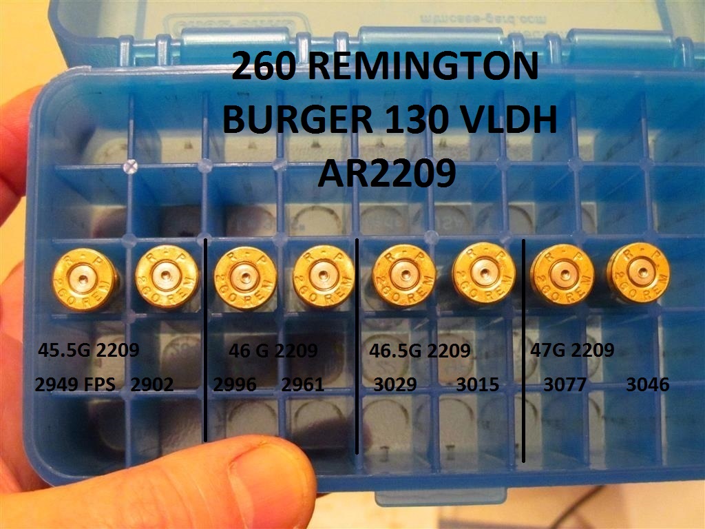

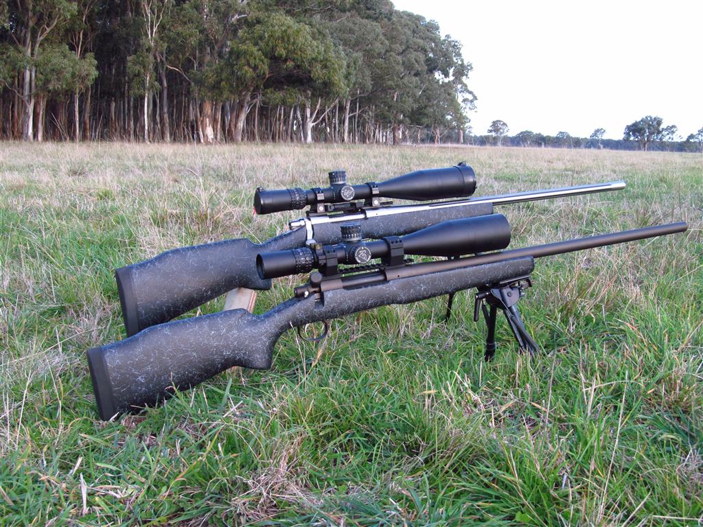

gday all i just had this built in 260R as it's a cal that has intrigued for years and so far it is working out ok
it is a very mild round to shoot even with heavier pills than the 243 i sold to finance the scope for this one
rem 700 long action
chamber 260R
barrel MADCO 26" SENDERO profile 26 1/4" 1:8 twist threaded muzzle
B&C M40 stock
over size recoil lug
JEWELL trigger
cerakoated
SEEKINS 20MOA rail and rings
NIGHTFORCE NXS 5.5-22X56 MOART
anyway here it is with my 7mm mag....
IMG_2128 (Medium).JPG (215.8 KiB) Viewed 12007 times
velocity for this load is 2917fps

Re: 260 rem what's ur best load
Post by Sender » 16 Jul 2015, 1:08 pm
0.28 MOA.
Better than working out OK IMO ;)
