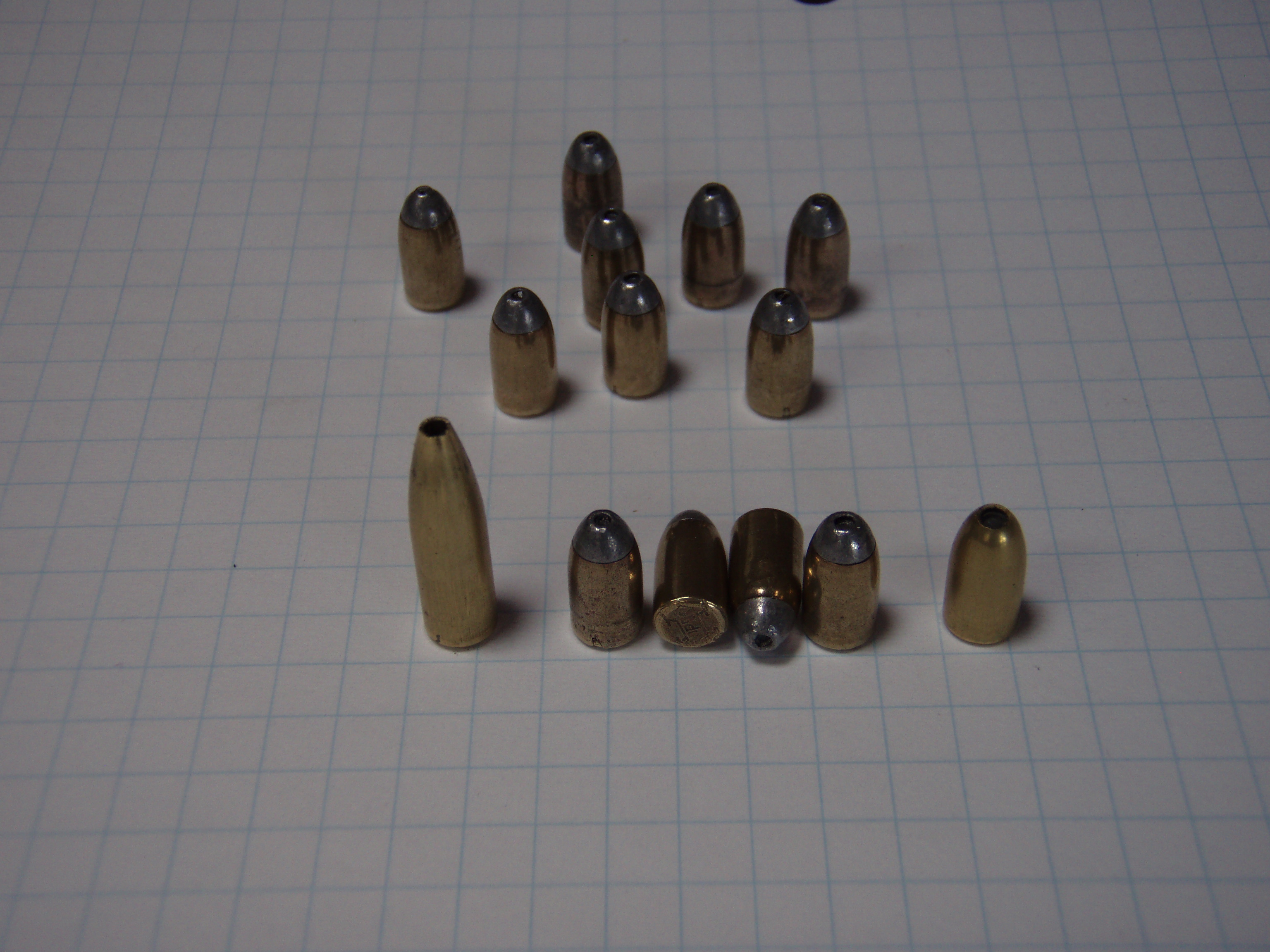

Still working with short jackets for a.224", 40gn and came up with this. I have not polished them up to look pretty as they work just as well straight out of the die. 40gn soft point, fully annealed jacket with a 1 cal point form.
Might be good for a TCM? on the left is one of my 69gn and on the right is a 40gn hollow point.
Bill

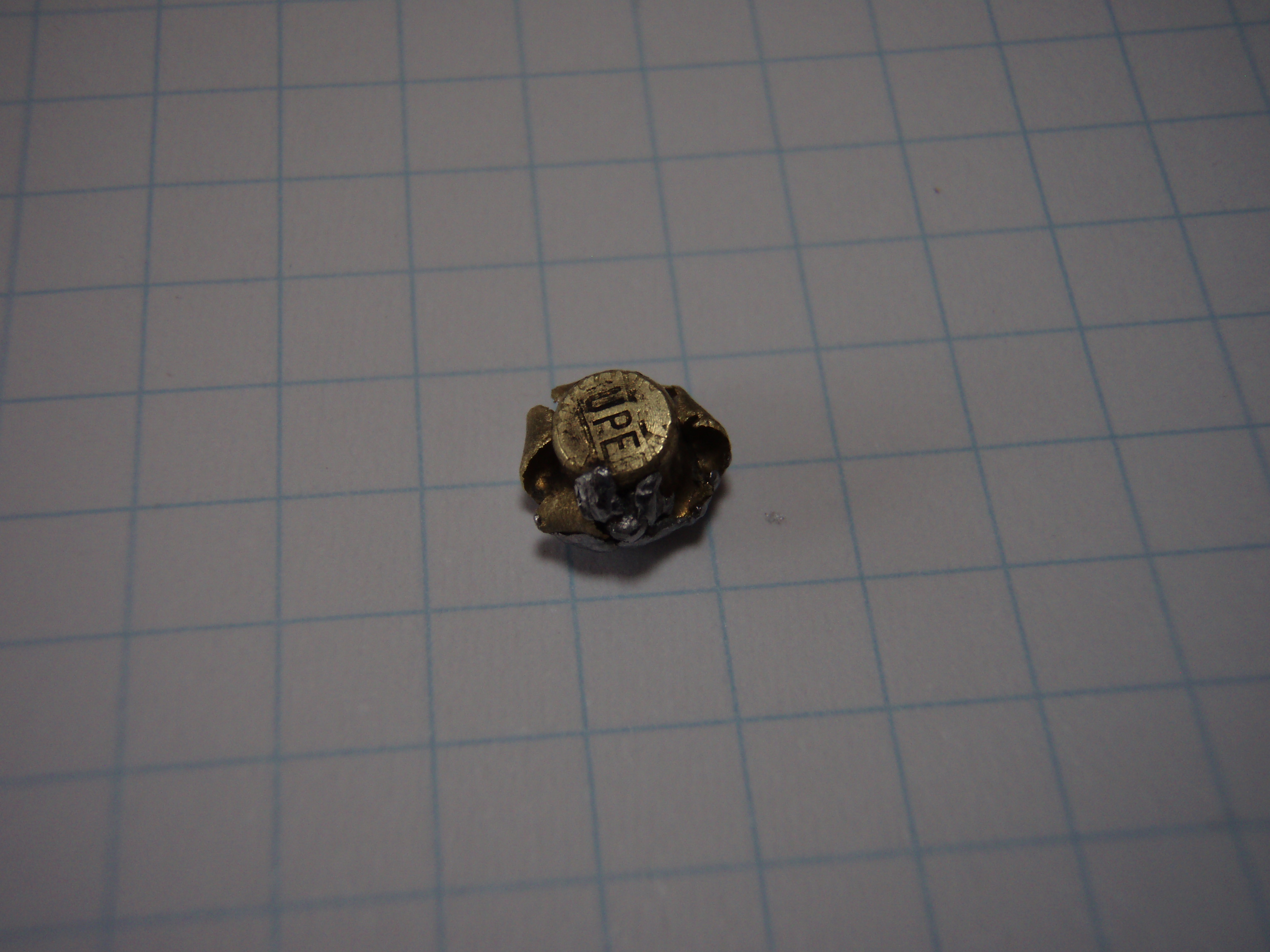

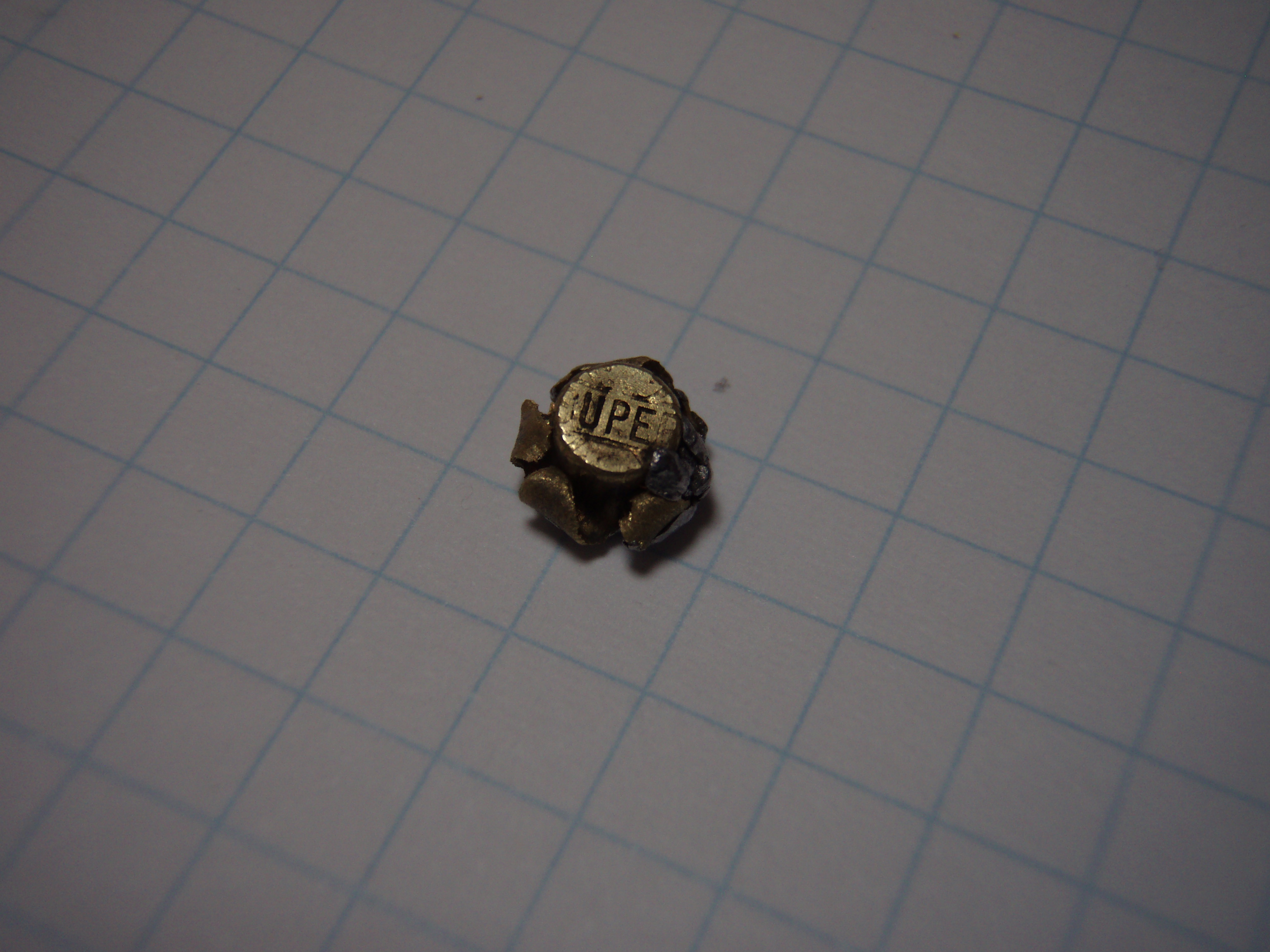

17gn, 17 cal, with 3.6gn of trail boss, 2000f/s. I thought it would still self destruct even at that velocity but the mushroom was impressive. Only lost 3gn in weight. Jacket was a Win SuperX 22LR case. More research required to get it to fragmentate at low velocity. Maybe swaged lead shot.
Bill
17gn, .405" jacket

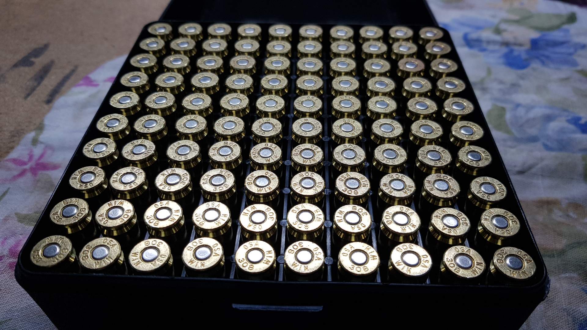

223 done on the amp machine
50 223 fresh from AMP machine

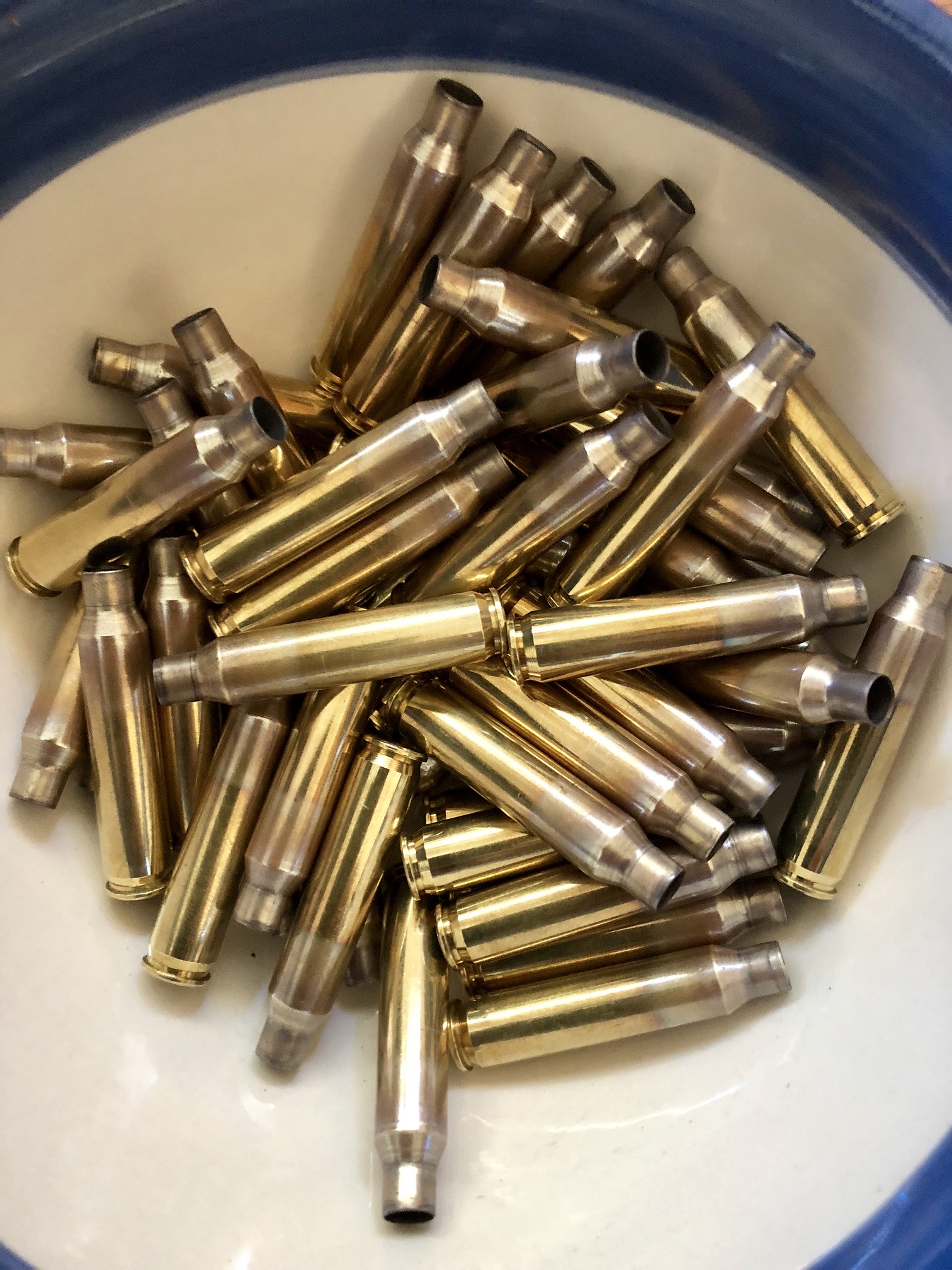

Here's 100 pieces of new OSA .308 brass sized & primed.
Just waiting on pills and powder now.
Is it just me or does the shiny symmetry look very majestic.
