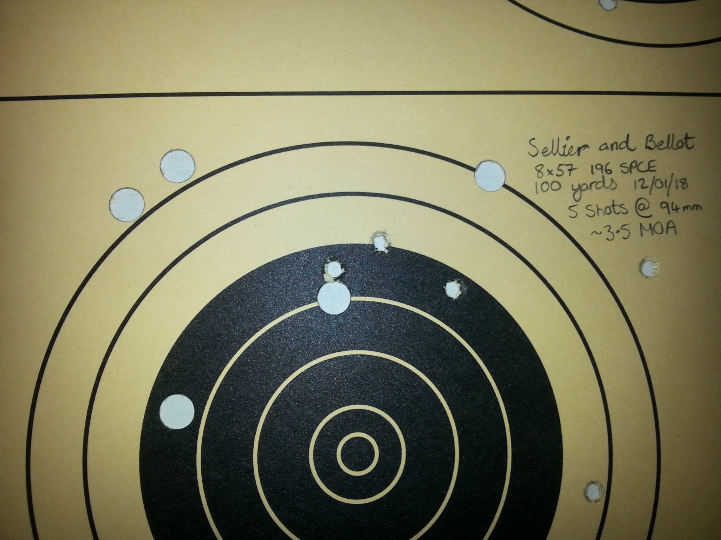

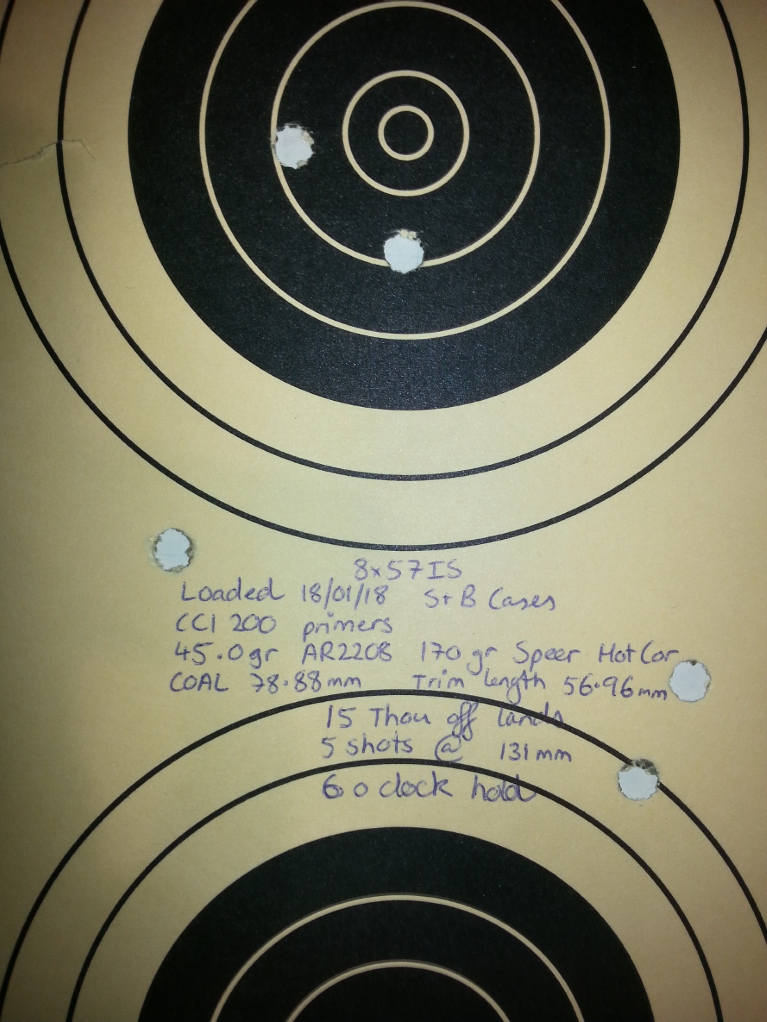

Hey guys, just wondering if anyone has experience loading 8x57. If so what loads are you running and sort of accuracy do you come to expect. I'm asking because I recently went out and tested my first ever handloads through my m1904/39 Vergueiro and got some very different results between the two loads I tested and factory ammo. I only loaded up one powder weight for each load. How much change in accuracy can I expect by fine tuning charge and seating depth? Is there any point in experimenting with the Speer 170gr if the results for the Hornady 150gr's are dramatically better at starting loads?
The first group I shot was with 196gr Sellier and Bellot SPCE wasn't all that great but still fine for my purposes.

Handload number 1 was even worse at about 5" at 100

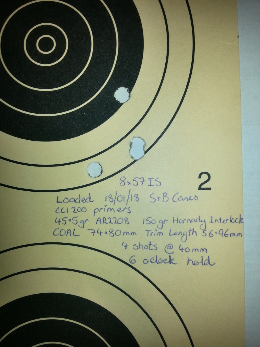

Handload number 2 was easily the best at about 1.5"

I think your "handload 2" is excellent indeed.
