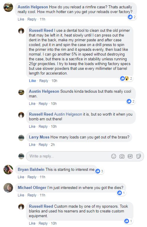

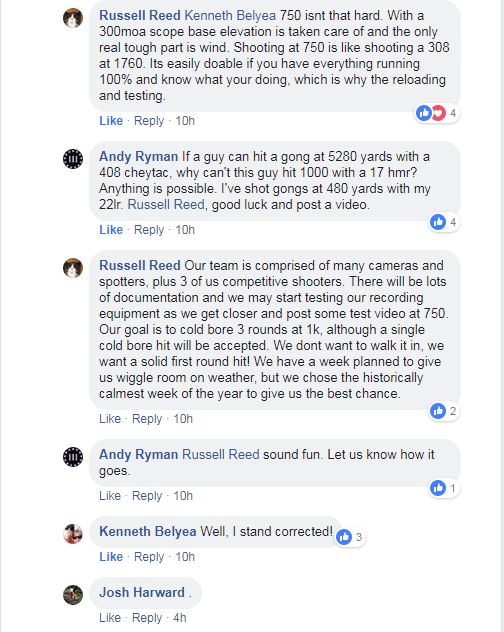

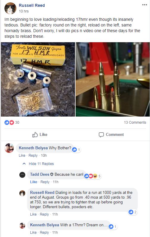

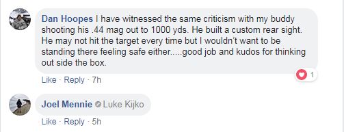

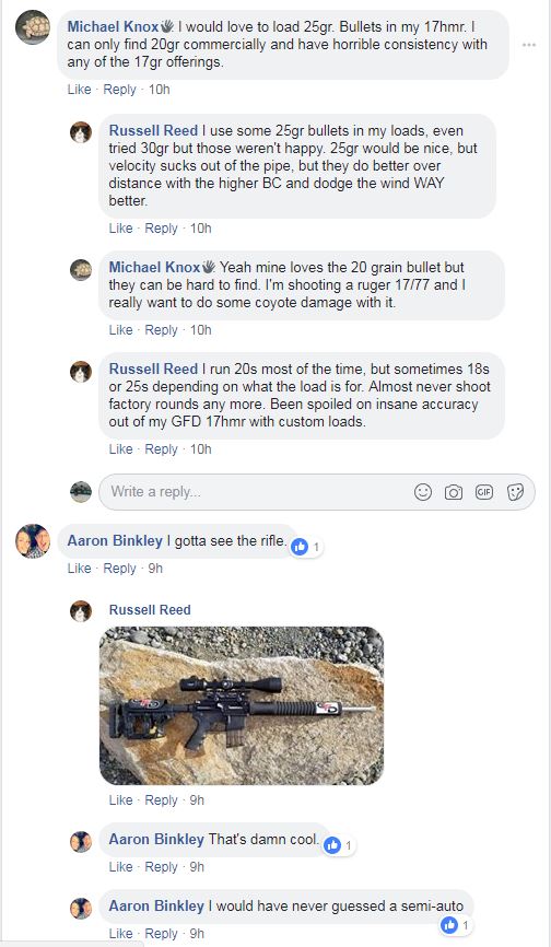

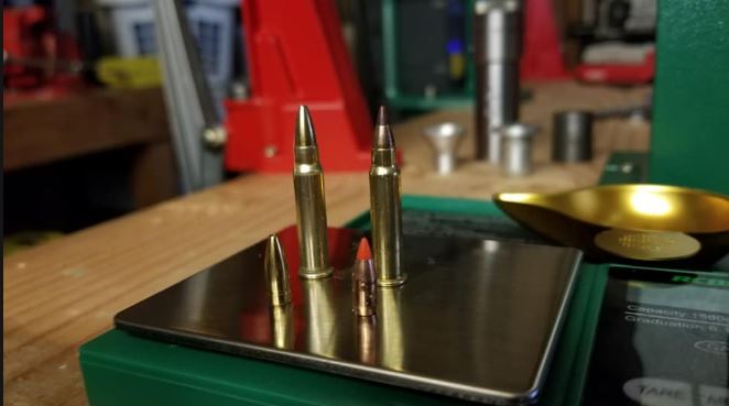

Post by bladeracer » 04 Jul 2018, 8:48 pm
Okay.

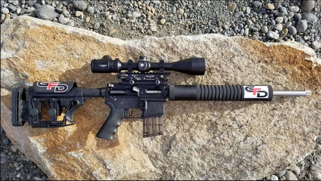

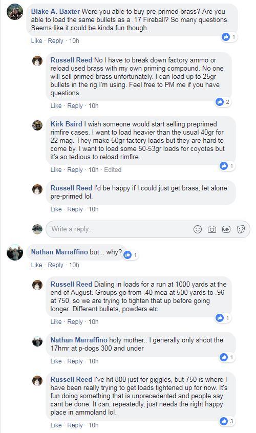

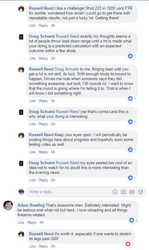

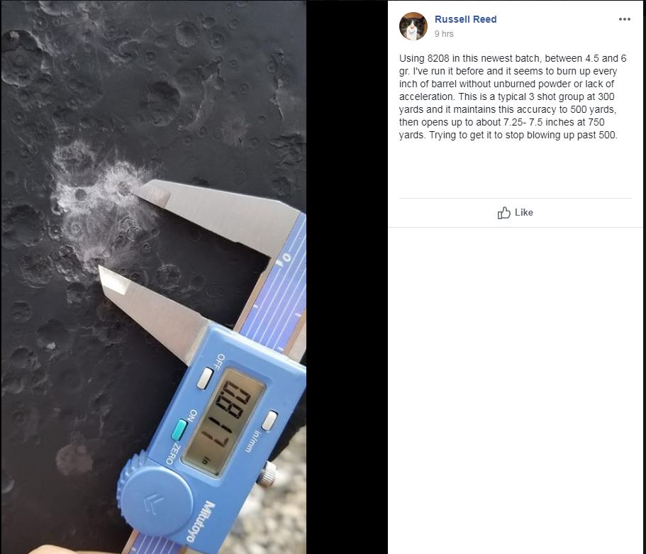

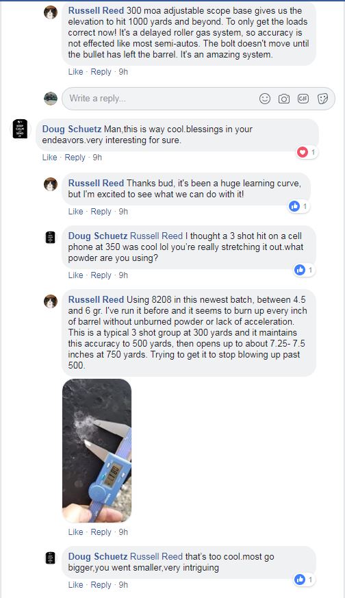

EDIT: I put a little more effort into the screen shots, including the photos.
HMR reloading 1.JPG (83.62 KiB) Viewed 9898 times
HMR reloading 1a.JPG (73.08 KiB) Viewed 9898 times
HMR reloading 1b.JPG (35.11 KiB) Viewed 9898 times
HMR reloading 2.JPG (80.2 KiB) Viewed 9898 times
HMR reloading 3.JPG (83.92 KiB) Viewed 9898 times

Post by bladeracer » 04 Jul 2018, 8:51 pm
I personally didn't see the value. The brass is quite thin so I doubt you get many loads out of it.
But he's loading them for accuracy and velocity, not to save money or recycle the brass.

Post by Gwion » 05 Jul 2018, 6:04 am
I am finding this very difficult to believe. I'm sure a good shooter with the right set up can use a 17hmr to 'hit a gong' at 500 or further but claims of 0.4moa at those ranges being "typical" with as bc of .2something would require the birds and rabbits all stop breathing every time he takes aa shot...

Post by sungazer » 05 Jul 2018, 2:06 pm
I don't quite get the part when he says he doesn't want to walk the impact in. However they will do that for a week in practice. Then stop for a day and the next day call it a first round hit.

Post by bladeracer » 05 Jul 2018, 2:26 pm
I agree with you guys, doing this "with .17HMR" is quite different to doing it with a custom built rifle and bastardised ammo, but it's still pretty neat if he can manage it. It's not like it's going to be carrying any energy for any practical purpose :-)
My calcs were just showing the requirements to keep the bullet supersonic at 1000yds, but the bullet only needs to hit the target at 1fps at 1000yds, as long as it's still travelling reasonably accurately. Lots and lots of targets have been hit at long range without being supersonic.
I think walking the bullet onto the target is different from simply taking a shot and getting a hit. You could shoot 5000 rounds over six months practicing, but getting a cold-bore hit on the day is still impressive.

Post by Gwion » 06 Jul 2018, 6:13 am
My 223 wallaby rifle with 50gn bullets is capable of 1" groups and smaller at 300yd on a day with good even wind. I can even keep it around the 5 ring at 600yds when everything goes right. The slightest variation in wind can tripple that group size. Any serious gusting or mid range fluctuations just blow it all over the place out at 600yd, which is it's absolute limit for supersonic impact. This is a 50gn bullet with a higher BC that the .17 35gn bullet, leaving the barrel at 3150fps (short barrel).
The 'typical' groups these guys are claiming just screams horse doodoo.
If they can do that, they should be unbeatable at world champ fclass or other precision shoots with their shooting skill, mirical working gunsmith, flawless reloading and divine wind reading.....
