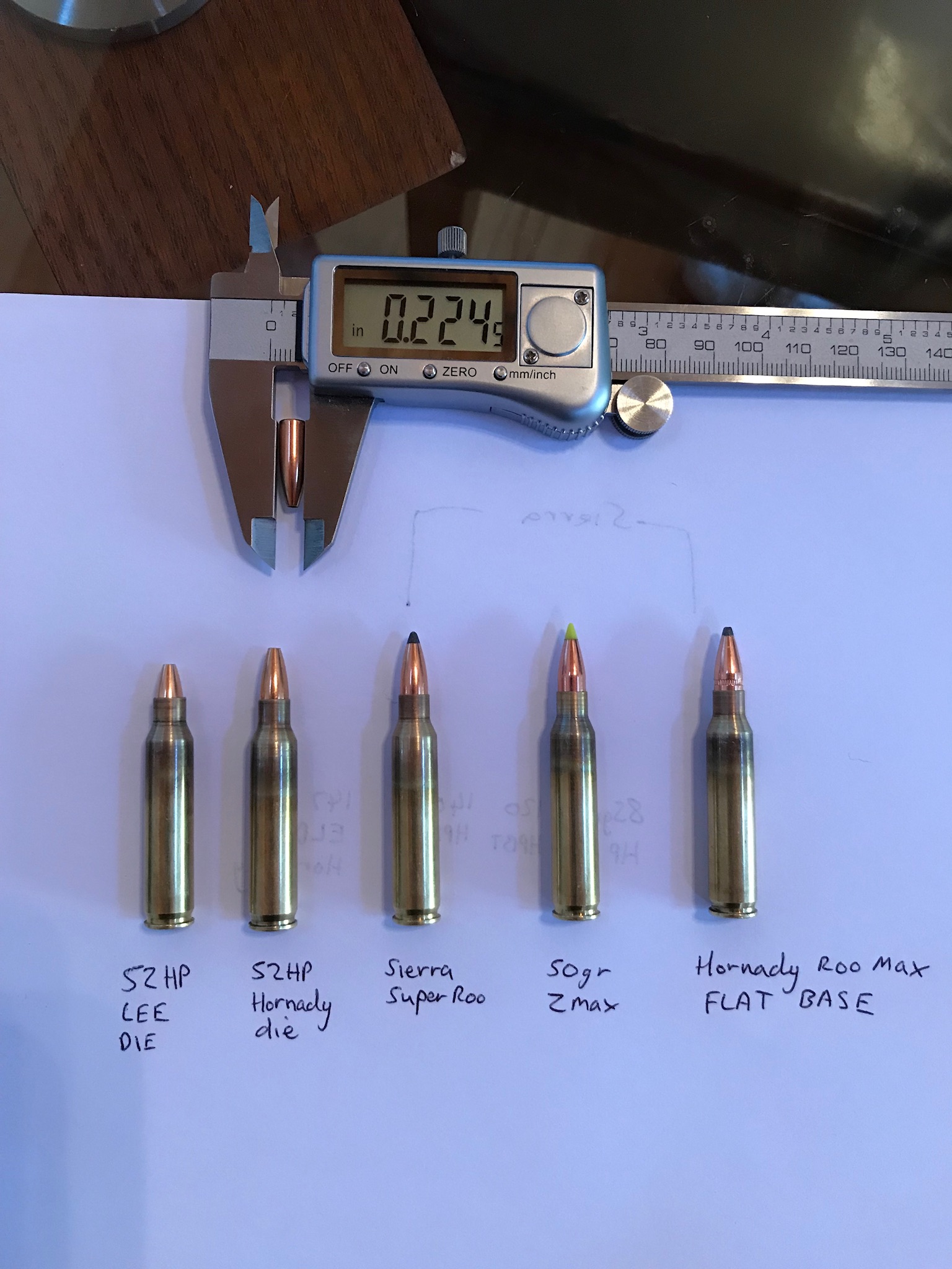

Post by Cooper » 02 Aug 2018, 12:06 pm
Ok I think I possibly have more than one issue here. I've found a way around it. But would like to get to the bottom of it.
I've bought a 1000 bulk pack of the Speer 52 grain hollow point. They are the flat base version not the boat tail match version. I've loaded plenty of flat base bullets before. Hornady roo max/Berger 52 gr flat base and Speer 52gr HP out of a 100 pack before I bought the 1000 pack. All without apparent issue.
So I sized my case with Lee collet die. The cases are probably on their 8th reload and I haven't annealed the necks. Upon seating the bullet it is apparent that there was initial resistance and them nothing. I can move the bullet with my fingers.
So I pull my Collet dies apart thinking it must be dirty or seized up. Everything appears in order so I put it back together. Increase the tension on the die another 1/4 of a turn and try sizing another case. Same problem
Start looking at bullets thinking they must be undersized seconds or something.
I chamfered the case necks and tried again. Same problem I can push the projectile with my fingers.
I'd already primed up the other cases. When I remember that I had a Universal Hornady 22 cal neck sizer that I could easily pull the decapping pin out of to try sizing the cases a different way.
The story is dragging on a bit... So after using the Hornady neck die I could seat the projectile and not move it with my finger pressure. So problem sloved. Kind of. But I still like to get to the bottom of it?
My main thoughts are the bullets (projectiles) appear to be thinker at base (measuring with Verniers) I can get .224.5 right at the base whereas the rest of the bullets appear to be .224. I measured a 50gr Zmax which starts with a Boat tail and most of the bullets appears to be .224.5. But these measurements are easily malnipulated and not really that accurate.
The mandel in my Lee die is .222. It has been lightly polished
The other thing is the brass is a bit old of maybe it has lost some of its elasticity.?
Happy for any input? Thinking I'll buy another mandel for my Lee die and polish the one I have a bit further and maybe try annealing the cases and see if that makes a difference.

Ok so I annealed the cases. First time I've done it definaltely got the first one a bit hot. Just used my drill and a Map gas Turbo torch.
I only did 5. When they cooled went and sized them with Lee Collet die. Felt a little better. But the most obvious thing was the case was slight sucking on the decapping mandrel on the way out. So it does appear the brass had work hardened and annealing seemed to have fixed it to some degree.
Now for the rest test...
So I seated Speer 52 gr HP in the case. Same problem! I can push the projectile with my fingers. Far out!
I run one of the annealed case through the Hornady neck sizer. Seems good. Projectile is gripped pretty well.
I've never had this problem before. So I used the Lee a Collet die to resize the other 3 case and seated a 50gr Zmax and 55gr Sierra super roo which was were both held snugly in the case. For good measure I seated a Flat base Hornady Roo Max! No problems can't move it with finger pressure
Whatever is going on its only happening with 52gr Speer projectiles. Everything else is working the same. Just as it has in the past for me.
I dunno. The Speer 52gr definaltely appear slightly bigger at the base. Maybe the collet is putting a slight taper on the neck when it sizes it and when I push the Speer projectile into the neck it is opening up. Maybe the Hornady die is working because it is kind of doing the opposite. The neck might be tighter closer to the shoulder of the case. Because the expander is getting pulled back through it.
