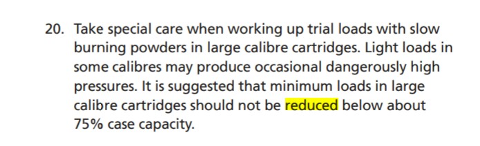

John the ADI Powder guide lists 2206h available for all loads for both 243 and 308. This being the case I would just buy one can of this powder and try this for all loads first. it's much better more practical and cheaper due to no wastage to use just one powder for as many rifles as possible. If you're getting acceptable accuracy with this powder just continue to use it. The other advantages of 2206h is you can download too I think as low as 60% of the maximum charge no other powder will do this. You mentioned earlier in the thread that you would like to do this.
However if you want the very best loads possible for your rifles you may need to try five or six different powers in total and this can be a costly wasteful exercise.
Good luck you won't look back.
Re: Is it worth reloading?
Post by Oldbloke » 22 Jul 2018, 1:01 pm
Straight out of the adi manual.
Reduced loads 60% max 2206H.JPG (72.59 KiB) Viewed 5099 times
And
reduced loads .jpg (39.15 KiB) Viewed 5099 times
