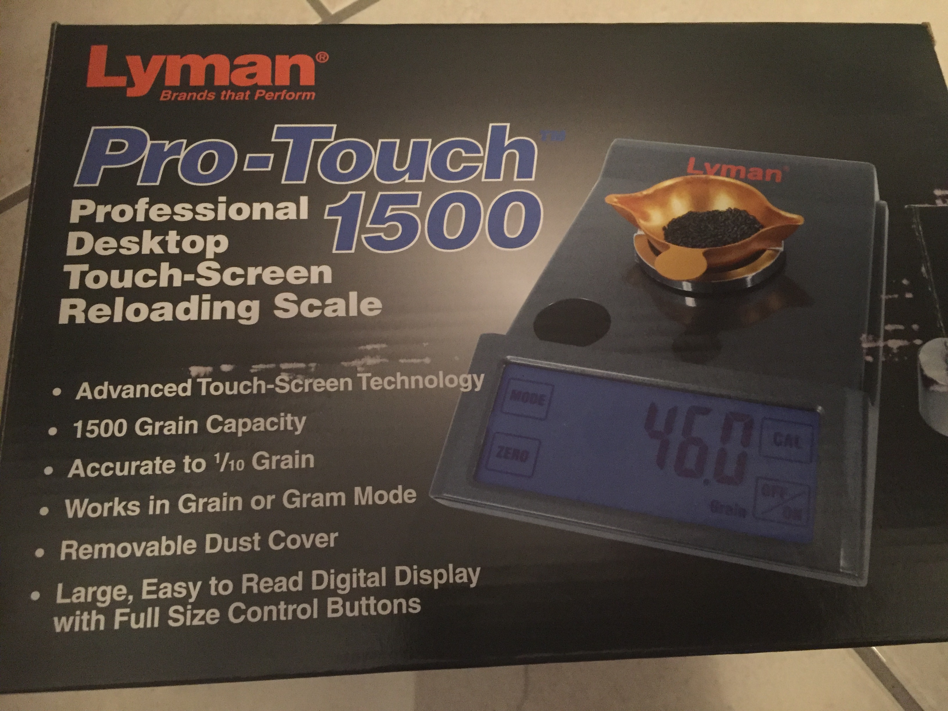

well fellas, i bought a new scale, seems like it's a qaulity unit, all the bells and whistles. even plugs into the wall for power :o it normally retails for $208 at rebel gun works, it's on special for $150. that sweetens the deal. initially i had good results with the cheapie scale that came with my hornady reload kit. but it's been a bit sticky and my last reloads for 222 were all over the place. not a good scenario...... :wtf:
new lyman scale

Hope it goes well for ya richo... :thumbsup:
I do think you'd be better served with a beam scale though due to that one only being to 1/10th gr accuracy...
If you dont get satisfaction from it you know what to do...!!!

Post by bigrich » 03 Sep 2018, 8:29 pm
Stix wrote:Hope it goes well for ya richo... :thumbsup:
(Send it to me with that bludy hornet...!! :thumbsup: )
ha ha good on ya stix. do you reckon the beam scales have the potential for finer accuracy ? as for the hornet mate, i traded that back where i bought it on a ruger gunsite 308 carbine.(just did a post on it"new toy" ) 222 is just superior in every way to the hornet. much better brass life just for starters. get on ozgunsales and look up browns plains firearms if ya keen on it :thumbsup:

Post by Stix » 03 Sep 2018, 10:14 pm
You're just a two timing hoar richo...
You promised it to me & thst you'd love me forever... :cry: :cry: :cry: :violin:
Im a hoarder mate...just buy more guns when i csn afford, dont get rid of any... :thumbsup:
Yes mate like i said i weigh my charges to the granule (still doesnt seem to help me much) but it can be done.
But if you find the node & load in the middle of it you should be right with those scales :thumbsup:

Well guys , I tested my loads on the weekend and consistent accuracy has returned . 1/2” at 100 from my 222. Not the one hole groups I was getting, but I put that down to different full length resized brass. The digital scales that I thought were suspect have been proven accurate by the new scales. The only thing I can put it down to is they were sticky cause it was a cold morning. Anyone else ever experience this?
