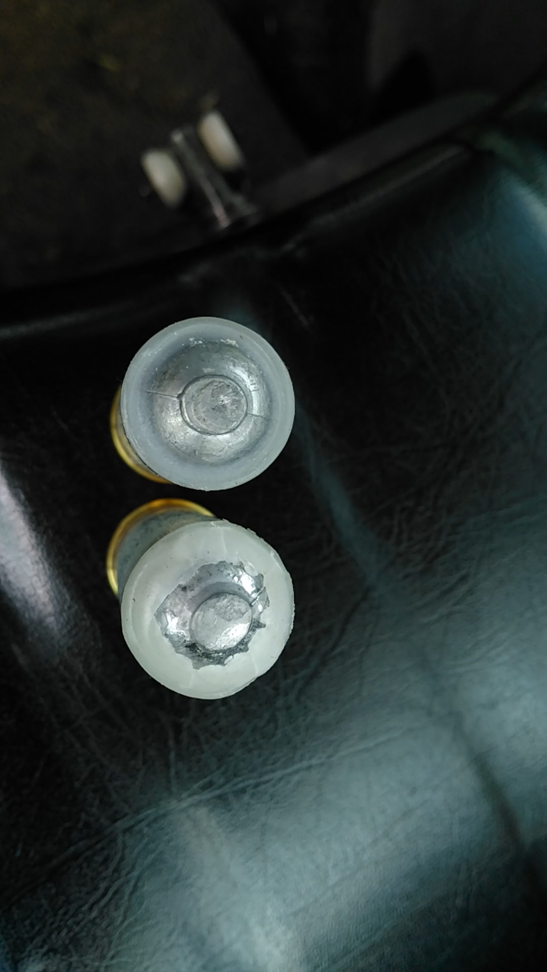

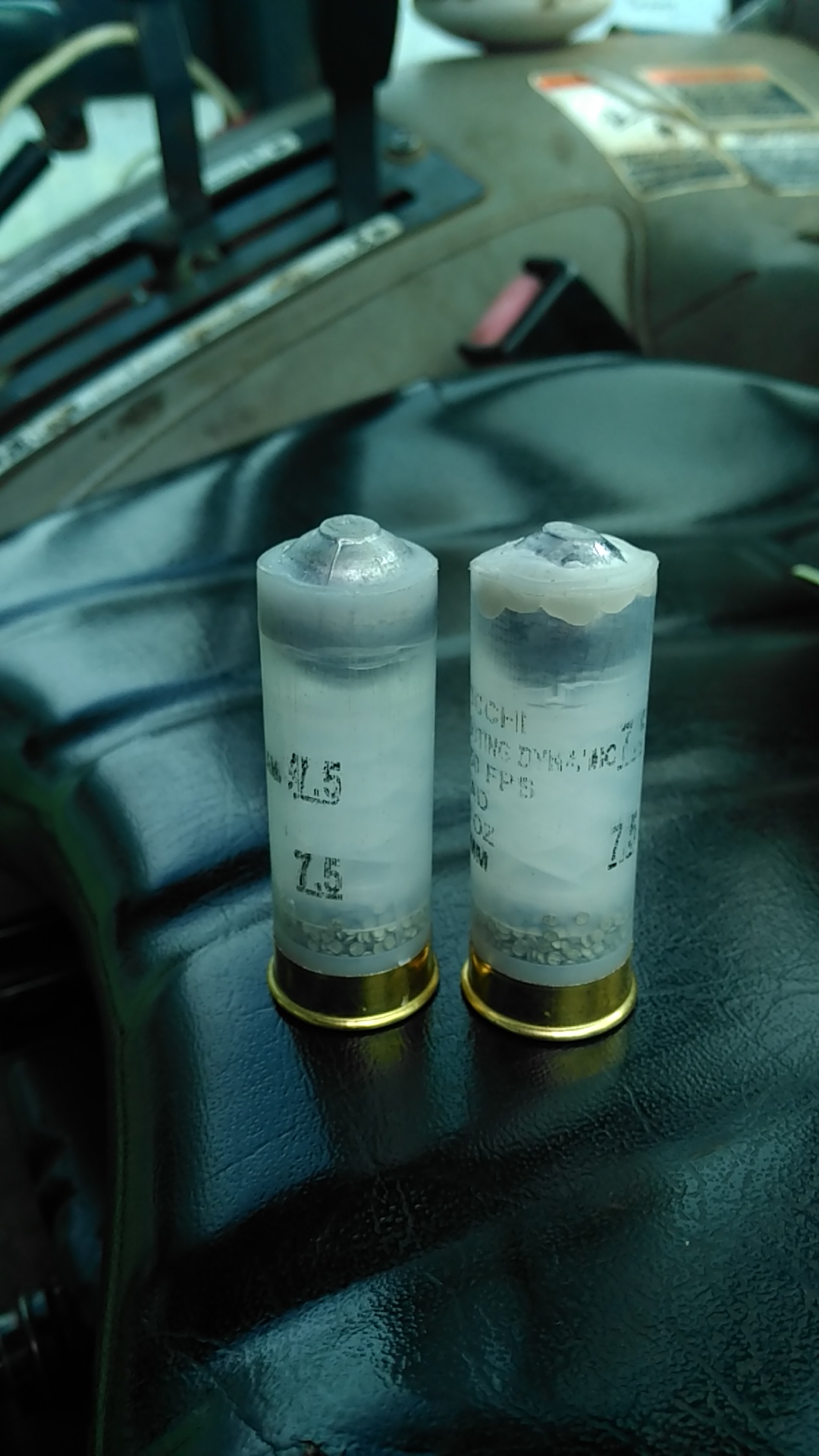

could try doing this. Fiocchi 24gm target loads,crimp cut off,shot dumped,petals cut off wad,.725 RB seated,sealed with candle wax. Simple and easy. Seems to shoot nicely so far.

The wax blows off as it leaves the muzzle so it won't affect flight.

Depends on how you do the wax. You can see the difference between these 2. The one on the left I dribbled the wax around the edge then heated the ball with a mini gas torch until the wax melted in around the ball. The one on the right I just dribbled the wax around the edge and left it. The right ones wax is already starting to crack and come loose a little but the other one is still neat and solid

Bear in mind my RB loads are close to 1⅓oz so really they should be replacing heavier shot loads,but they don't have a lot of bearing area and they are safe out of MY gun.
