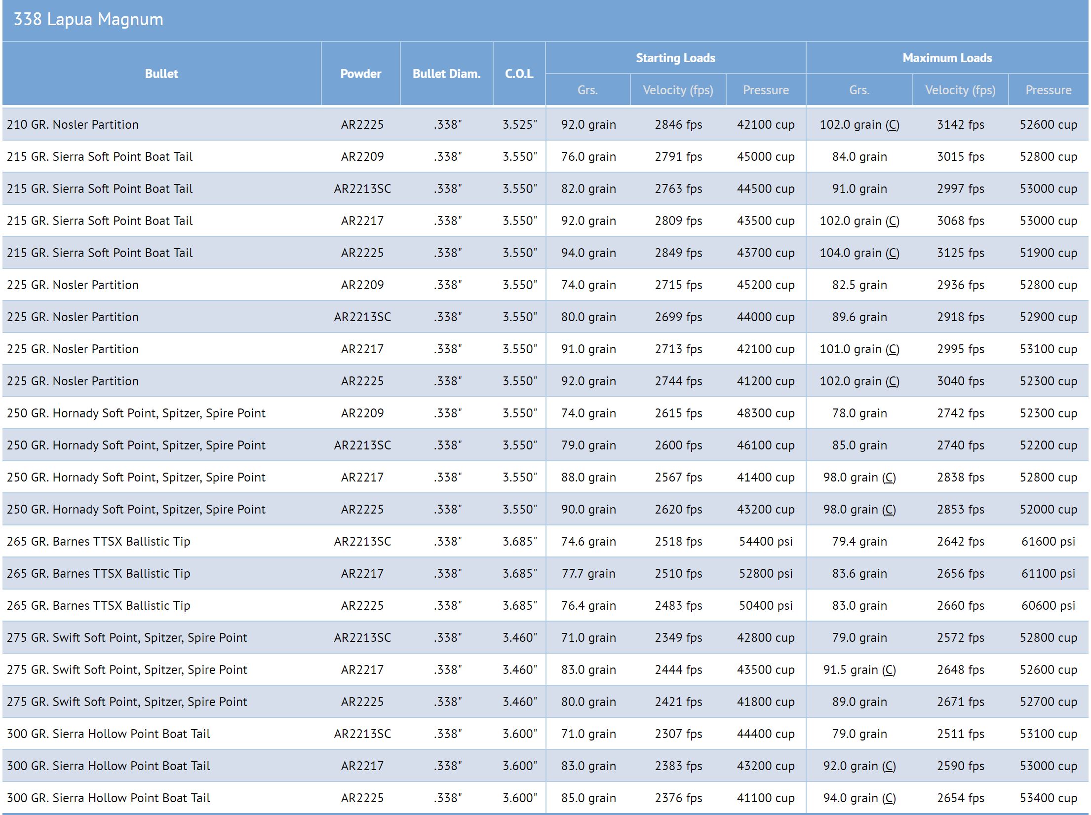

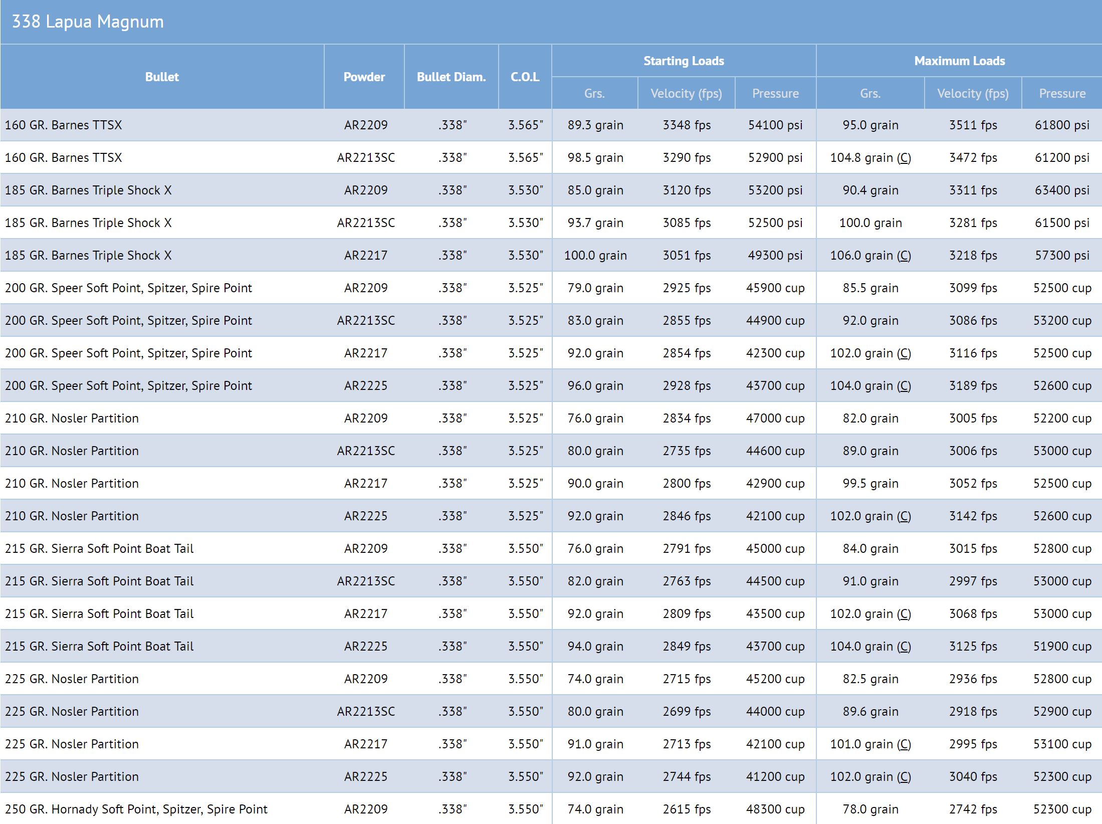

Looking at ADI's load data online, they recommend three powders - AR2213SC, AR2225, AR2217, with AR2209 being an option for lighter bullets up to 250gn.
The three seem to give similar velocity-for-pressure. AR2213SC is more efficient using about 5% less powder, but AR2217 is usually compressed which might translate to better accuracy, although it might also mean hitting a volume limit (as I do in .30-06). AR2225 also gets compressed in some loadings. If you're chasing velocity try AR2217. If you want to be able to experiment with all bullet weights try AR2213SC. If you want to find the best powder try all three and do extensive testing.
ADI 338LM a.JPG (493.77 KiB) Viewed 8026 times
ADI 338LM b.JPG (508 KiB) Viewed 8026 times
