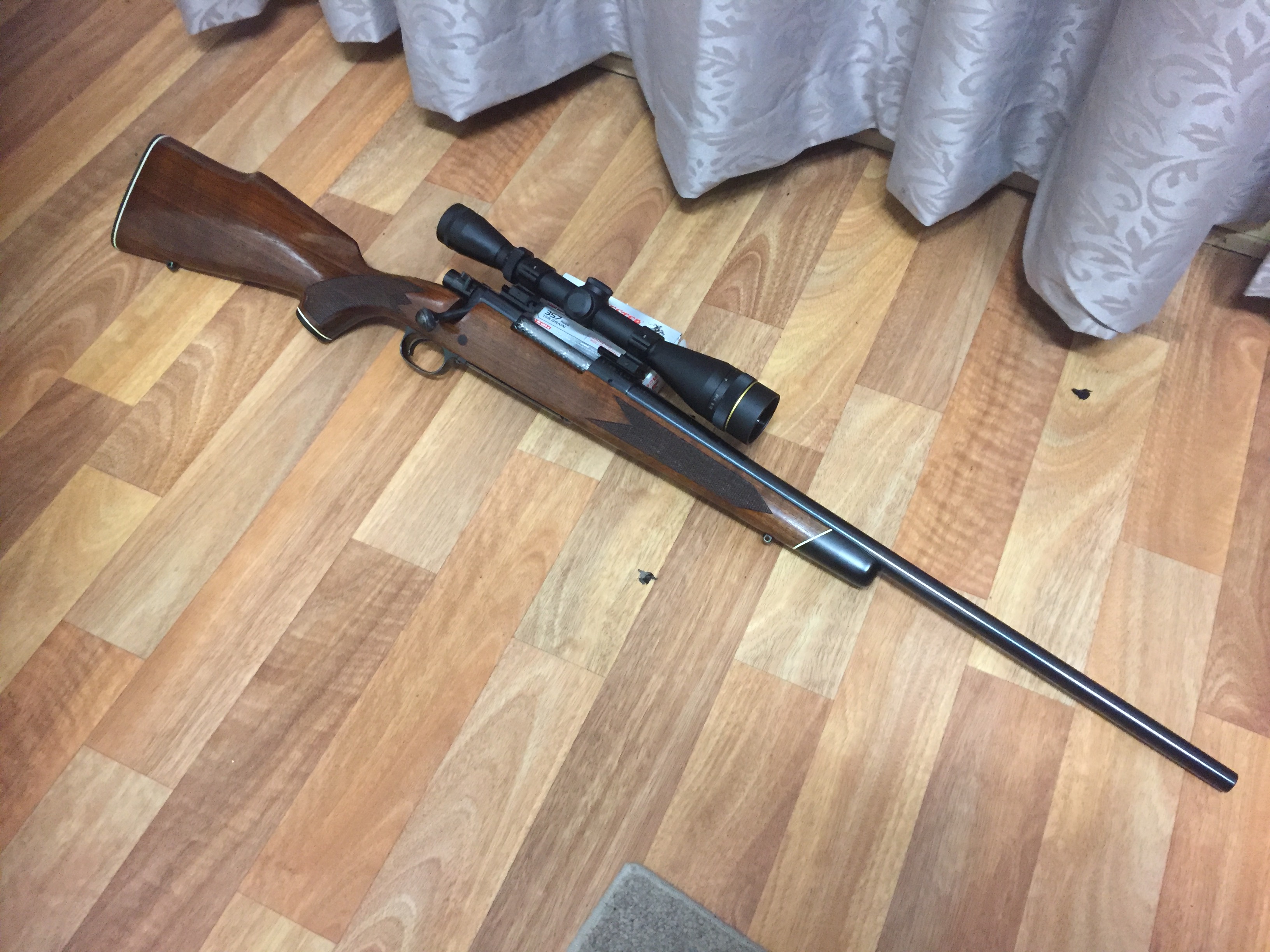

Post by bigrich » 22 Dec 2018, 8:26 pm
here's my baby. i bedded and floated it and tru oiled the stock while the barrel was being done
mod 70 222 xtr
