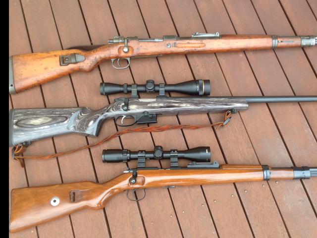

No bedding yet and it has a set trigger which is just beautiful . Heres the only pic I got, CZ in the middle .
