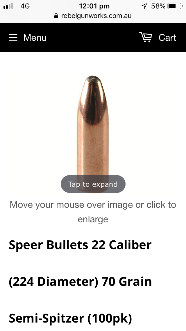

Hi all,
Has anyone here used or hunted with a 70 gr speer projectile in 223?
Im working on a small/medium pig/goat round and this one looks like a puncher (see attachment).
Its $33/100 rounds.
I plan on loading with ar2206 and i have a howa 1500 24” sporter with 1 in 9 twist.
Any comment on accuracy and weight retention etc of this projectile appreciated.
Potatoes

Post by Potatoes » 17 Mar 2019, 11:10 pm
GQshayne wrote:From what I have read about the .223, when loading for 60gn projectiles and upwards, 2208 gets mentioned a lot as being suitable.
SCJ429 wrote:The choice for heavy pills in a 223 is between 2206h and 2208. I use 2208 with 80 grain projectiles and it works very well.
Nice call about the ar2208 guys. I gave it a try with ladder test from 23.5 to 25.5 grains. Best was 24.5gr at just a shade under 0.4 MOAat 100 yards. My usual shooting before that was with hornady TAP 60 gr Vmax ($135/200 factory ammo) and i couldnt get sub MOA with that and was usually closer to 2MOA, so i didnt think .4 was even possible with my firearm/caffeine intake/prison shank inspired front rest. I guss now ill just use the leftover TAP ammo to season the barrel after cleaning, tee up a hunt, and then fire up the charcoal grill.
