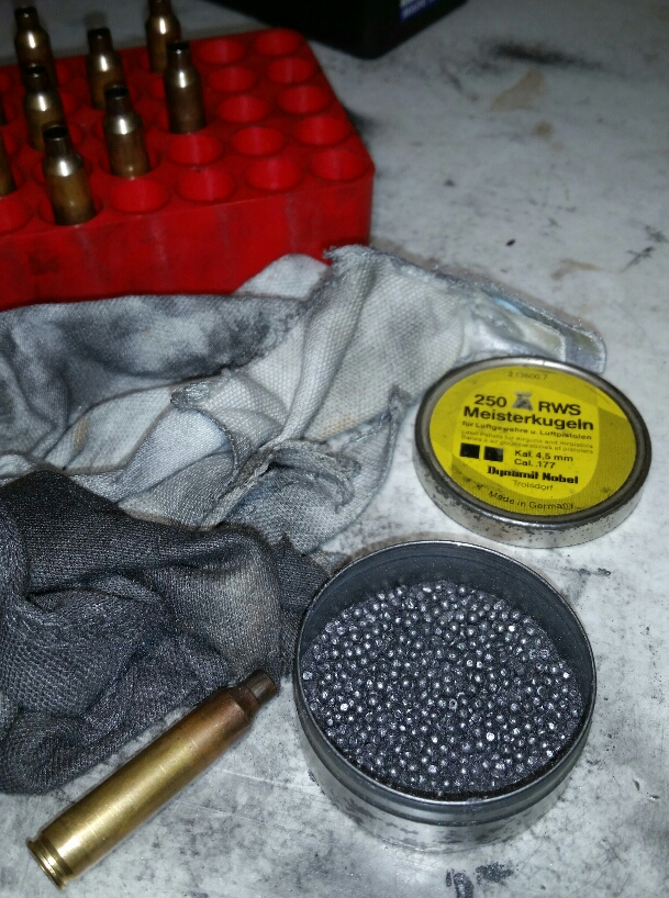

Post by Stix » 30 Apr 2019, 8:35 pm
I prefer it shallow, though i guess you could cut the specimen jar down....
Mine is an old air rifle pellet tin from another lifetime when i could see out of my eyes well enough to shoot...
I like the shot just deep enough to do a neck, no more...
204 case for comparison...
2019-04-30 19.57.42.jpg (449.64 KiB) Viewed 6889 times
