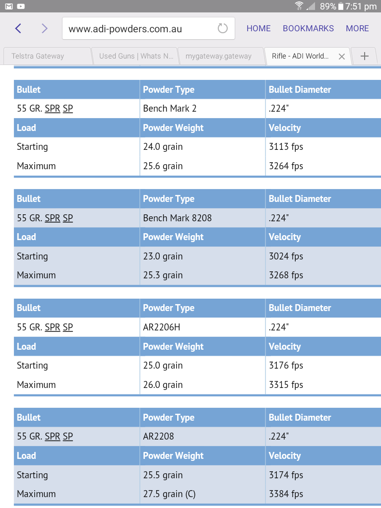

Work up from 23.5 to 25.5gr AR2206H looking for pressure signs (which I doubt there'll be any in this range). 26gr if you're feeling adventurous :drinks:

Post by Strikey » 23 Apr 2019, 7:59 pm
Use the data for Speer Soft Points, its the weight of the projectile not the brand name you need :thumbsup:

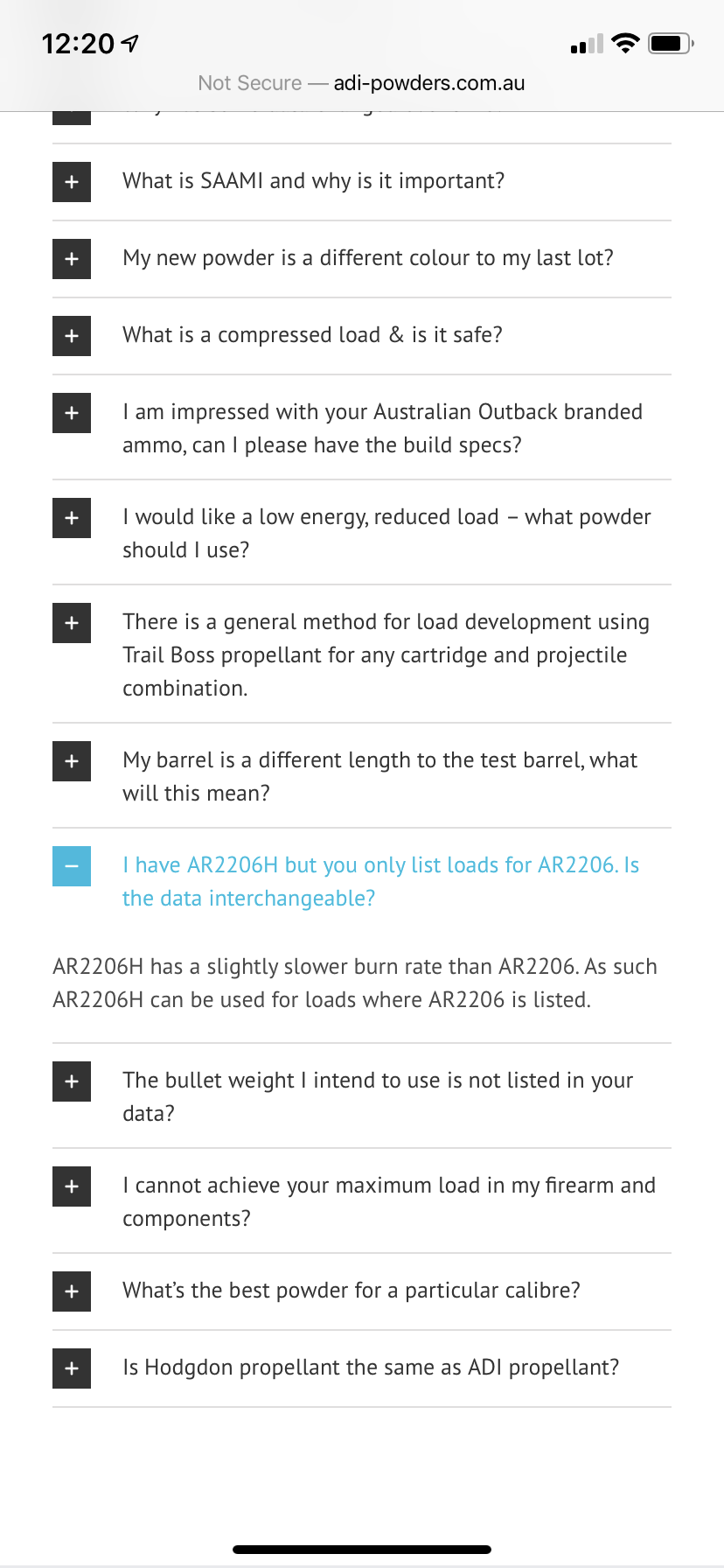

Post by JimTom » 23 Apr 2019, 8:23 pm
Jon79 wrote:Well have decided to get off my backside and get the last few things I need to start reloading, going to be reloading mainly .223 but also 243 & 308... picked up some cheap 55gr Sierra super roo gameking projectiles for $139 per 1,000 and the dies I was missing so will have a play around on the weekend
Was looking up the ADI load data to find a starting point for the 223 but also bought the Nick Harvey 10th edition manual but was disappointed that he doesn't list any load data for AR2206H for the 55gr projectiles
This is off the FAQ page on the ADI website.
Hope it helps.

he has both AR2206 & AR2206H listed under other projectile weights, the only difference seems to be you use slightly more AR2206H

well started off at 25gr and went up to 26.5gr, found my spot at 26gr which came in at 0.344 for 5 shots at 100m (which I was bloody happy with).... 26.5 was the next best but still nowhere near the 26gr loads...…….hopefully the 26gr rounds weren't a fluke

Post by SCJ429 » 06 May 2019, 7:47 pm
Nice work, that is awesome. Follow it up with reshooting that load and loads either side of 26 to see where the node extends to.
