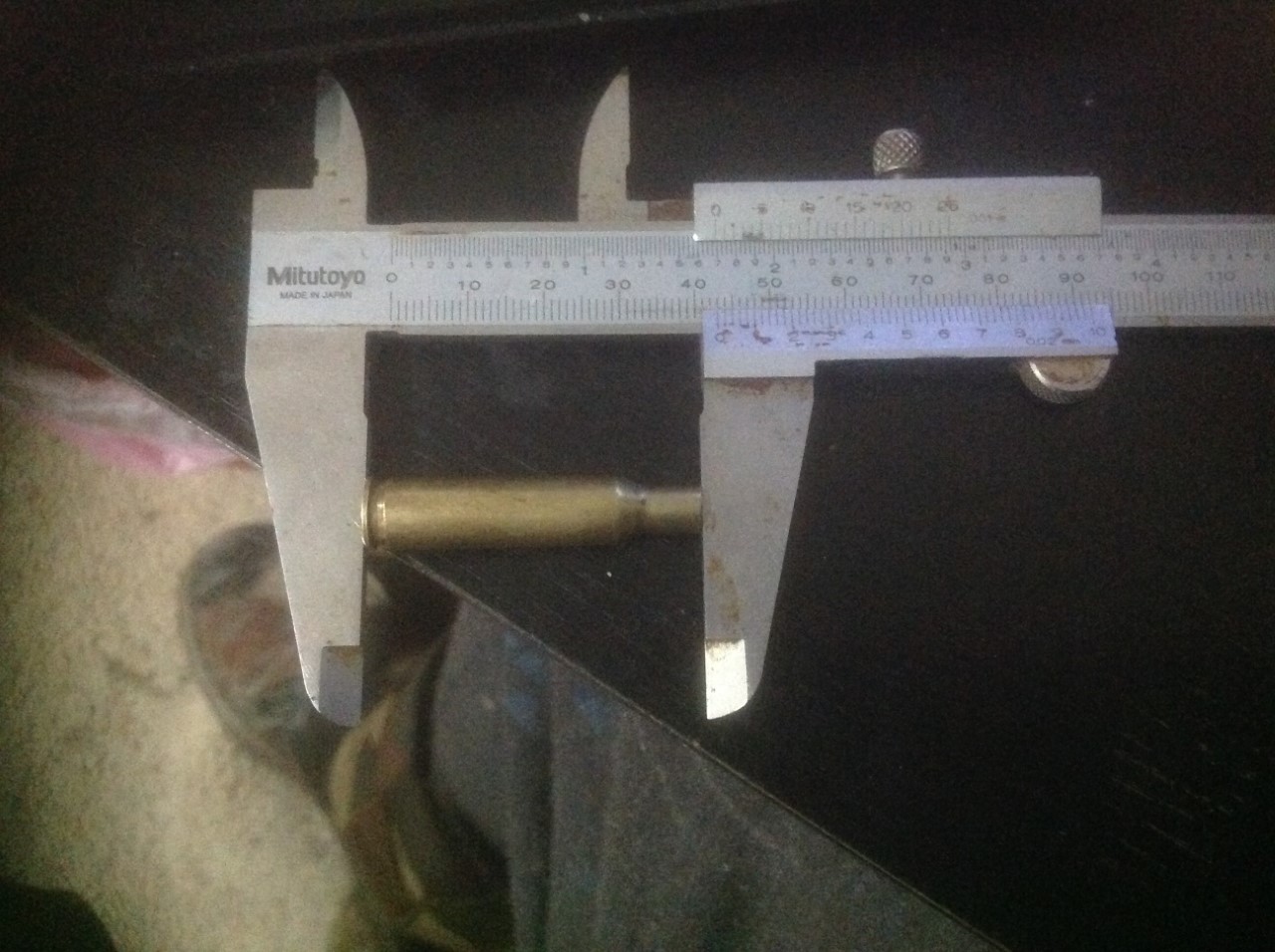

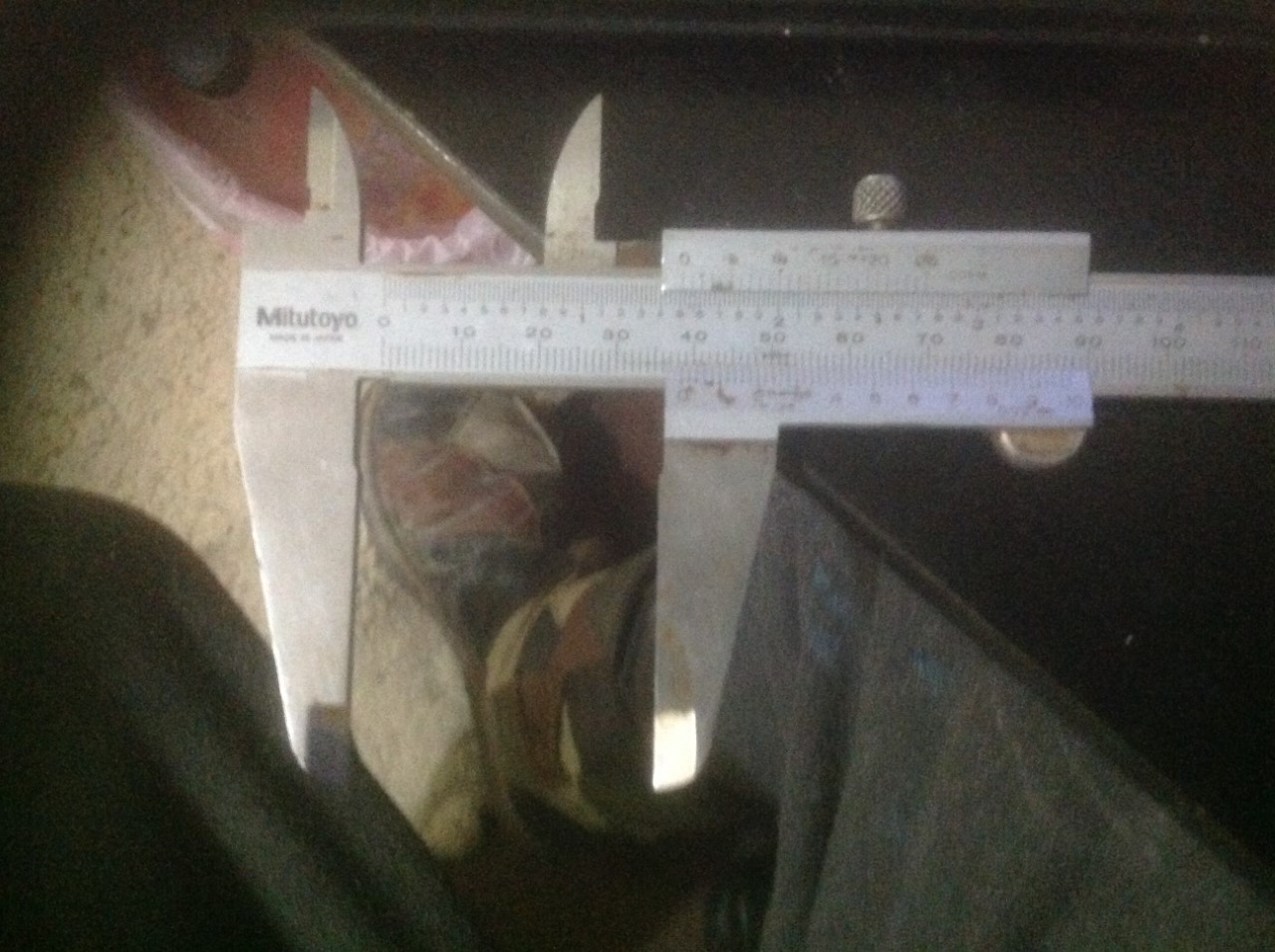

Post by duncan61 » 09 Jun 2019, 9:04 pm
Out of curiosity I have taken some rough measurements of a .222 case it is about 38.5 mm from neck to internal base and 43 mm overall so plenty of brass to mill out the primer pocket to large rifle.Why would you want to :D :D :D
