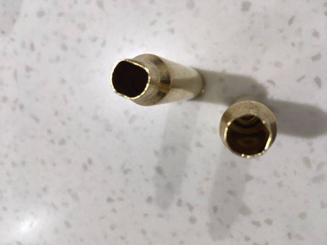

Bought 50 Winchester 300wm cases and was going to check size / length with the lee length gauge that goes inside the neck...but the first handful out of the pack look like this and there is no way the length gauge can be used...is this normal?? All other brass I’ve bought new - has not looked anything like this...???

I've bought once-fired Winchester and it's pretty good.
I've bought new Winchester brass in at least two cartridges and both are crap. I would not recommend to anybody to buy new Winchester brass. If you want Win brass, buy factory ammo and shoot it.

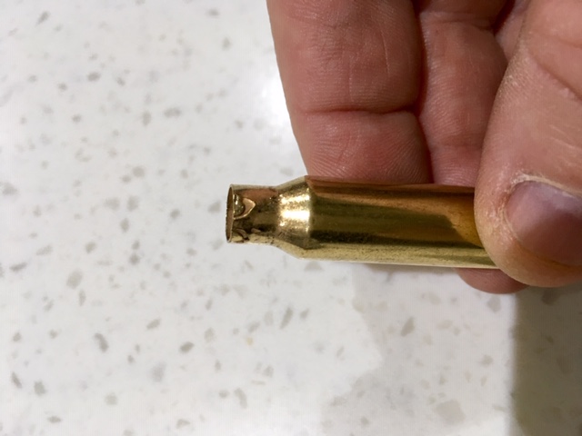

Slightly dented mouths like that second pic is not unusual in any brand that I have bought. It happens during a bit of rough handling at the end of the process. For those of you that have shot Auto loaders, some rifles would eject the brass so violently the mouths would be dented, so it happens and is not a big deal. Just run it through a sizing die and load it.

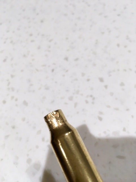

The other two pics are a different matter. Just plain out poor QC. I would take it back and I am sure there will be no questions asked about a refund.

Winchester is generally at the cheaper end of unfired brass and is packed loosely in bags, which doesn't help with dented or distorted necks.
Easily fixed by running the expander ball through all of them before doing anything else.
The production defect is unfortunate but if you have been reloading for long enough with various brands of brass you will notice they happen in just about all brands.
By the looks of it you can probably load and fire it safely.
These kinds of cosmetic defects are less likely in the more expensive brands, but they still happen, so you pay your money and take your chances.

When I get brass I run it through an expander mandrel to iron out the necks and to relieve a bit of the neck tension. New brass usually comes with too much neck tension. Trim your brass after it has been fired.

Junk the top case. Haven't seen one like that before.
The other two will go round when resized with an expander ball. Normal for entry level bulk brass. It headspaces on the belt so fine for first firing.

Some of these necks have boogey globs of excess brass on them...

the worst thing I have found is the little splits they can have in batches because of being crimped but you trim that out
that is embarrassing that a brand will let them cases out the door with there name on them, no quality control at all
I have seen cases like the 1st and 3rd photo before but only in factory loaded ammo from winchester
even the 2nd picture with dented necks has ripples in the mouths from over tumbling, very cheapo brass
