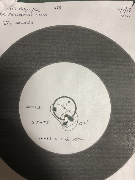

Load 1 (Israeli K98)
HR 180gr .312 projectile sized to .311
Hornady gas check
CBC fireformed brass
AR2206H powder / 26, 27, 28, 29, 30, 32gr x 5 each
C.O.L 2.57"
Results:
27gr - 1.1" (4 shots in 0.4")
28gr - 2.52"
29gr - 1.25"
30gr - 1.85"
32gr - 1.82"

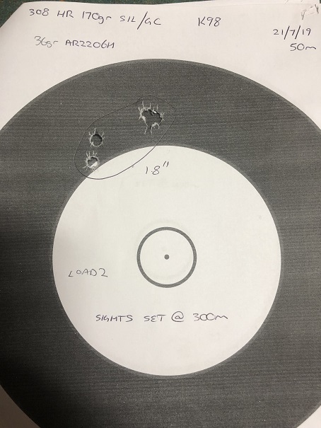

Load 2 (Israeli K98) This is an extension of last weeks load with the aim to find a higher velocity load
HR 170gr .308 SIL projectile
Hornady gas check
Lapua neck sized brass (light crimp)
AR2206H powder 30, 32, 34, 36gr x 5 each
C.O.L - 2.71"
Results:
30gr - 1.73"
32gr - 1.9"
34gr - 1.75"
36" - 1.8" (3 shots in the same hole)

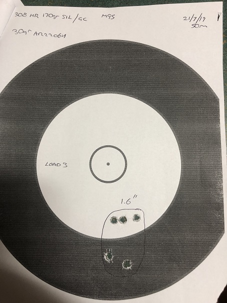

Load 3 (m95 Spanish carbine)
Hornady gas check
Federal neck sized brass (Light crimp)
AR2206H powder 26, 27, 28, 29, 30 , 32, 34gr x 5 each
C.O.L - 2.771"
Results:
26gr -3.04"
27gr - 2.47"
28gr - 2.76"
29gr - 2.35"
30gr - 1.6"
32gr - 2.73"
34gr - 3.16"

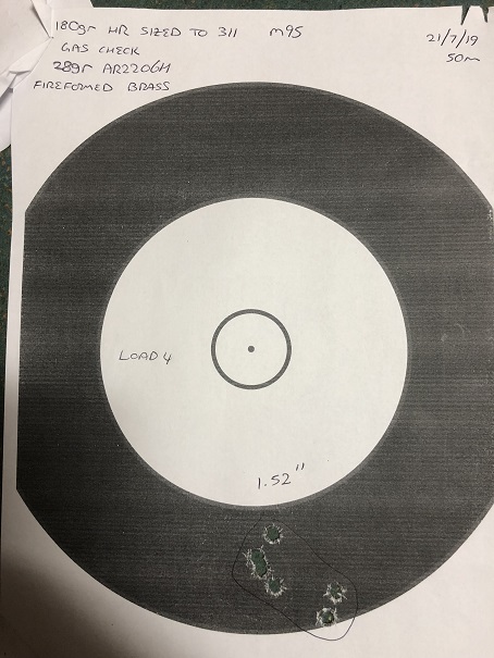

Load 4 (m95 Spanish carbine)
HR 180gr projectile sized to .311
Hornady gas check
Lapua fire formed brass (light crimp)
AR2206H 27, 28, 29gr x 5 each
C.O.L - 2.726"
Results:
27gr - 1.65"
28gr - 1.52" (six shots on target as I mistakenly fired one from the 29gr load)
29gr - 1.89"
Summary:
The K98 is definitely getting better results than the m95, but that is consistent with the better accuracy with jacketed rounds also.
The K98 will shoot both Hawkesbury River projectiles, whereas the m95 favours the oversized projectile.
All of my loads are printing groups now with the gas check installed, whereas without the gas check, I was lucky to get rounds on target.
The lower velocity / lighter charge seems to be the accuracy load for both rifles with either projectile, but a faster load may still prove to be more useful for what I need with an accepted accuracy loss.
I need to reload more of the .308 36gr loads for the K98, taking extra care with my shooting technique. I think this is going to be the higher velocity load for this rifle (more range time).
