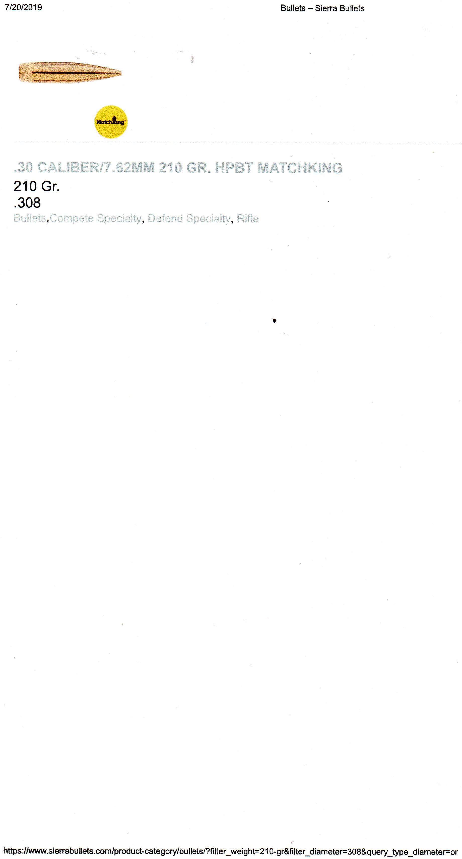

I would like to share my thoughts on this.I bought a 7mm Rem Mag to do long distance target shooting and of the 5000 plus roos I harvested over 13 years I probably did less than 100 with the 7mm.For hunting and culling I loaded 100 gn Sierra game kings that do about 3300 fps but I would not try to shoot at a range at 500-600.My target load is 168gn Matchkings with 64gn 2213sc which will do 1000 metres easy.I am assuming you are playing with your new Howa in 300 Win mag and I feel you are under feeding it.Spend a few dollars and get 210 Matchkings and use the ADI data with 2209 62 gns looks to be a good start all this brass weighing and primer changing is not going to do poop if you are using a bullet that belongs in a 30/30.You got a big long range rifle feed it right and see what happens.With match grade ammo they should all be touching at 100.If you ever get to a long range shoot it is normally 2 sighters then 10 detail twice in one day.You will have a sore shoulder and cheek no matter who you are.You are putting 91 unleaded in your ferrari you goose
Re: How far do you go - b4 ruling out a projectile ?
Post by duncan61 » 20 Jul 2019, 10:30 pm
300 win mag.jpg (237.31 KiB) Viewed 4960 times
