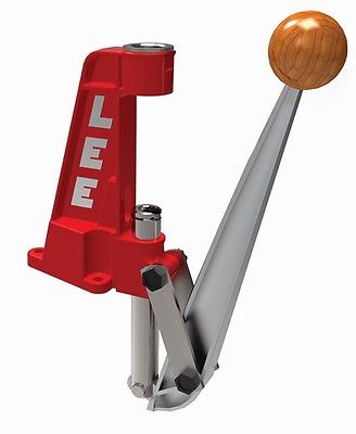

Post by Oldbloke » 01 Aug 2019, 9:43 pm
What about one of these?.
https://www.ebay.com.au/p/LEE-PRECISION ... 9003300442
Cheap as chips.
