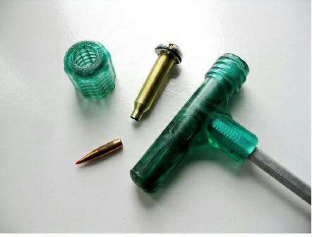

Thanks Stix, good advice. I'm using one of those hammer thingos (I just looked it up, they're called a "kinetic bullet puller") and I've looked at them afterwards with a strong magnifier and there looks to be just some very minor surface scratches on the bullet after removing them. Regarding cases I now have a full length resizing die so will be testing all the cases simply by putting into the chamber and only neck size them unless there's any resistance on the bolt when I remove them from the chamber. Then I'll measure for case trimming. Some of these cases I bought in the 1970's but they haven't had a lot of rounds through them.
kinetic bullet puller.JPG (23.33 KiB) Viewed 7741 times

When using that hammer, put that collet that holds the bullet away and use the Shell Holder for that cartridge. It just makes it so much easier to use. The hammer is more solid as it tightens down on the shell holder and the case fits the shell holder well and doesn't fall out.
