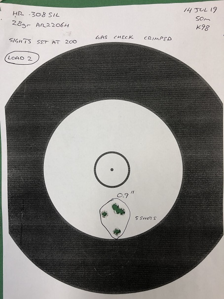

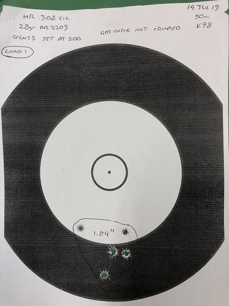

This weekend I have finally had some success. I wanted to learn a bit more about how Gas Checks are installed and what affect they have. Lets just say the results were fairly conclusive, my loads were never going to have a chance without the GC installed.
In2anity, you were spot on mate.
"So I put it down to the lack of a gas check; as you mentioned the driving band is quite minimal on that particular projectile, so I speculated there was probably a fair degree of gas-cutting happening (without the GC). Basically, I reckon they're designed to have a GC"
With all my previous load development, the only load where I got something close to a decent group was with 28gr of AR2206H powder, but was not repeatable. So I used 28gr again across this weekends load development, but threw in AR2209 powder also. All targets fired at 50m, using only my Israeli Mauser K98
Load 1
Hawkesbury River 170gr .308 SIL powder coated hard cast projectile
Hornady gas check (not sized or crimped)
28gr AR2209
COL 2.7"
Result: 1.84" group with open sights set on 200m, POI still 2.5" low, and slight unburnt powder coming out the case on extraction.
Hornady gas check (crimped on using Lee FC die)
28gr AR2206H
COL 2.7"
Result: 0.9" group with open sights set on 200m, POI still 1.75" low

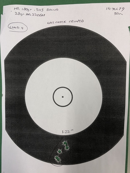

Load 4
Hawkesbury River 180gr .3115 powder coated hard cast projectile
28gr AR2206H
COL 2.48"
Result: 1.22" group with open sights set on 200m, POI still 3.5" low
Summary:
[*]results are positive for both types of projectile in this rifle (lets see if those groups are repeatable though)
Requires a sizing die to crimp / swage the gas checks correctly onto the projectile to prevent issues with neck bulging and loss of neck tension
I suspect that the .3115 projectiles maybe too big for the throat of this rifle and keen to see if the Lee sizing die will help
Will keep working on my sizing and loading techniques as it was a bit shabby till now.

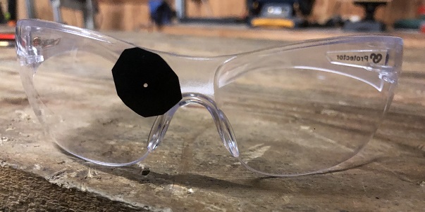

Thanks bladeracer. Yeah just standard Kar98 sights, but I have a little helper with my eyesight not as it once was.
Standard pinhole eye test like the optometrist will do to see if you just have old eyes or maybe something more serious. I find I have trouble focussing on the rear sight notch, but the pinhole brings that into clear focus along with the foresight and the target. You need to experiment with the size of the hole, but for me, the smaller the hole, the better my eye can focus, but less light comes in during low light conditions.
They are just cheap safety glasses and I used a ground off nail to make a flat edged punch. Just put some electrical tape onto a plastic lid and punch a clean edge hole. Then just adjust on the safety glasses so it lines up with your normal line of sight of your dominant shooting eye.

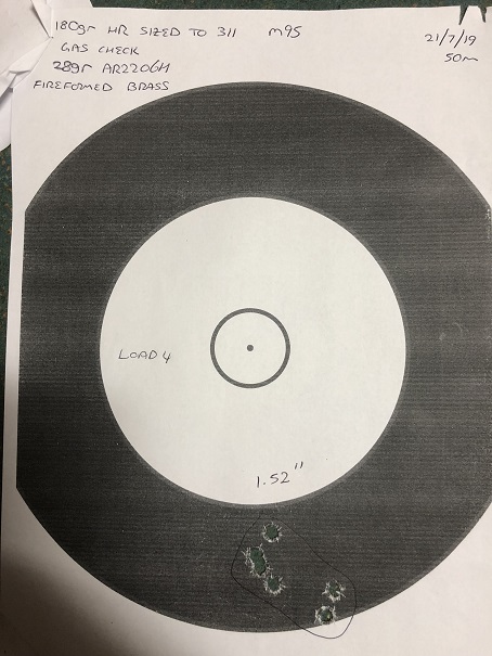

Post by goldiexxxx » 21 Jul 2019, 8:46 pm
I loaded another four loads for this weekend's testing with the aim of further testing both types of projectiles in both my m1895 Spanish Cavalry Carbine and my Israeli K98. All loads were fired at 50m with sights set higher.
I now have a .311 lee sizing die to resize the .312 Hawkesbury River projectiles down a bit and also install the gas checks. All of my loads using this projectile have been resized to .311 and gas checks installed. I also wanted to try pushing the velocity up on the Hawkesbury River .308 SIL projectile just to see where it would go before becoming unstable. Load 1 & 2 were fired in the K98 and Load 3 & 4 were for the m95 Spaniard.
Load 1 (Israeli K98)
HR 180gr .312 projectile sized to .311

Load 2 (Israeli K98) This is an extension of last weeks load with the aim to find a higher velocity load
HR 170gr .308 SIL projectile
Hornady gas check
Lapua neck sized brass (light crimp)
AR2206H powder 30, 32, 34, 36gr x 5 each
C.O.L - 2.71"
Results:
30gr - 1.73"
32gr - 1.9"
34gr - 1.75"
36" - 1.8" (3 shots in the same hole)

Load 4 (m95 Spanish carbine)
HR 180gr projectile sized to .311
Hornady gas check
Lapua fire formed brass (light crimp)
AR2206H 27, 28, 29gr x 5 each
C.O.L - 2.726"
Results:
27gr - 1.65"
28gr - 1.52" (six shots on target as I mistakenly fired one from the 29gr load)
29gr - 1.89"
Summary:
The K98 is definitely getting better results than the m95, but that is consistent with the better accuracy with jacketed rounds also.
The K98 will shoot both Hawkesbury River projectiles, whereas the m95 favours the oversized projectile.
All of my loads are printing groups now with the gas check installed, whereas without the gas check, I was lucky to get rounds on target.
The lower velocity / lighter charge seems to be the accuracy load for both rifles with either projectile, but a faster load may still prove to be more useful for what I need with an accepted accuracy loss.
I need to reload more of the .308 36gr loads for the K98, taking extra care with my shooting technique. I think this is going to be the higher velocity load for this rifle (more range time).
