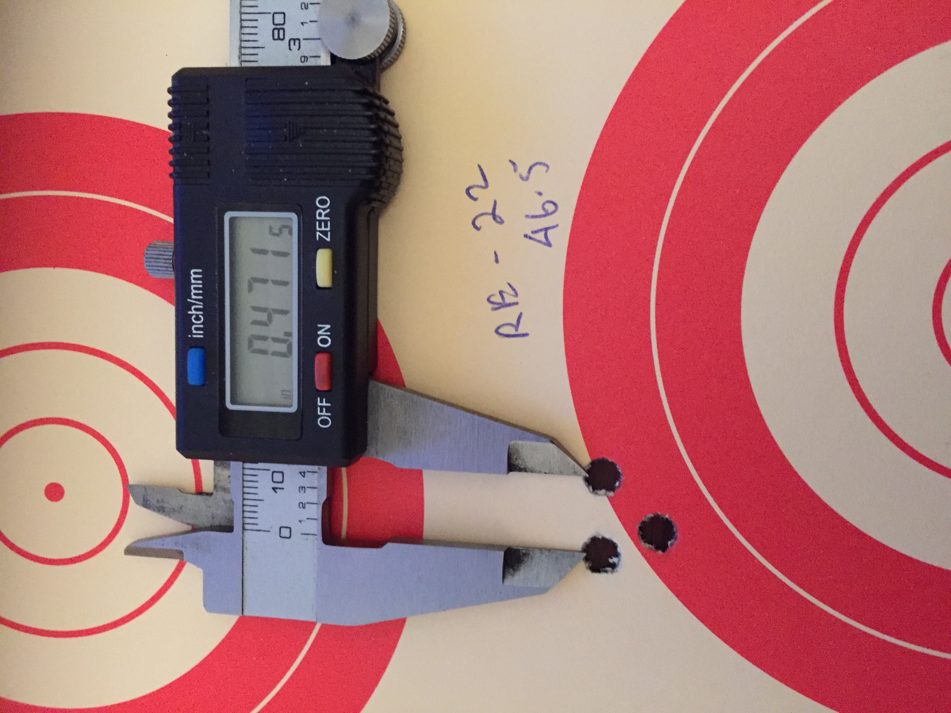

Post by bigrich » 30 Oct 2019, 4:36 pm
Well fellas, here’s some results from some 243 load testing I did last Saturday. It was a bit windy, not optimum conditions. The 2208 was so-so, I was surprised at the RE22 results. 87 gn vmax was used in all loads, COL was 2.650”
Not a bad result. 100 yards. Could improve after a few more rounds down the barrel as it’s only had about 40 rounds down it so far

Post by Stix » 30 Oct 2019, 5:31 pm
bigrich wrote:Well fellas, here’s some results from some 243 load testing I did last Saturday. It was a bit windy, not optimum conditions. The 2208 was so-so, I was surprised at the RE22 results. 87 gn vmax was used in all loads, COL was 2.650”
BR..."some results"...
Mate thats one target...(a good target mind you... :thumbsup: )
Im really keen to see what you produced in the order it was produced--not just the best--there is nothing wrong with real life results if they're not great...
Ill be loading & shooting for a 243 one day & keen to see how you progress from a brand new barrel mate... :thumbsup:
And im sure there are a lot of guys looking that would get value out of a write up for the entire saga of finding the sweet spot... :thumbsup:

that was the best load so far stix, i didn't want to bore anyone with a blow by blow account. just the highlights ...... :lol:
i don't seem to be having much luck with the sierra hpbt 85 gn projectiles yet the COL measures 2.625 in my barrel . i've tried 2.602 loads and they sprayed a bit . on the old barrel with the same measured COL these were more accurate than the hornady . i'm not expecting target rifle results, but i want to set this up as a portable rifle that can shoot out to 300 with a degree of accuracy . i'm not intending to use this rifle for deer or pigs ,more roos, goats on down in terms of game weight . bit more reach than my 222 :D . the 87 vmax will do the job,( i know someone who's taken deer with them ) but the sierra is a more flexable projectile reportedly. i'll try 10 thou off the lands and 30 thou as well and see how i go . i've a sneaking suspicion the accuracy may improve with another hundred or so rounds on the barrel as well. :thumbsup:

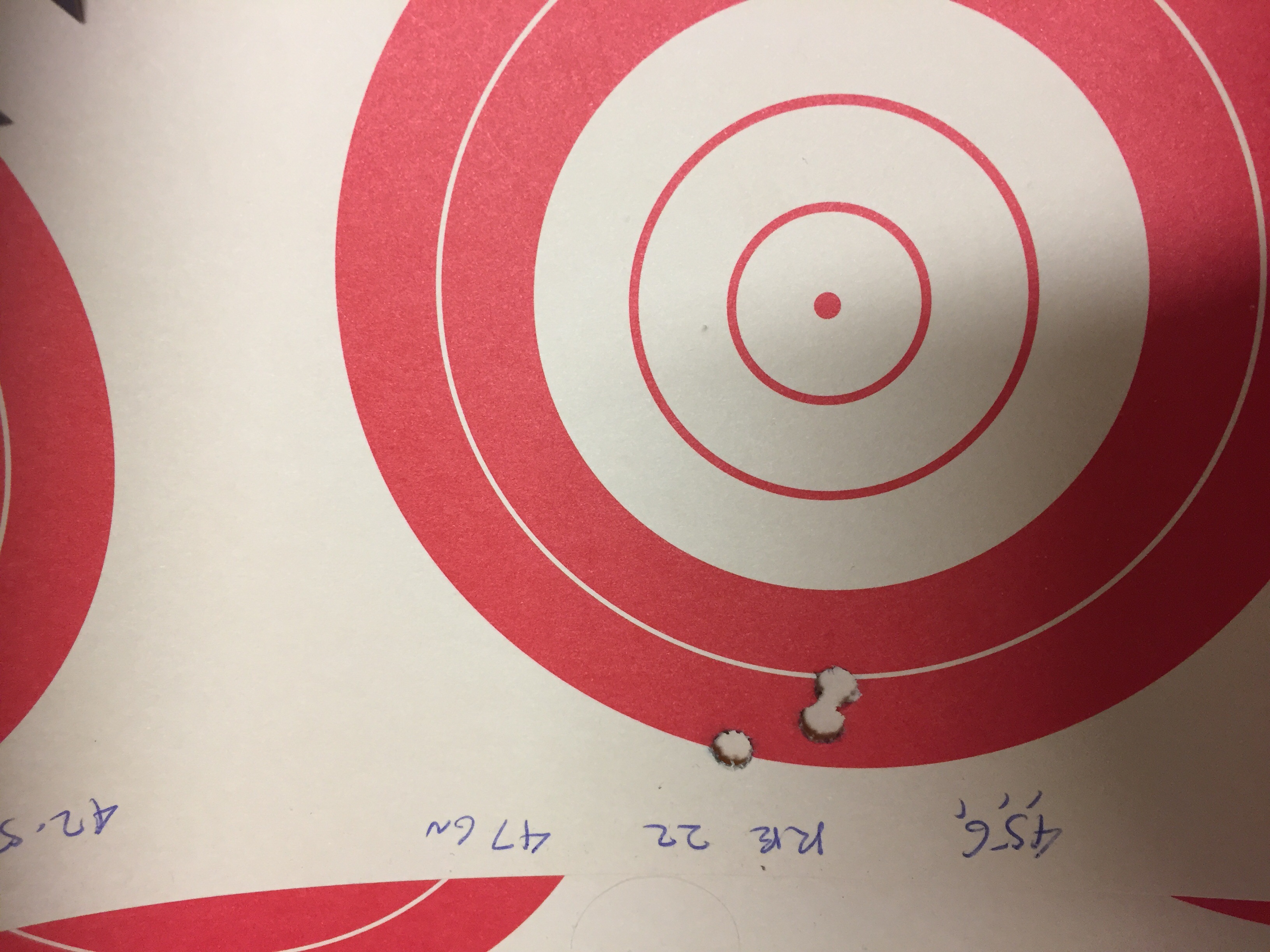

Post by bigrich » 02 Nov 2019, 6:55 pm
Well, I tested another batch of loads, using ar2209 and RE22 . The RE22 put the second bullet just about through the first hole, the third going slightly out to the right. Those first two shots are the most important in a hunting rifle for me . The 2209 group is using 43.5 gn, I’m going to creep up to 44gn and see if there’s more in it. Aside from playing with COL , I’ve just about got my 87vmax load sorted. Sierra 85 HPBT would be my preferred all round projectile, but they seem fussy to get to shoot well. Has anyone tried 90gb Nosler BT’s in 243 at all ? Thanks to all who offered advice, that’s why I like being a part of this forum :thumbsup:
43.5 gn of ar2209 I’ll creep up a little more on this
RE22, 47 gn .reckon I might have pulled the third shot. I’m going to try this load again
Posts: 6518
Re: favorite 243 loads
Post by bigrich » 02 Nov 2019, 6:58 pm
bloody phones :x ! no i wasn't standing on my head when i shot them :lol: you guys get the general idea ;)

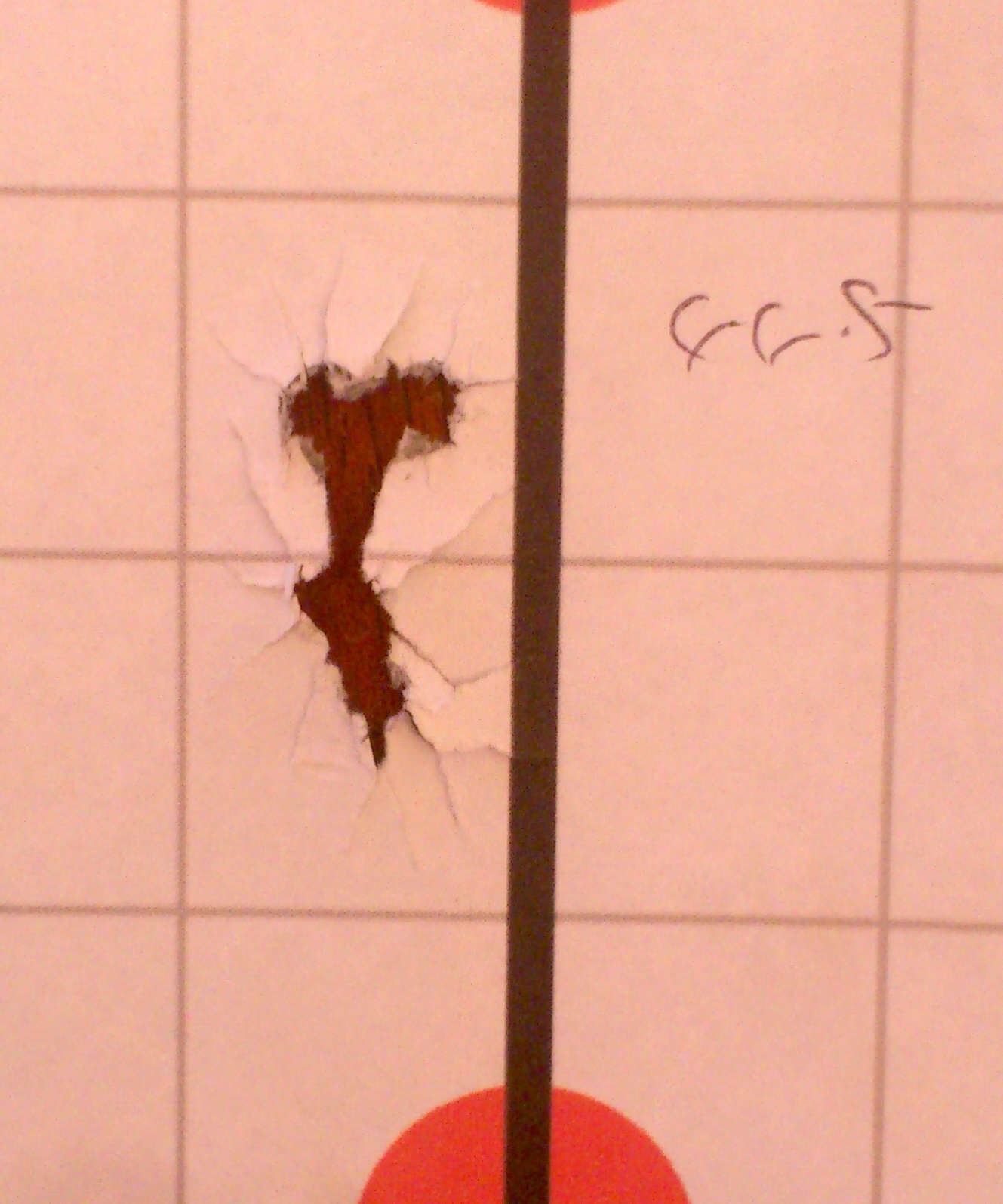

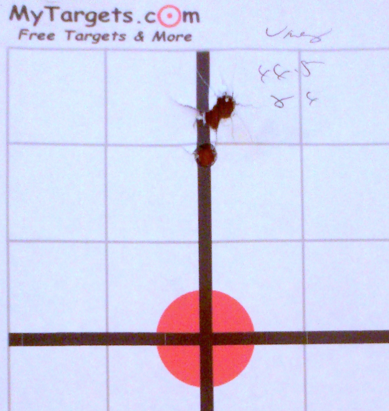

Post by Flyer » 09 Dec 2019, 2:52 am
44.5gr of 2209 with the 87gr V-max. Here are two 4-shot groups. Chronoed at 3277fps (average) out of a 22.5" barrel. This was my favourite load for the Sako.
