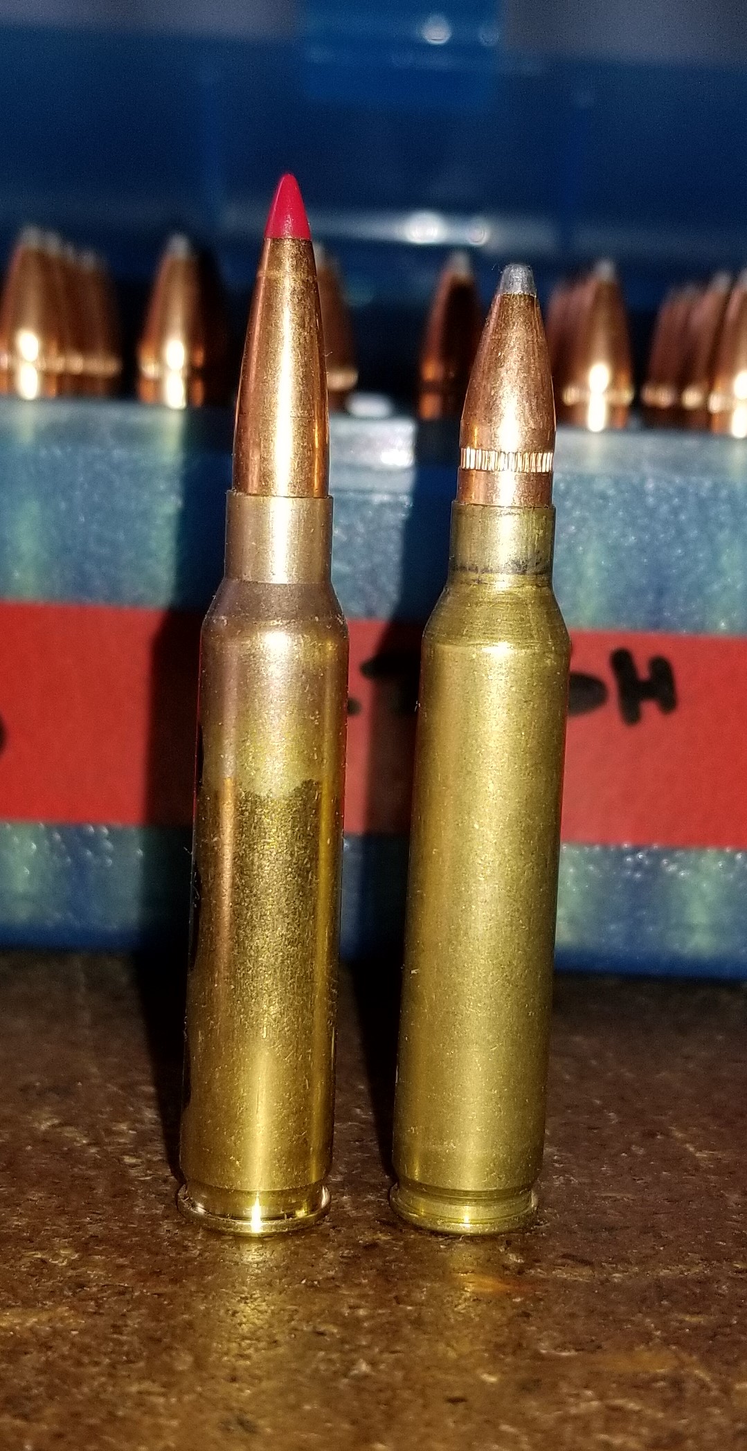

When I started reloading I noticed my howa stainless sporter barreled 223 had a longer throat then my wife's ruger precision 223. At the time I was only loading for the ruger so didn't think to much about it.
But now I'm loading super roo's for the howa.
The distance to the lands with the super roo's is 1.956" measured to the ogive.
At the moment I'm seating the projectiles at 1.860" to the ogive which gives me a COL of 2.240.
Magazine length isn't a drama but I felt like I didn't want the projectile any further out after reading that you want the projectile seated at least .223 into the neck. But that gives me pretty much 100thou of jump?
Then I bought my howa blued varmint 308 and have discovered the same thing. With 150gr seirra gamekings the distance to the lands is 2.298 measured to the ogive.
The COL in the ADI book is 2.703 which gives me 2.130 to the ogive.
What do you blokes think of this and just how far out is to far out when seating?

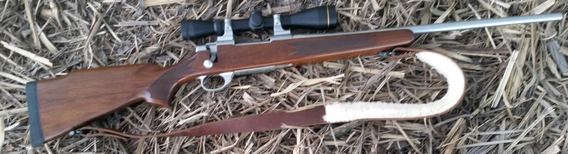

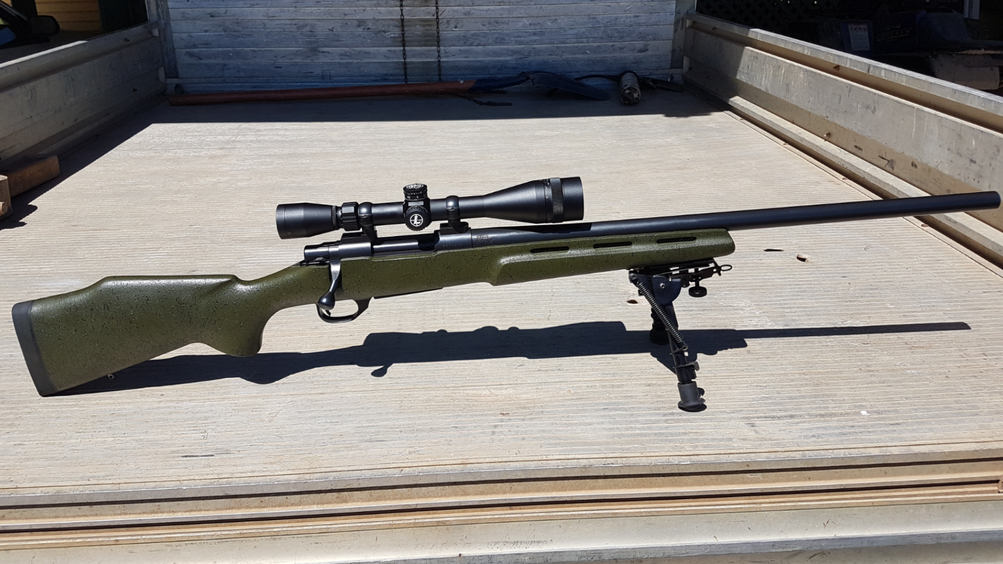

The 223 is just in the timber howa stock and the 308 is in the bell and carlson, I've bedded the 308.
I bloody love the set up of the 223, it just feels perfect. Weights a bloody tonne though.
I find it interesting that, that timber stock has a purpose made spot that contacts the barrel, where as if you buy the same barrelled action with any other stock it's freefloated...
