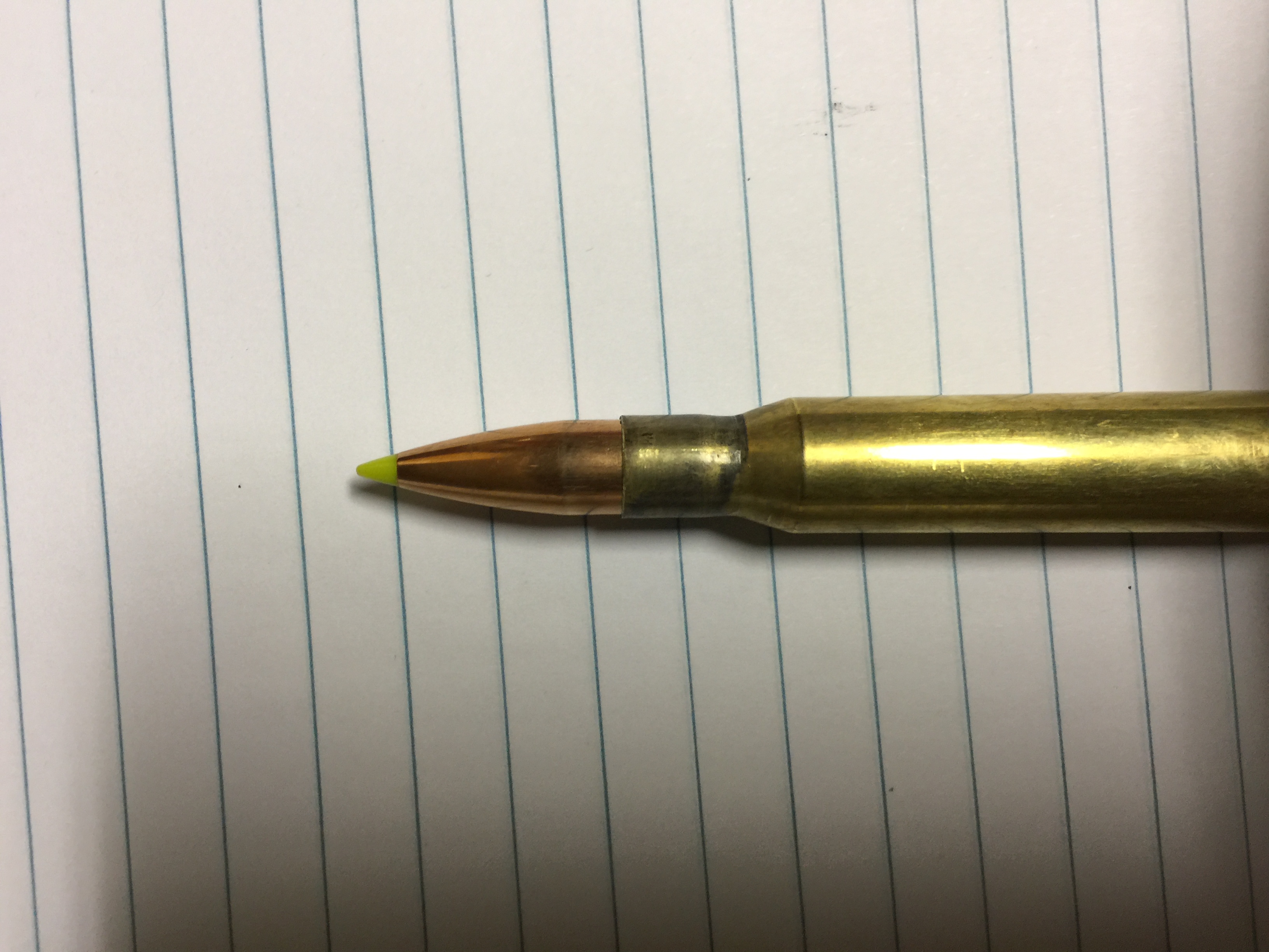

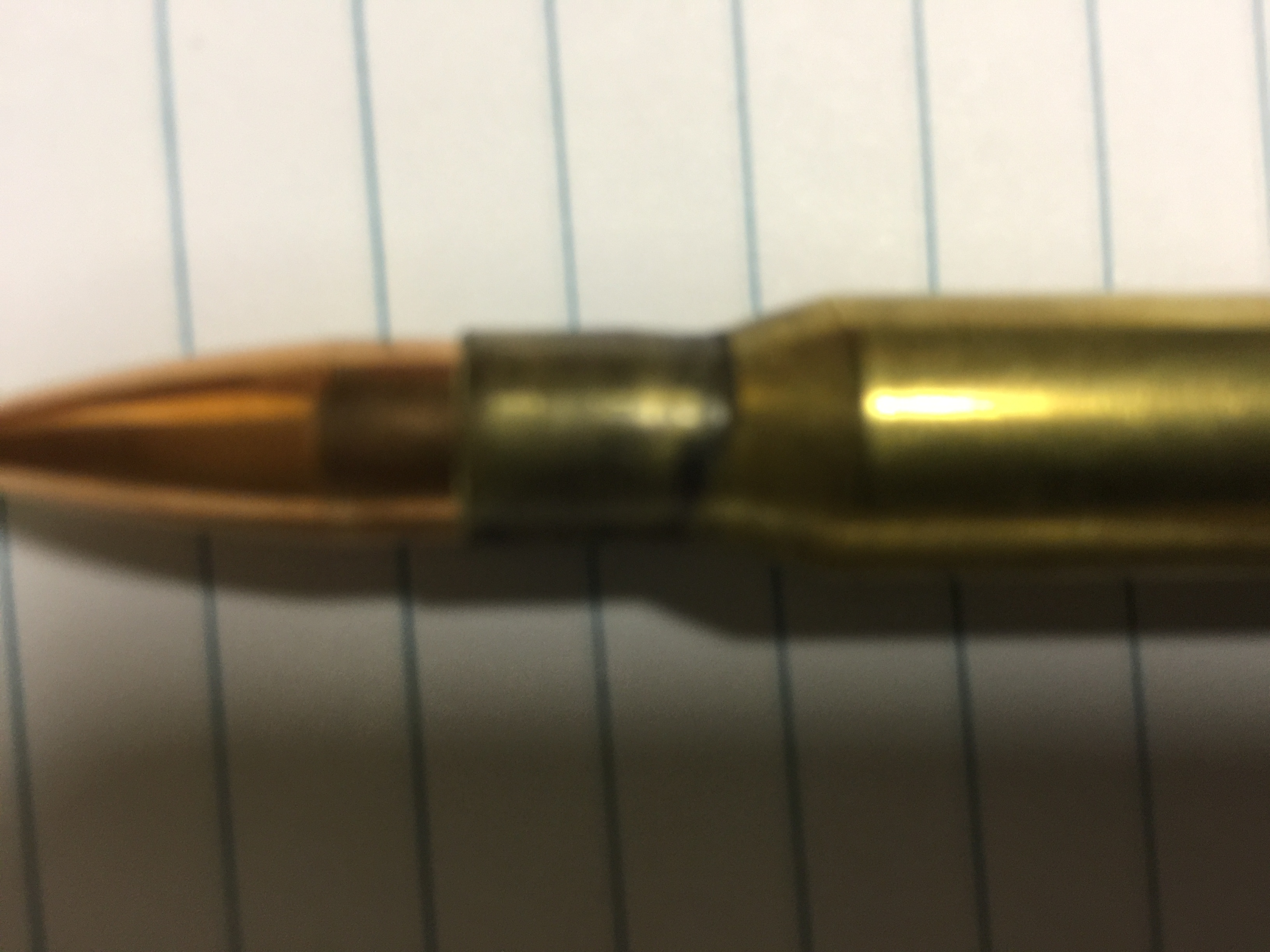

So, wasn’t paying attention and placing too much pressure on lee neck due and holes in once fired 06 brass started coming out, looking a bit...narrow. I measured internal and was within a mm so neck sized about 50.
Anyway, I seated a few but something caught my eye.
At the base of the neck, there remains a small indentation - obviously from making the hole a fraction smaller than I should have - it’s something I’ve never really seen (or noticed) before.
When seating, I noted that the pressures to seat were up but not massively - I usually / previously have followed MM S advice re just a fraction tighter than finger tight but these are a fraction more than that.
Is there any danger in shooting or continuing to load these necked lap cases ? Over pressure ?

Tassie Tiger. The necks should just expand back to normal size upon firing. The photo is not too clear but it does appear as though the extra pressure to seat the projectile has caused visible run-out on the loaded round. If you have some equipment to check run-out test to see if has some or just roll the round on a nice flat surface and see if the bullet runs true with the case. Regards Malcolm.

Cheers M - I think the hole in the case ended up being about .5mm smaller diameter than usual.
I took the de capping pin out of die, as I had zoned out and primed cases before necksizing - inadvertently making hole too small from neck sizing - as it looks like top of pin is sized for 308. (Wonder if same process might wirk with wife?)
The neck bulge is internal and just above shoulder and isn’t pronounced - I’m wondering if it might chamber slightly different as a result - and my concern is over pressure.
I only loaded up about 9 like this before stopping but I have 50 cases with smaller than ideal mouths.
Maybe I should re install pin, Re neck size against pin (.308) and pull the loads...it will ruin the primers but the brass is worth much more.

But what i see is that the top few mm of the case neck is buldgeing slightly? If that's your question, then it's fine, your neck is generally slightly smaller than the bullet diameter.to have tension. The projectile is seated not fully down so a part of the neck has stretched to accommodate the bullet. Maybe your neck tension is see high due to the pin not present (unsure). It will shoot.

Your spot on Z - I should have edited the pic with an arrow or two to show the nice little waist that I’ve inadvertently made.
So I guess the neck tension will be high on those loads - will that spike pressure? I’m close to max recommended as it is...

I would go with what you suggested TT. Write off the primers and resize the cases properly. Shooting them as they are is going to give you really poor results, so that is a waste in itself that would be much bigger than the primer cost.

Can you re-assemble your neck die with the de-capping pin/neck expander adjusted so that it doesn't de-prime?
Just run it in and out of the neck and it should be good to go. If you are worried about the 9 rounds that you have loaded up, just pull the bullets and do those as well.
I can't see any problems shooting those off as is, may just not shoot to the same point as "normal". :thumbsup:
