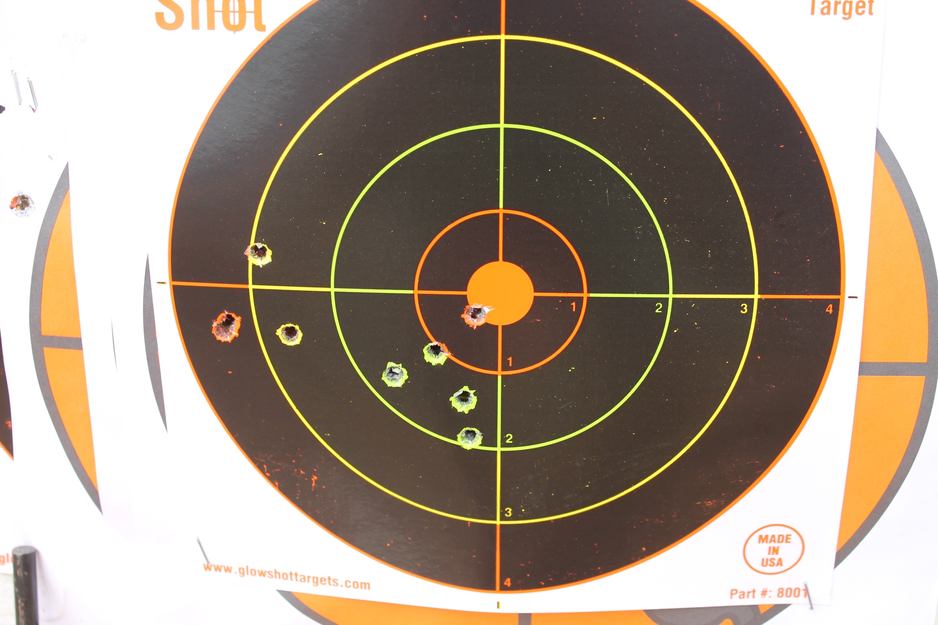

Howdy. A 303-25 has been on my wish list for many years. Finally bought one a few weeks ago. A No4 MkI Longbranch. Sportco barrel
Actually quite impressed with its performance. Better than i expected.

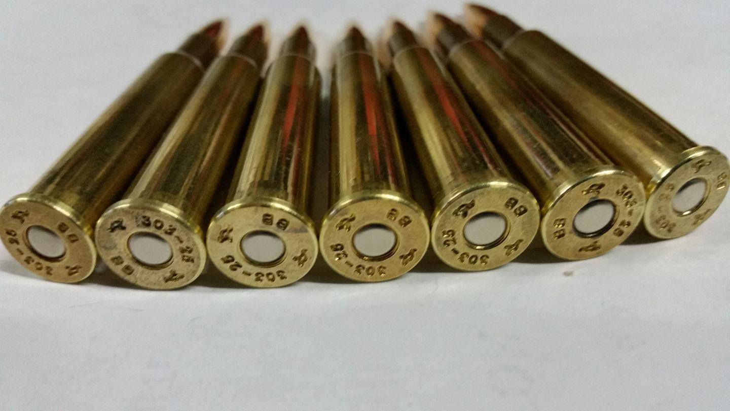

It came with some new Bertram brass (head stamped 303-25)
And I bought 50 S&B brass from Rebels that they size down themselves (head stamped 303).
The S&B needed heaps trimmed off after first fire.
Bought some 87gr Speer TNT HP (.257) to try and impressed, they will do me. AR2206H and CCI LR primers.
Bought a new set of Simplex master 303-25 dies and Simplex shell holder. Great dies. The Simplex shell holder did not want to co-operate with my Redding press or RCBS primer tool, so I bought a RCBS 303 shell holder, problem solved.
Also bought a Hornady .257 neck die which worked great today when I neck sized the S&B brass.
And as Lee does not make a 303-25 case trimmer, i bought a 257 Roberts case length gauge and trimmed it down a little to suit the 303-25 case length of 56.28mm (56.2mm min)
2 groups. Open sights around 85 meters. First time firing rifle. That'll do me.

Bertram Brass, correct head stamp
