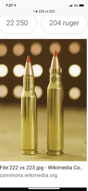

Here’s a pic headspace vastly different between the two
Posts: 4800
Re: Overloading the Powder
Post by Blr243 » 17 May 2020, 7:33 pm
When a 222 Sits against the bolt face in a223 chamber there is enough room at the front of the chamber for a fox to have a fight with a rabbit
Posts: 4800
Post by JimTom » 17 May 2020, 7:43 pm
Rimless cartridges headspace is measured from the shoulder. Headspace vastly different with the two cartridges.

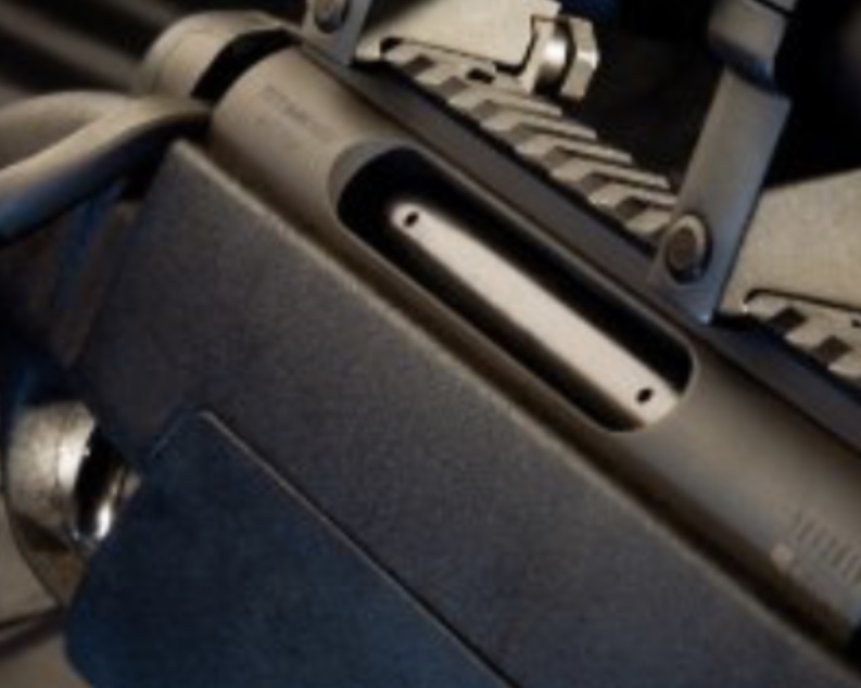

Don’t Most rifles have generally 3 x ports for blow back ?
Post by Blr243 » 18 May 2020, 12:45 pm
I have heard that sometimes or often there is some sort of safety porting system but don’t know a lot about it One of my fathers army mates told me that in Vietnam he found an enemy soldier dead in the bush from his own blown up rifle
Posts: 4800
Post by TassieTiger » 18 May 2020, 12:49 pm
Like this one
Post by Oldbloke » 18 May 2020, 3:20 pm
Yeh, usually halfway along the bolt directing down in to the mag. I think my M70 has one there.
Interestingly I just looked at the bolt in my Marlin XL.
It's just behind/under the locking lugs. A bit unusual.
