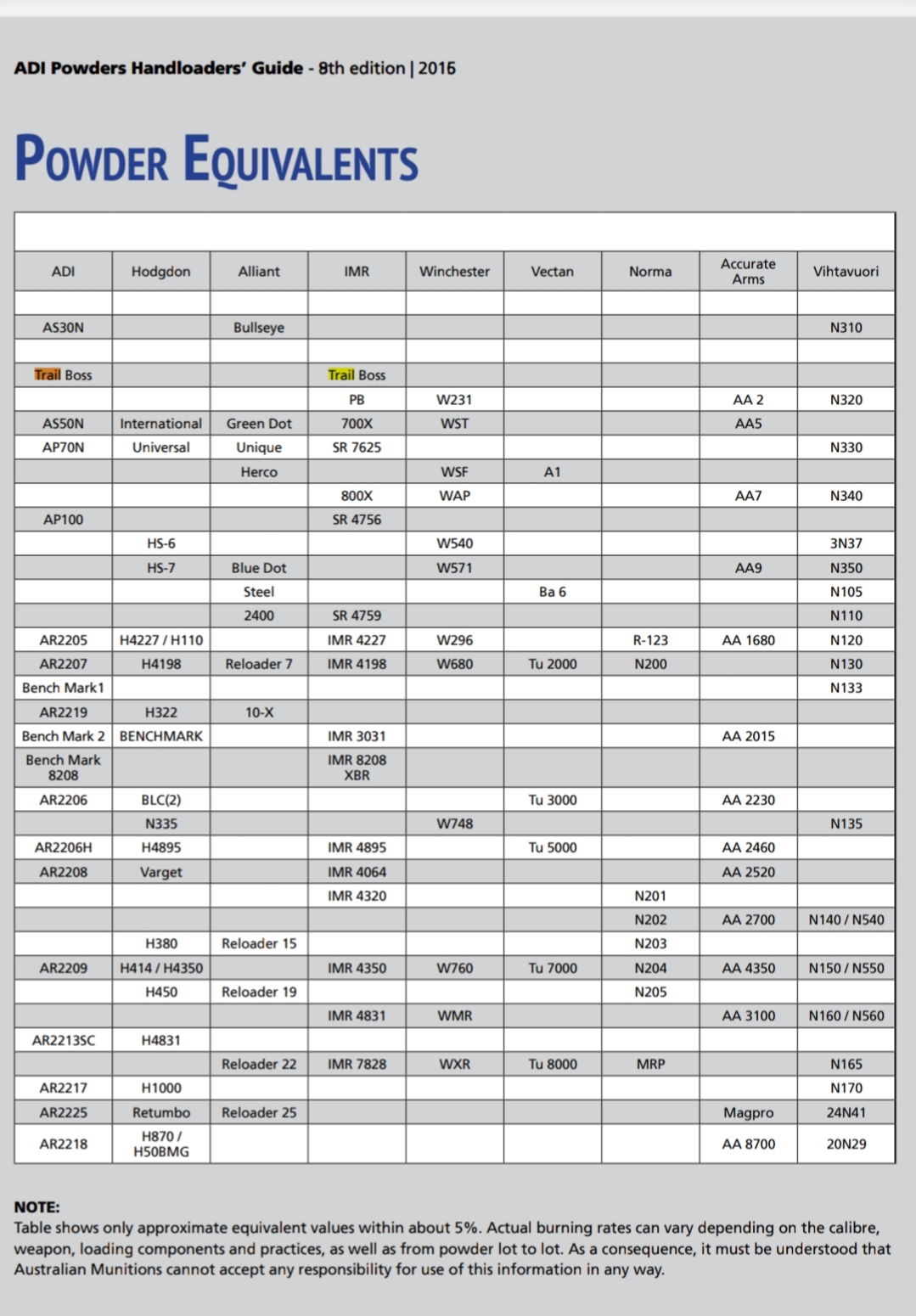

Buy some to work on a load for 12 gauge solid slugs

Post by Oldbloke » 26 May 2020, 3:20 pm
Why not an equivalent or an ADI powder?

Thanks Oldbloke -Ive seen the ADI table - I have been using AS50N until now but my reading of the table is that there is no ADI equivalent. I can get Blue Dot in Qld but cant find it here in Vic where I am staying for a while.

I'm using AS50n for my1oz lee solids. Goes bang
Why blue dot?

They list Blue Dot in their load data and thought I'd give it a go. Maybe I'm overthinking it. I get a 3 shot cloverleaf at 50m but lucky to hit paper at 100m
I'm using a HR Ultraslug in 12g. The slug/sabot weighs 500grains. Currently I use 19grains AS50N. I think I was getting better accuracy with roll crimp which I did at first but recently star crimps and accuracy has suffered.
How are your results?
I'm hoping the slugs will be good on Sambar - if I can get close enough :D

I'm also using 19 gr AS50n. Star crimp. 1oz lee slug.
Never checked on paper but a diner plate is in serious danger at 50yards. (Must do that) Yep my plan is deer also. A single 12g can be very versatile with the right ammo.
What sights have you fitted?
If accuracy is acceptable why change?

For me acceptable accuracy would be pie plate @100 yards. So thats why I'm wondering about different powder. If I can get that i'm happy. Yes sights are something I need to change - I have a red dot but the dot covers the target bull at 100. I plan to pull the Redfield 4-7x scope off my 243 and test it out when the ranges open.
