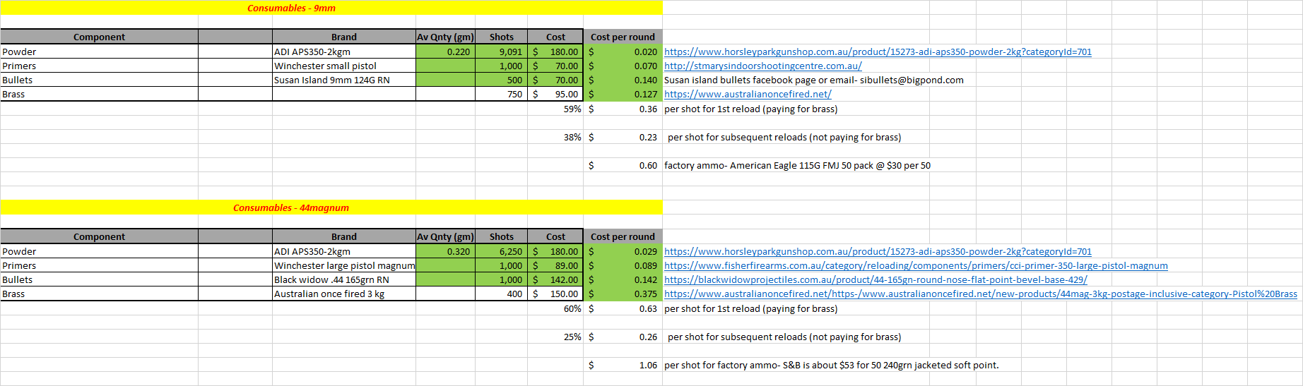

I recently bought a progressive reloading rig- mainly to reload 6.5Creedmoor. The salesman knows me well and he also knows that I am getting a 9mm soon. Being the good salesman that he is- he tried to sell me a set of 9mm dies too.
So I did the math to see if it was worth it and it is- I ran the numbers with the component costs for 9mm. Compared to a factory round, It costs 59% for a reload where you pay for once fired brass. It costs 38% for the next reloads with no brass cost. I bought the 9mm dies.......
I just did the same for 44Magnum- using South Australia components costs (except for powder- couldn't get a cost from a SA website- I used $180- should be close).
For 44Magnum, it is 60% with brass cost and 25% without!
All the numbers are below. I would estimate it would take the savings from about 1500 44 Magnum reloaded rounds to pay off a $650 investment in a reloading setup. Go nuts & HAPPY RELOADING!
Regards,
Jarhead
