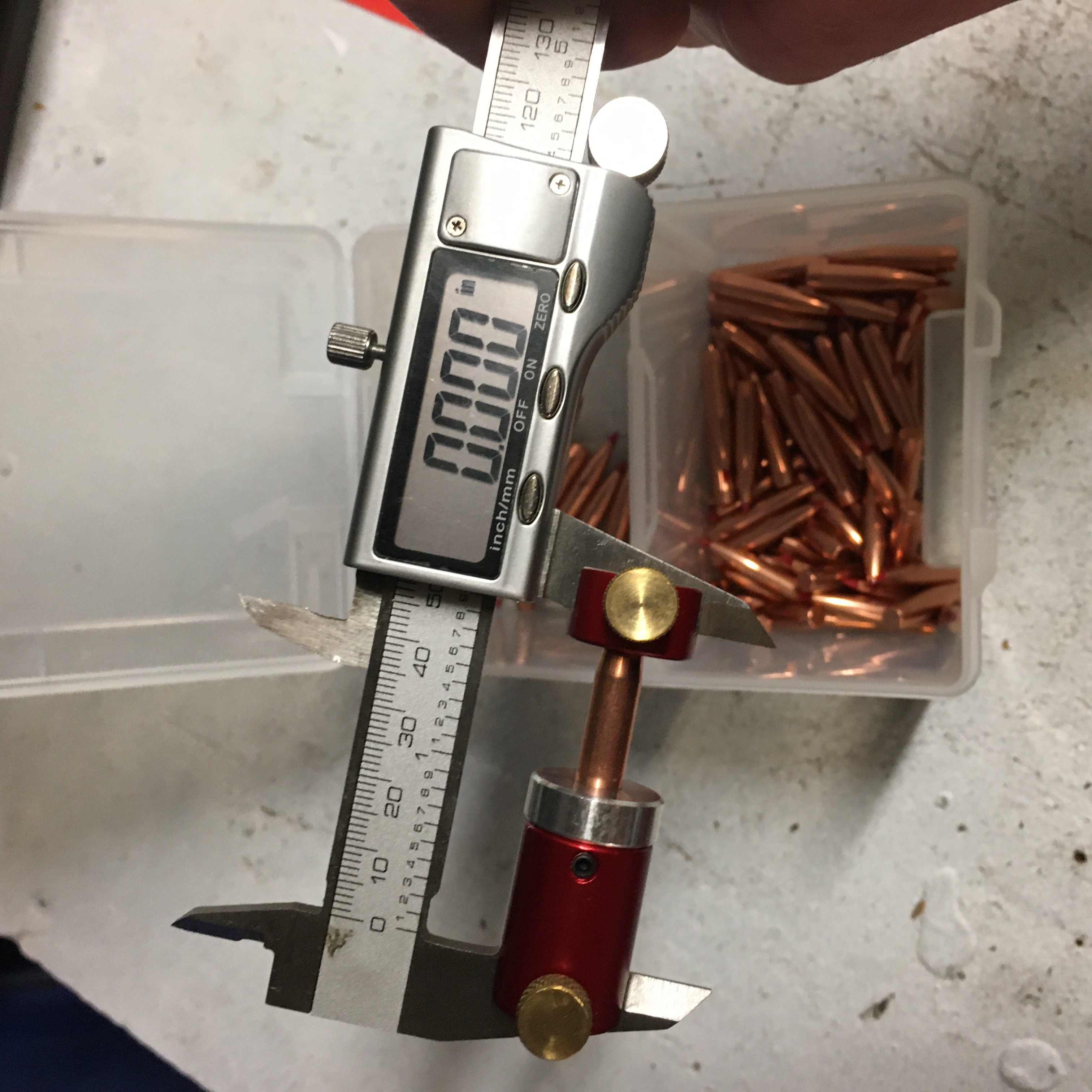

I have loaded 10 rounds, starting at 37grains of AR2209 and incrementing .5 grain up to 41.5. That is the range for a Hornady 140grain A-Max according to ADI load data. 140 grain ELD-M's so it should be similar to the A-Max load.
I am using 40.1 grains of 2209 with that 140g ELD 20thou off the lands- So starting at 37 grains on the lands sounds safe. Thanks for the advice!
SCJ429,
I have about 180 140grain ELD's ready to load in a bin- they are all from the same batch. I measured all of them base to ogive and the max delta I found was 1 thou. I am not seeing the same problem that you did. (I zero'd the verniers on the first one- it would be good if you could let me know if you are measuring differently....)
What bullets were they? What sort of delta did you see between rounds? Were they all from the same batch?
A colleague bought 1000 of these for $490 (!) from a reputable QLD dealer. They all came loose in ziplock bags. I missed that deal and bought some from a Sydney dealer for $58 per 100. I bought 1000 total and they came in boxes of 100 with the lot number on each box. I managed to get 2 lots, 4 boxes of one lot# and 6 of the other lot #. Did you get them in boxes or bags? My thinking is if they were bagged you may be getting the "floor sweepings"- which is why they cost so little.
