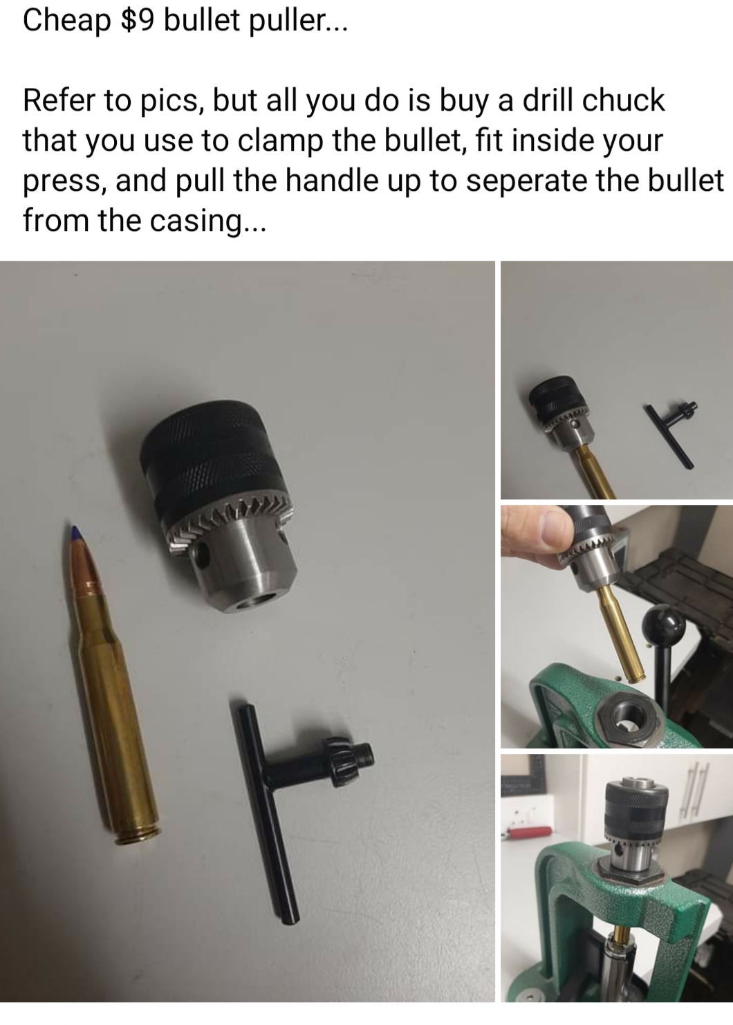

There is always this. Lol
0_Cheap bullet puller.jpg (405.04 KiB) Viewed 4341 times
Don't disagree with MM. Lol My RCBS does leave minor damage.
