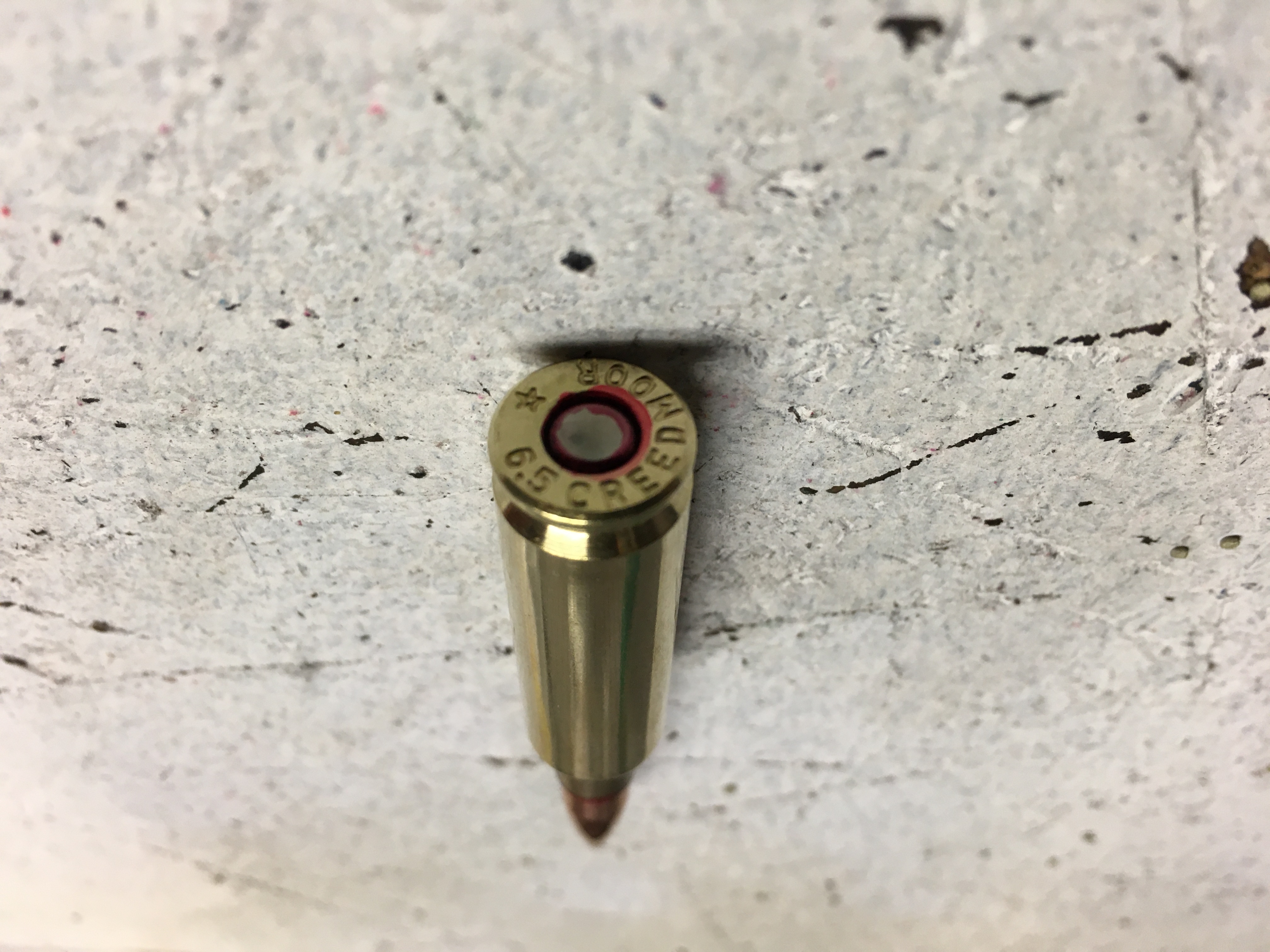

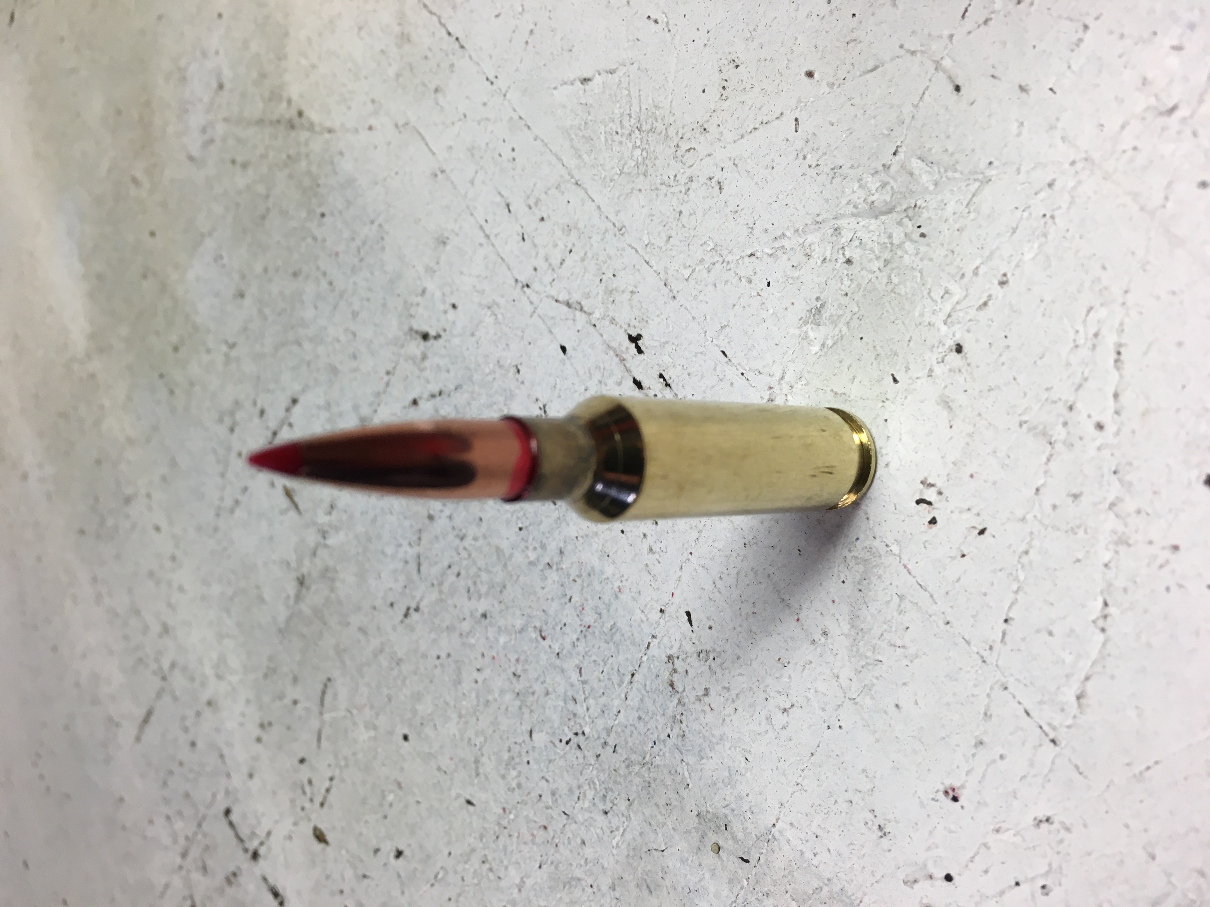

You have to thin the lacquer down a lot to get it to flow into the gaps. I cut the brush tip at an 80 deg angle (or replace it with 2mm whipper-sniper line when you destroy the brush) so that there is a very small contact surface with the round. When you get the very thin tip into the gap, the sealer just flows right in. It takes a few rounds to get the right amount of sealer on the brush, but too much sealer can be easily wiped off until you get the knack......
Once the thinners dry out, there is so little sealant left I doubt you will see any in or on the gun when cleaning it.
And the finished product....
