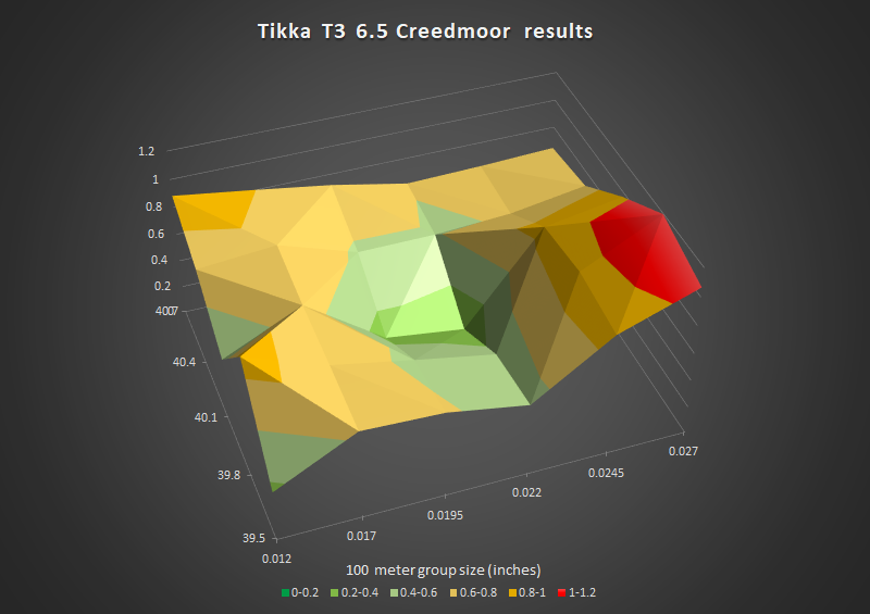

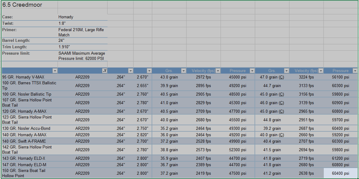

From ADI- all AR2209 loads for 6.5 Creedmoor.
I used 140grain ELDM Hornady's in mine, and loaded from 37-40.9 grains of AR2209 with no pressure signs.
I found a sweet spot 22 thou off the lands with 40.1 grains of 2209. It shoots less than 1/4 MOA with that.

Re original q:
260 Remington - similar to creed.
47.0gns of ar2209 push 95gn BT’s at 3400fps.
44.6gns of same powder for 120 nosler BT at 3050fps.
42gns of same push 140’s at 2870 fps - Hornady SST.
